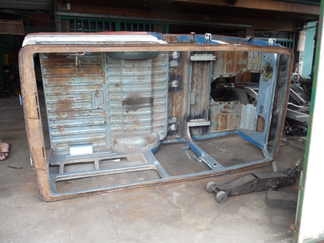

How to pull a body off the frame in Central America?
Don't you love the beautiful red/white two tone paint job I did? (I would have probably been hassled at Central American borders if I had not painted it).
The LV roof is made of several sections as can be clearly seen here on my roof now that it is off and clean of paint and bondo.
Paul also made up the support brackets for the rear floor step under the back seat.
