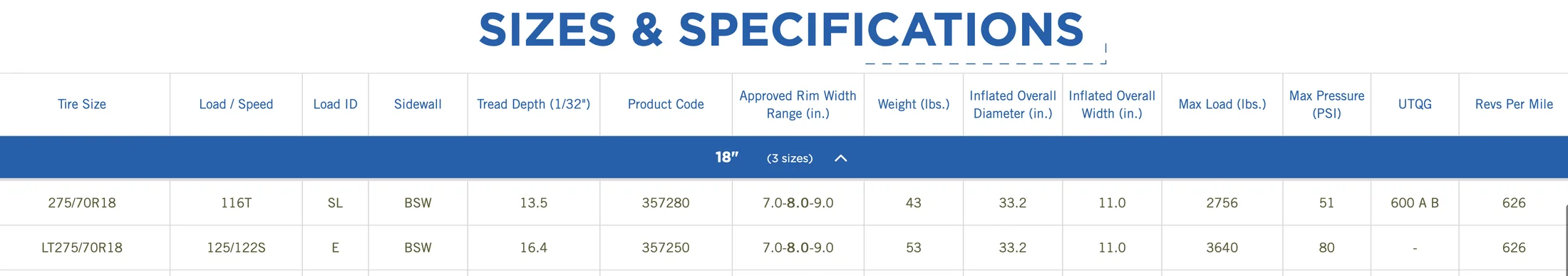

If the tire manufacturer recommends a 7"- 9" (listed as 7.0 - 8.0 - 9.0 on the website) wide wheel size for a specific tire in certain size, is a 9" wide wheel pushing it, and maxing out or stretching the tire? Or is a 9" wide wheel fine and safe?
That’s the safe approved rim width range. A 6.5 or 9.5 would likely still work okay but going an inch narrower or wider would be pushing it. Looking at that, the tire was measured using an 8” wide rim.
An example of this is older Landcruiser models running 5.5 split rims with a 235/85R16, technically the approved rim width range is 6 - 7.5 but they are often used on a 5.5 inch wide rim without issues.
