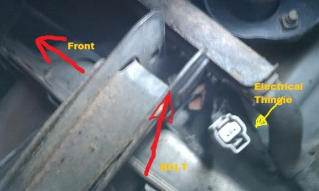

So I removed the running boards off my LX 470 and had no issue with it except for the passenger side front most L-Bracket. The bolt (in the picture) is seemingly impossible to reach.
Do I just remove the metal housing around those lines that are blocking it or what?
Also, how do I go about getting the track lighting connector out of the way? I was thinking about just electrical taping it and just leaving it there but I'm sure there is a more elegant solution.
I just bloodied up my knuckles.... I used a 3" extension and used my left hand to slightly move the metal out of the way.... But if you search the forum for running board removal I'm sure people have done it an easier and less bloody way. I just didn't have the patience to read all that info for one bolt.
I did what rking (minus the bloody knuckles)... just move/pushed the lines out of the way and turned the bolt about 1/16 a turn at a time... Fortunately none of the bolts were very tight.
I took off the little metal covering. It made it very easy. And added 3 minutes.
I did what they did. The lines moved enough for me to get to the bolt.
Success!...after a lot of swearing, but success all the same!

Holy crap! I just removed my running boards tonight on my 2003 LC, and am having the same issue on the darned front passenger bracket. The metal plate and bolts / clips holding the lines are rusted (thanks NE winters!) so I’m worried if I try to remove them they will snap (like a lot of the running board bolts did).
The LC bracket is slightly different than the LX one you have pictured. The bottom 12mm bolt is at an angle. I was able to move the lines and plate enough to get a 12mm socket the bolt plus universal joint plus 3 inch extension on there, but there is no way I can get enough force on there to get it to turn without the socket popping off. I guess I need to try moving the line further so that I can get the 3 inch extension on there without the universal joint. I will have to wait until tomorrow to try again.
