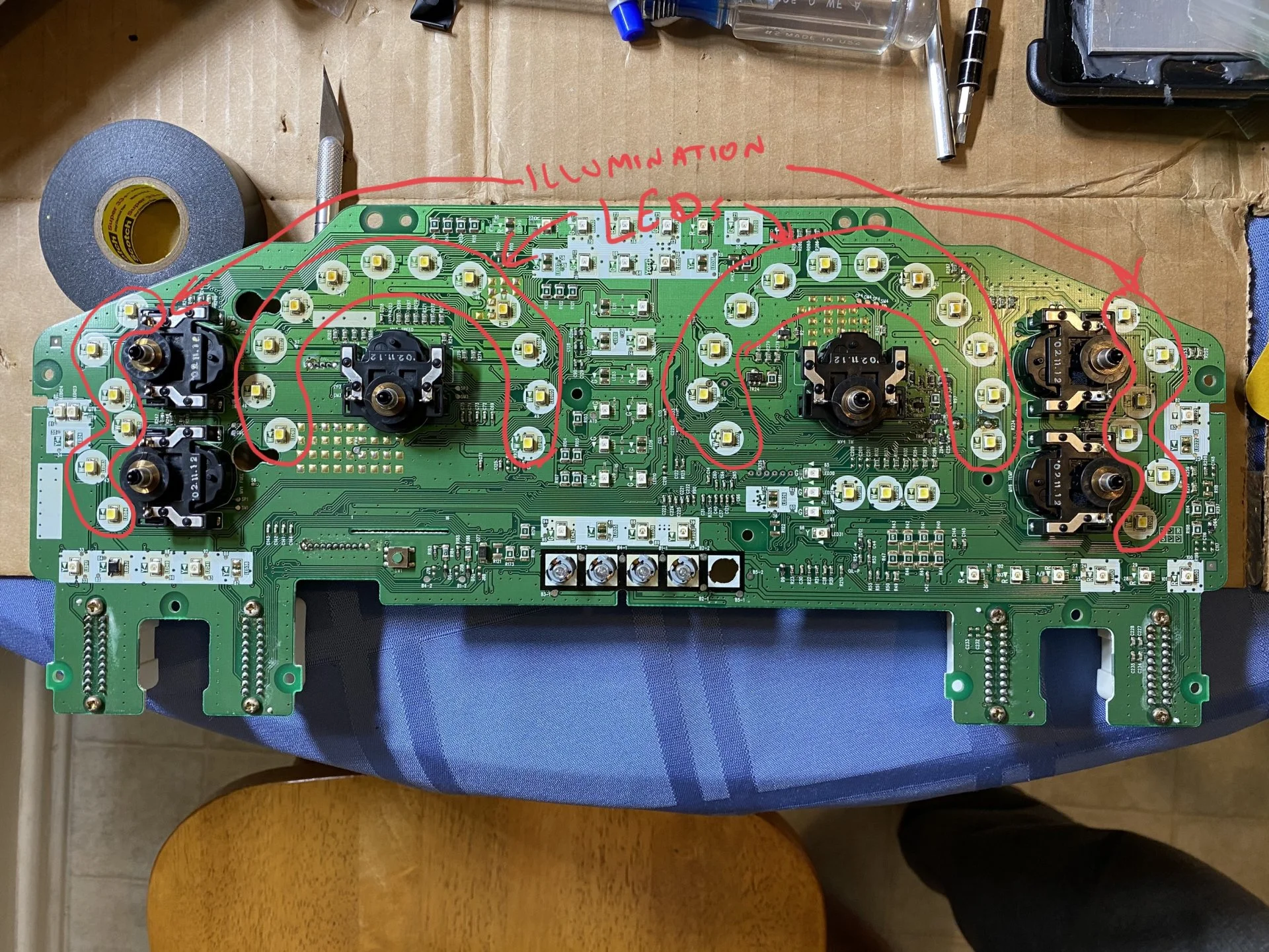

Looks like you have an LX. In that case the lights are led’s soldered to the circuit board. They can be removed and resoldered. There is a thread here somewhere with details.
I bought the leds to do it myself, but haven’t been brave enough to attempt it yet.

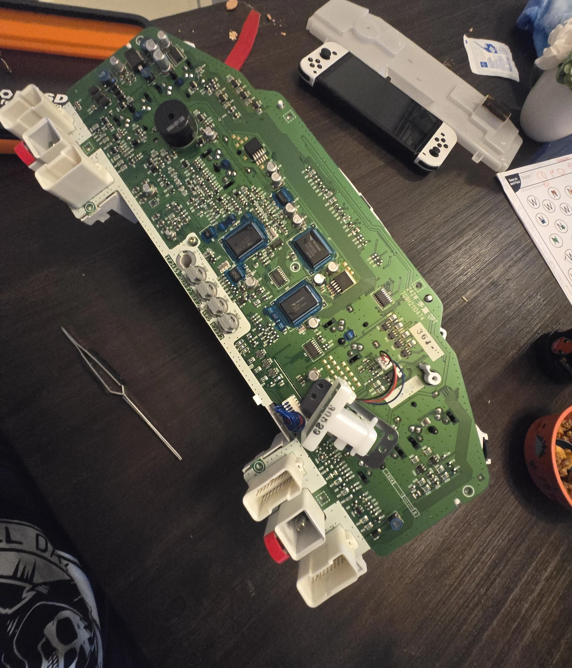

And also... once we get the screws off the circuit board, how do we remove it? I took the screws off, but it's still being held on by something. I noticed little black clips all over it. Many this has something top do with it?
Thanks!
Thanks!
You need to remove the needles to get them off. They are tight be careful, you have to pry them off, I tried pulling them but not able. Another cruiserhead advised me to use a fork to pry them off slowly, that did it for him without breaking them. I have not tried it yet.
NO, those are important bits of circuitry!
The leds are soldered on the front facing side of the board.
