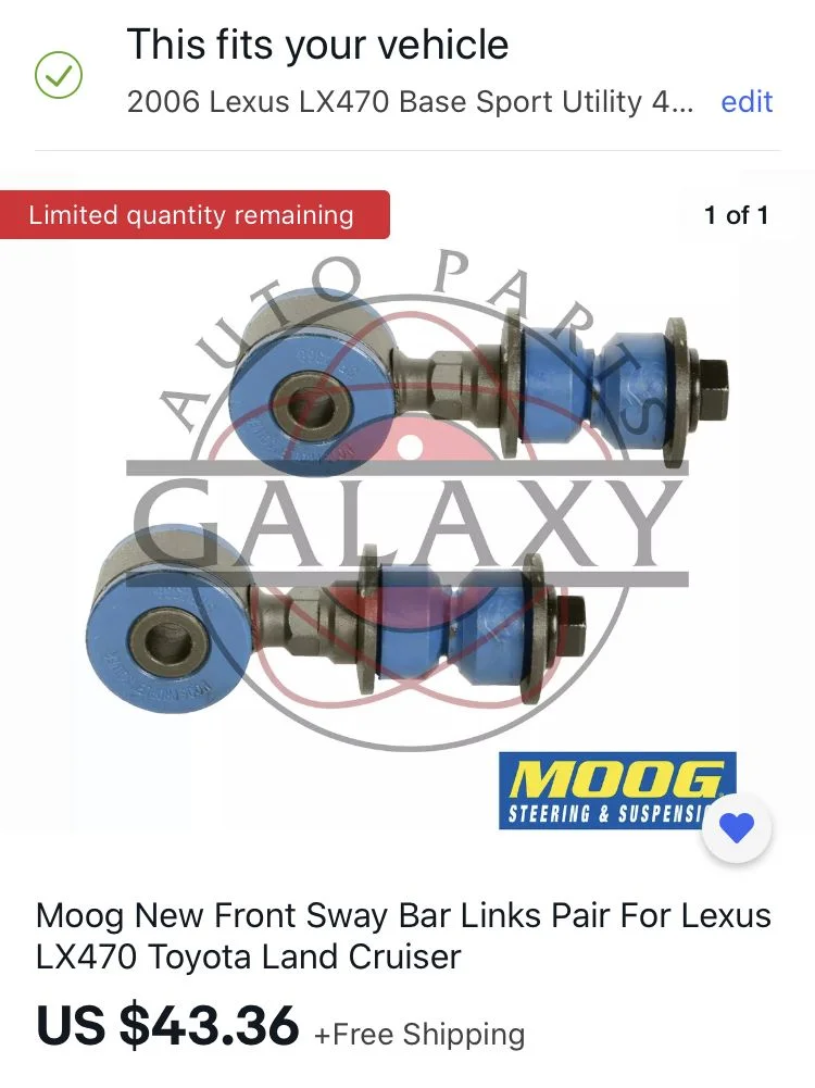

Thanks for the replies. I think imma just go with Moog then since I can get full completed links and bushings for a total of $48 including shipping on rockauto. I’ve found OEM parts but just bushings and cushions though for $68 including shipping on Toyota parts deals. I feel Moog is good for this part plus get a full link too.

Anyone tried this? Looking for feedback on polyurethane sway bar end links. Thanks ya’ll.
