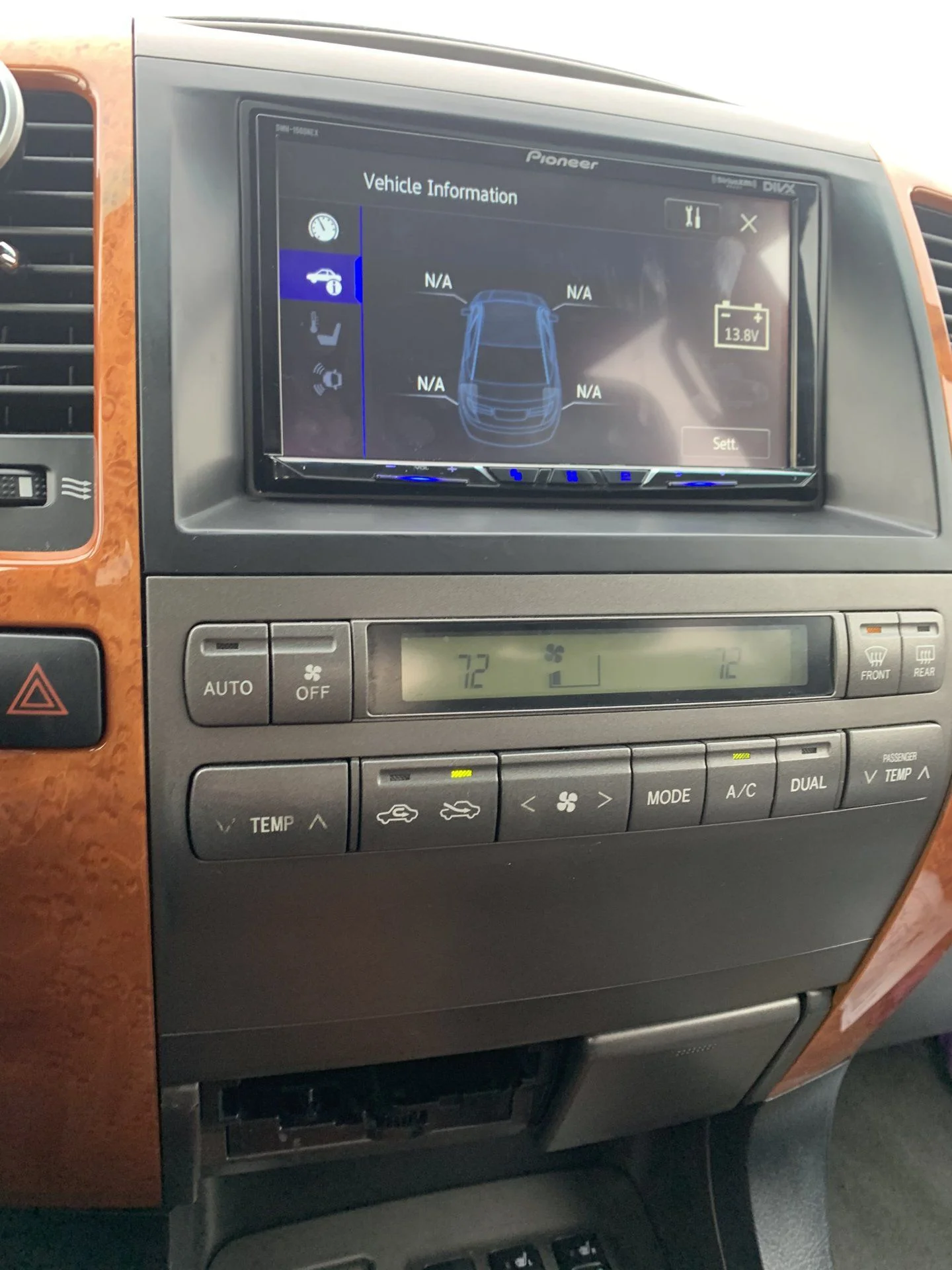

I found a real lack of info for a head unit upgrade as well. I wound up using Crutchfield’s recommendations for an ‘06 4Runner (I have an ‘06 GX) to retain steering controls and access a few more options. I installed it over the weekend and am happy so far. That said, I’m a. It overwhelmed with the pioneer interface, but I’ll mostly use it for CarPlay.
Parts:
- Pioneer 1500nex
- trim piece
- iDatalink Maestro RR
- iDatalink T01 harness
install can happen in under an hour.

your thread was actually the only decent source of info I could find and what lead me to try the 4Runner setup. Thanks for that. I had to trouble shoot some issues initially, but it’s been flawless since. I’m used to factory units that are better integrated, but the Pioneer is a huge upgrade from stock.
