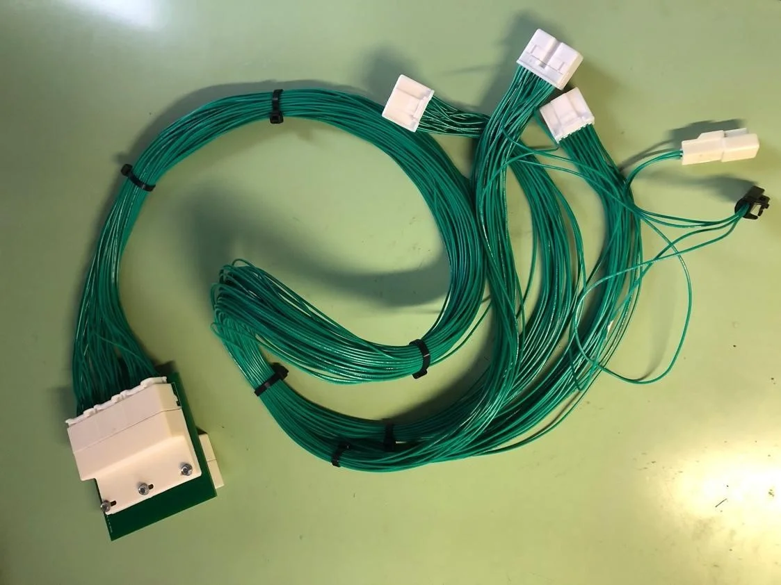

DIY Non-Nav Harness Extension
May 17, 2021
4
61
Knoxville, TN
This is also posted in the GXOR FB group. I'll link this over to the Non-Nav Conversion thread as well. Still trying to figure out how to link the circuit board files here, but they're available on the GXOR FB page under the files section.
Hopefully, this guide will help to create a simple and very reliable wiring extension that does not involve any cutting, soldering (save for the circuit board plug connections) or permanent modifications to your factory harness.

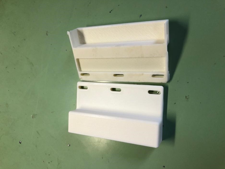

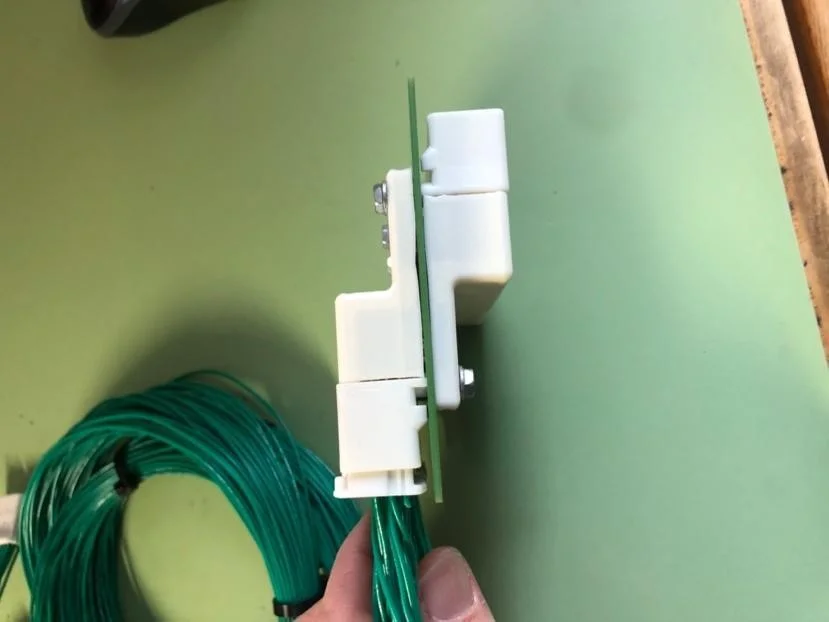

5. 3D Printed Electrical Covers
Slice and print two of the STL files in your favorite insulating material that can withstand your under-dash environment. Remember that your heater blows in this area and it may get quite warm. If you don’t have a printer don’t worry! I am sure you have a friend with one, or choose some other insulation method!
The finished product should be two covers that look like the image below
6. Wiring Harness Instructions
Cut 80 wires into 4-foot lengths (can shorten if you want from the other writeups, but I wanted to ensure the wires would reach and allow plenty of room​
Strip Both ends of the wires back ¼”​
Crimp on connectors to both ends of wire, according to the table.​
KEEP THE SIGNAL WIRES SEPARATED AND IDENTIFIED. They look nearly identical but do not go into the connectors the same. Trying to insert the wrong signal ferrule into the wrong connector will be a problem. You can insert it with force but it won’t make a connection.
When crimping on the ferrules- one pair of tabs holds the insulation, and one pair is for the conductor. You may have to trim the conductor to get it to fit. The crimper should do a nice job of rolling the wings into the center of the wire strands. Check for strength of connection on each. (Give it a light pull to make sure it does not slide off).
I recommend doing the first few and putting them in the connector to make sure that your technique is correct. They should slide in, click, and not be able to pull out. (!WARNING! I haven’t found a tool or method to remove the wires that does not involve the destruction of the plastic connector. Make sure you’ve got the right connector! )

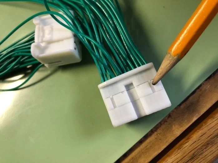

6.1 Insert the wires into the connector pairs
It is imperative that the wires go from and to the same location in the connector pairs. It’s an extender so it's not complicated, but it is tedious. I like to do this by holding the pair side-by-side and doing one wire at a time. L-R, Top-bottom.
Before inserting any wires into the connector, the “keeper” must be raised up to allow insertion. Raise the “keeper” by lifting up through the openings in the side of the connector. The keeper is typically raised on new plugs.
Check connector and ferrule are correct (see table)
Push the assembled wire in until it clicks.
Pull gently to make sure it is captive.
Repeat with the other end of the wire assembly.
Proceed one at a time to avoid miswiring
Once completed, push the “keeper” back into position to secure all the terminations

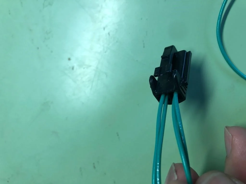

6.2 Cigarette adapter wiring
The illumination comes from the power-ground pair supplying the cigarette lighter bulb. We simply splice in the two wire connectors here to avoid cutting the factory harness.
  1. Cut the two wires (I know you just made them) approximately 18” back from the connectors you plan to use in the center dash. Keep the 18” end and remove the long end (the ends that will come from the kick panel)
  2. Cut and strip two 8” wires. We are going to splice the wires together within the crimp ferrule (to avoid soldering). Join the ends of one of the 8” pieces with one of the 18” wires and crimp them into one of the 71144020 ferrules. Repeat for the other 8” and 18” wire pair.
  3. Crimp 71164020 onto the remaining end of the 8” wire

8. Assembly
Connect the 3 wiring assemblies to the circuit board. They should slide in nicely but require some force. Make sure the keeper is fully pushed in if they are difficult to insert.
Secure the covers on with the 6 screws. The covers are arranged as shown below. The screws should engage through the circuit board to the far side 80 pin connector.

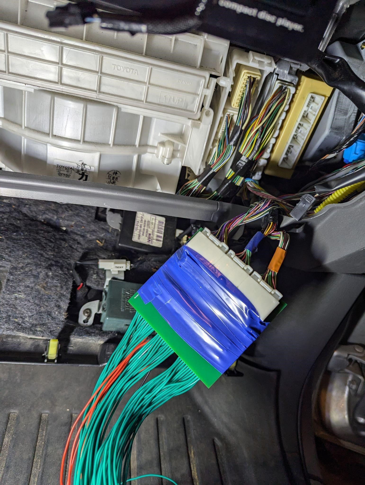

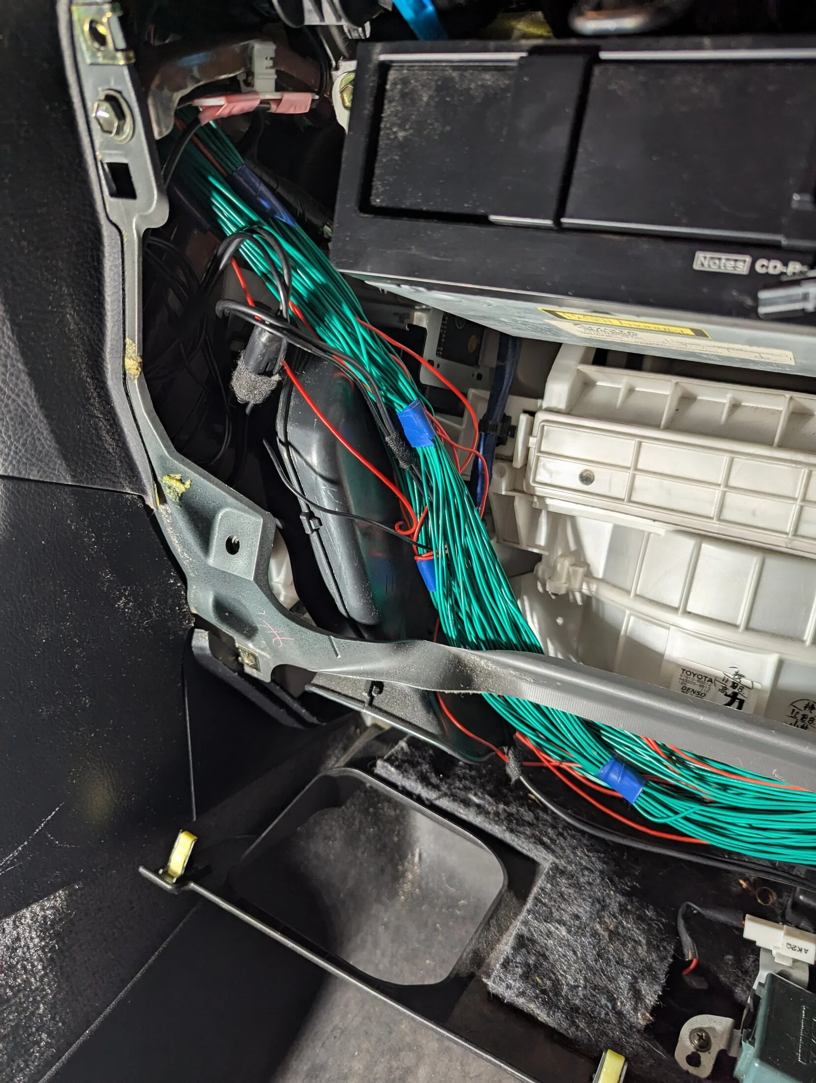

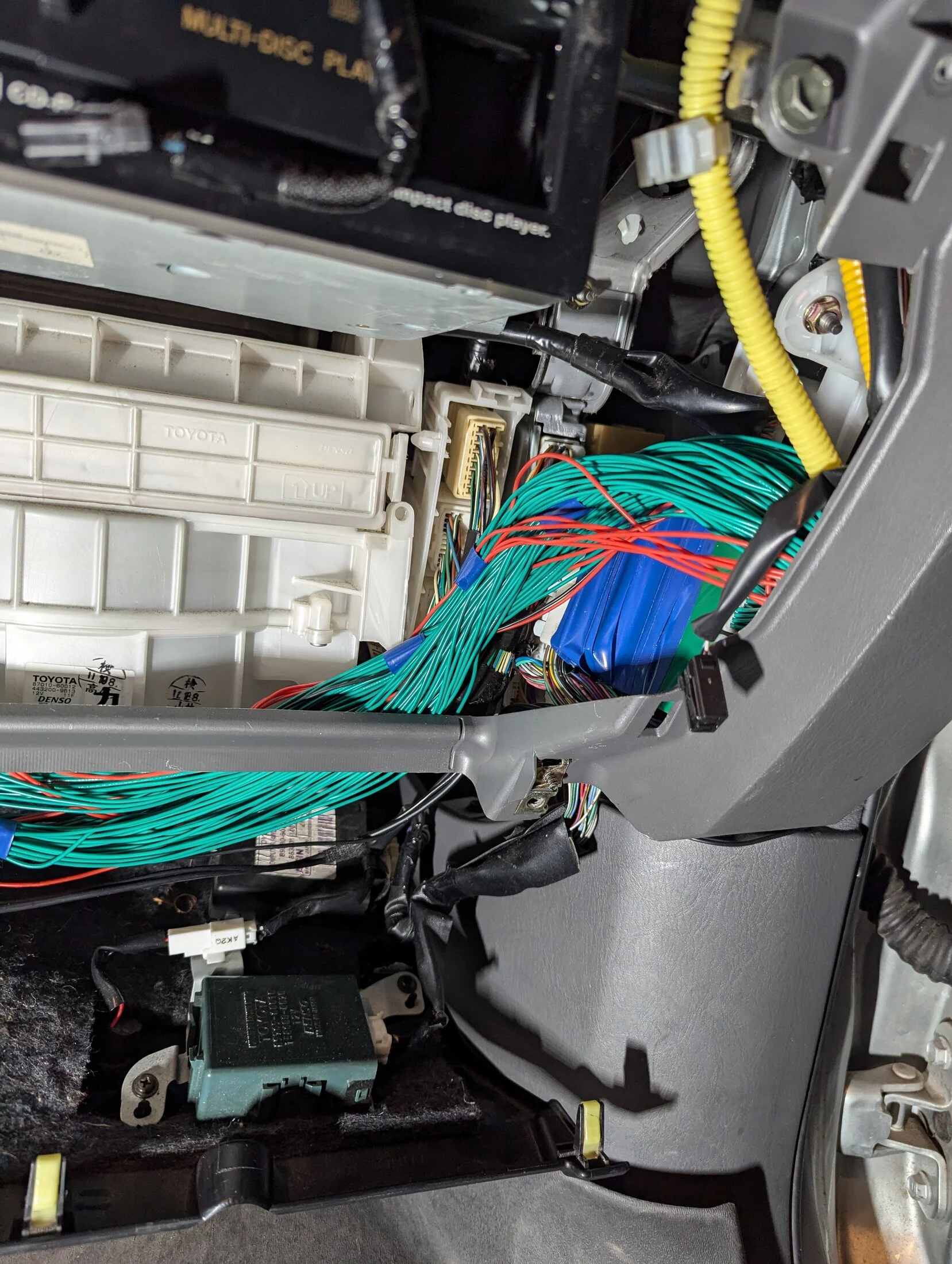

To install the Harness Extension, begin by plugging into the mustard box and routing the 3 separate wire looms below the AC blower fan in the lower dash panel and then route up to the center to plug into the non-nav HVAC Control Unit. I fed them thru one at a time and wrapped it with electrical tape to make it easier to feed thru the structural brackets. I coiled the extra wire length and used it to help pad the circuit board until I was able to source the 3d printed circuit board enclosure.
Finished install prior to radio install
