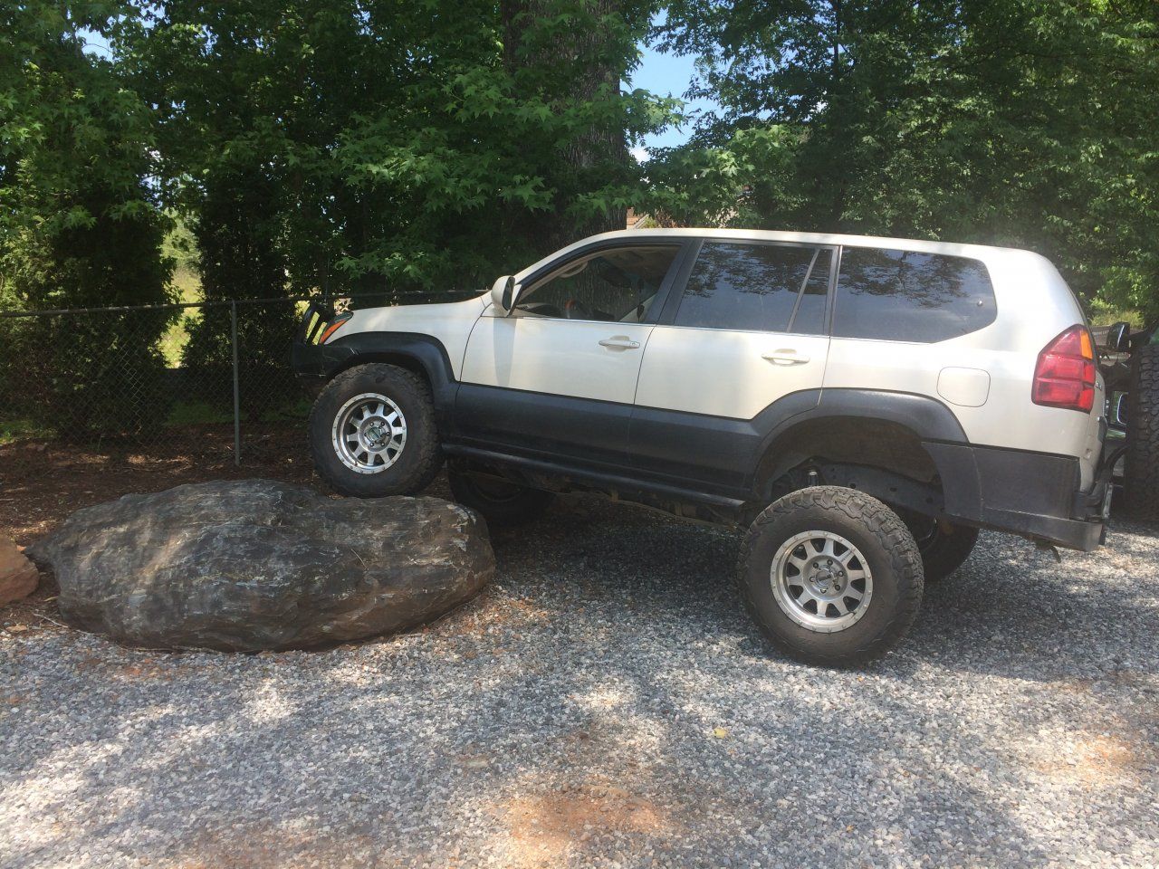

Nice! How much additional travel do you get with the long travel setup? I've hung a rear wheel in the air -- curious how much improvement I could get.
It is drastic. Not even at full flex and all 4 still on ground
The added flex should be very good, I think I read that it was about 15" of added flex.

15" added? holy crap.
I was going with 2.5" as well. I called Radflo and had a good chat with someone (I want to say Mark, but I'm not sure). He said the 2.0's could work for me, but I'd be rebuilding them more frequently. The 75k service interval of the 2.5's sounded good to me.

I was off on what I said, but you can see that Dan is going some good travel.
this is from Metal Tech
This shock will allow for a full 11.5" of shock travel which translates into 27.5" of wheel travel (compared to a OME 2" lift that has 20" of wheel travel)

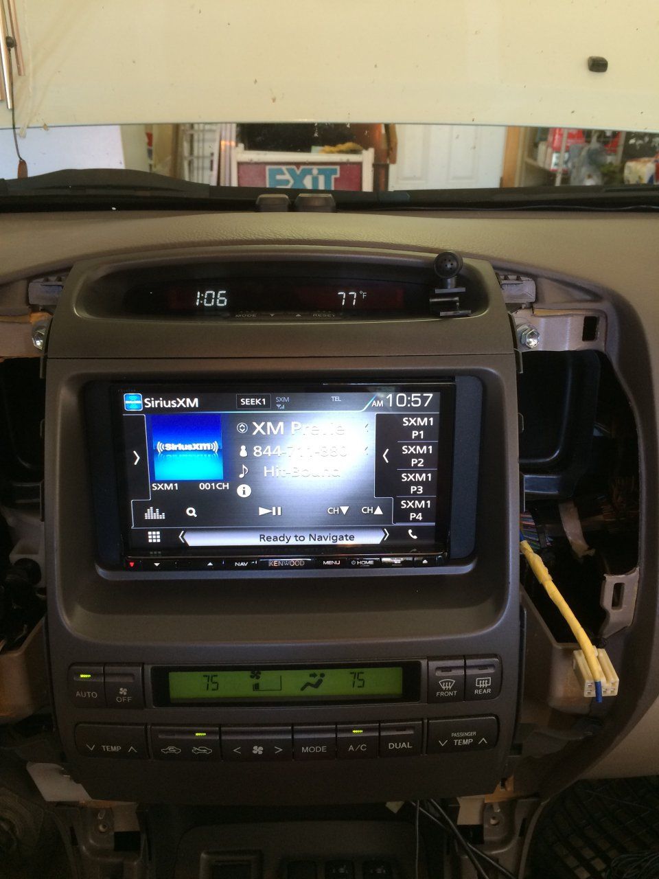

finally got my new head unit with GPS (Garmin), bluetooth, Sirius.
while I was in there, I hooked up the lighter to always powered and ran a hot wire to the rear of the center console and iPod hook up into the center console.

What trim panel did you use for that? I checked Crutchfield and they say that custom fitting is required.

Can you tell me more about that. Where you got it, what it requires as far as adapters? Is it using factory amps? I am not a stereo noob but I know little about higher end systems with factory amps.
I used BeatSonic trim piece, had it paint in a PHX shop for $45 and BearSonic wiring harness for the stereo and a box that tricks the amp. The wiring was straight forward, just like any other car. The black trim piece around the radio came with the Kenwood and I had to cut a lot to get it to fit. Something I did to get the stereo to fit farther back into the opening was drill new holes about 3/8" from the original holes in the two Lexus side mounting brackets. I wish I could of place the stereo a little further into the dash, but the room back there because very tight. I have more glare than I would like, so that is something to work on, maybe an anti-glare sheet. I emailed Kenwood about it today. With this system, you only hook up the front speakers and the amp feeds to all speakers, so there is no fade control, but I think it sound very good.

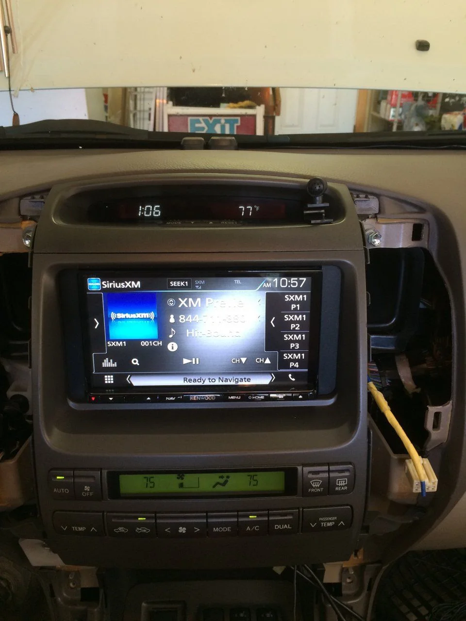

Something else I did that I was told not to do, but found where others have done it and so far it is working great, I mounted the GPS and Siruis antennas right next to each other at the middle front of the dash.

I'm interested in the anti glare too, in the daylight the screen is 98% washed out by ambient light in the truck
