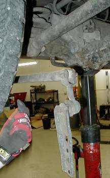

This it's the old model sway bar rear braket .. I found it very very noisy at the end of it's life ..
Discovered my PS rear swaybar link had lost the lower bolt on one of my first wheeling trips. On its way out, the bolt had wallowed the hole in the bracket and buggered the first couple of threads. So even with a new locktited bolt in there, it'll make noise when I hit a speedbump or the like.
I minor annoyance at best. Someday I'll replace the bracket (or lose the swaybar altogether).
