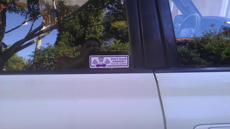

Metric TLC stickers
saw these one night on their website and grabbed a few neat things. Had a few moments today so put on the stickers. Thanks Shane!
