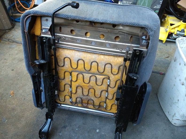

I thought it might be possible to swap the seat bottoms. Most passenger seats I see are comparatively pristine. Short version: nope, you can't.

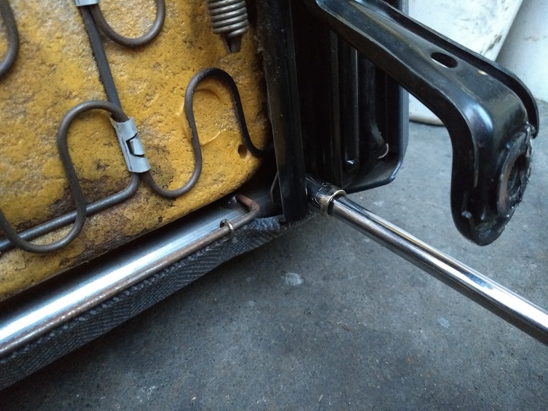

It sure looks tempting, though. There are four bolts holding the sliders on:

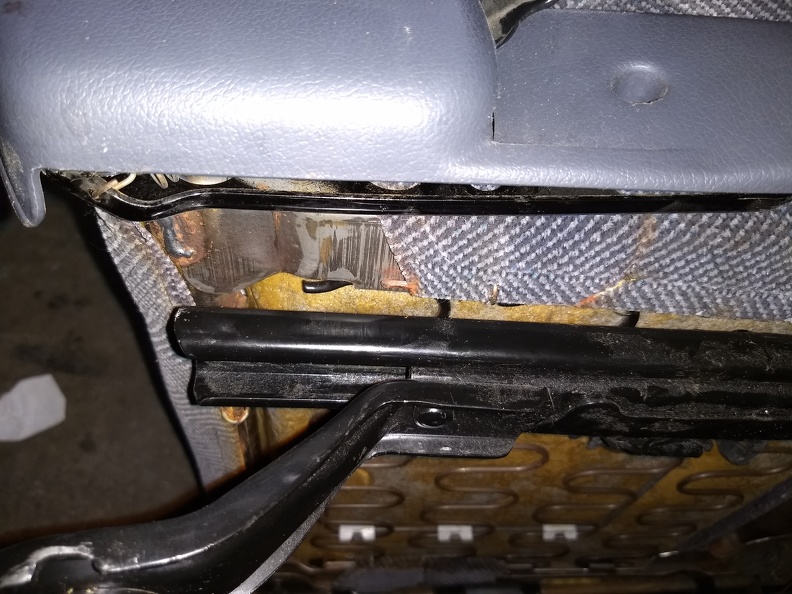

You have to keep the sliders in their original positions, since they're asymmetric. The swapped seat bottoms seem to bolt right up at first, until you realize that there are only three threaded holes under the seat bottom. The fourth slider bolt actually attaches to the side bracket, which bolts into the side of the seat bottom using a partially concealed bolt. Oops.
If you wanted to put in the effort, you could probably make something work. Fabricate a bracket extension. But I wouldn't vouch for its safety. Besides, it turns out that the sides of the seats are shaped differently. Get the seat into place and the seat bottom interferes with the center console. In retrospect, this is painfully obvious from the first picture. Look at how far out the metal "hoop" goes on one side, compared to how the side of the seat cuts in closely on the other side.

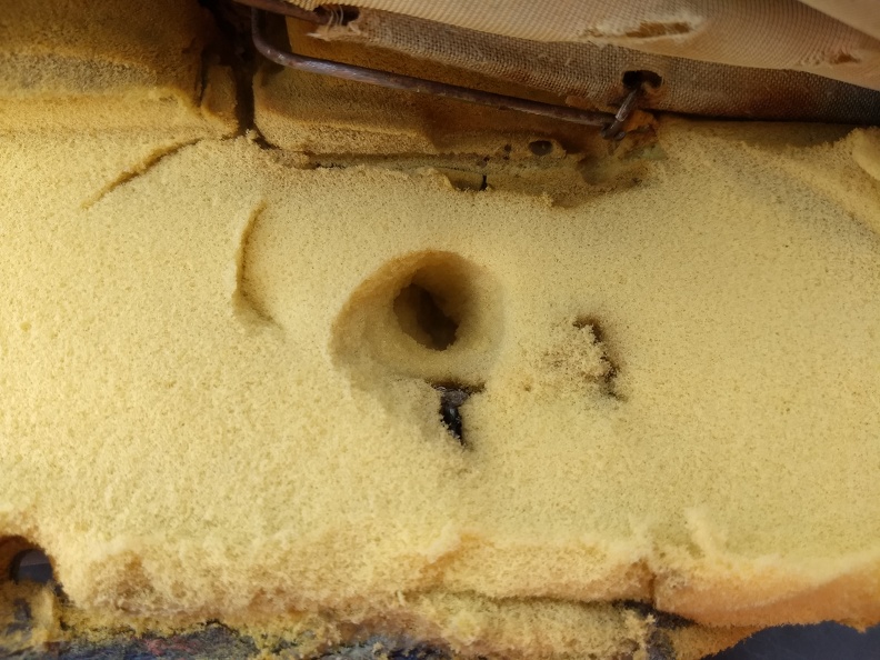

I have no idea what made this hole:
The only foam I could find is the carpet underlayment I've been using to insulate the floors. I cut out several shaped strips, ground off the water resistant backing, and started laminating the layers on using Super 90 spray adhesive. I think it ended up being three layers on the top, a chunk filling in that missing section, plus one along the side. I feathered the edges of each layer, particularly on the inner side.

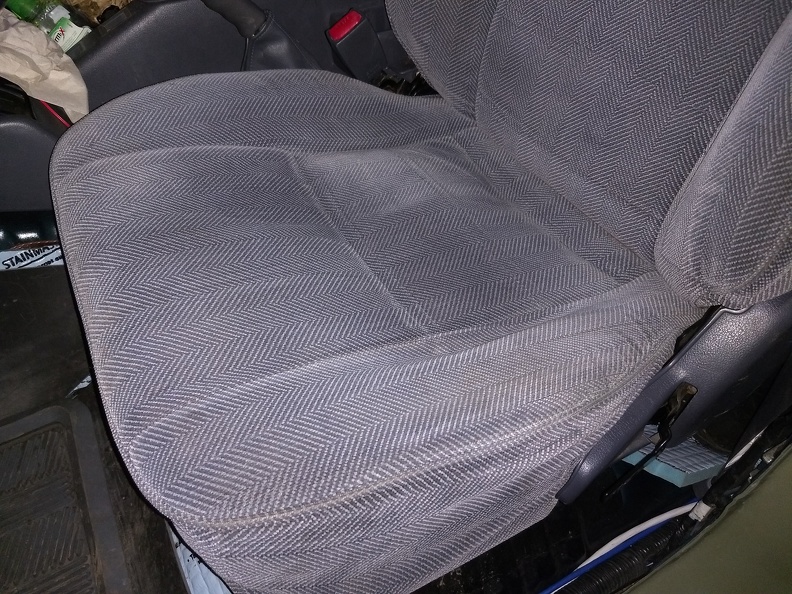

Rounding it all off with the flap disc and it was hugely improved:
It's definitely not perfect, but wow is it ever an improvement. I can drive without a weird lean, and my back (and butt) feel better already:

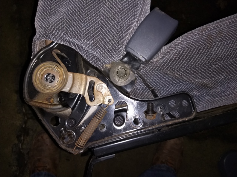

Here's how the side plates attach to the driver's seat:
You can just see the 'hidden' bolt that goes through the side of the seat, connecting the rail to the seat.
So, if the holes on your leather seat bottom look similar, then it's worth a try. I've read that the leather seats sit higher, but I don't know if that means there would be interference with the seat back.
