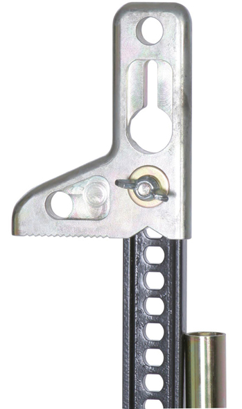

hi lift as a winch: YouTube - Hi-Lift as a Winch
chains to drop into the slot on my hi-lift extreme will make it easier,
as will a longer length, so you spend less time re-rigging and more on plain cranking
Thanks man, I'll check that out when I get home and can watch it. So it looks like I can grab some other recovery gear (srtraps/chains n stuff) and use it as a winch..! :) Aswll as use it to chock stuff under the wheels for traction I guess?
