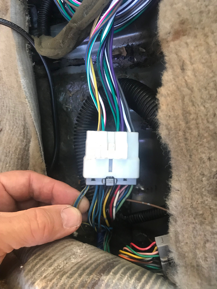

:idea: The A connector, pin 7 and 16 are supposed to be tied to a 20A fused always on source... Neither connection will jump the required gap...
I've said this from the beginning. The POS plug and play cable is not plug and play. The two wires I'm holding are supposed to be the 20A fused power supply connection for the amp.
The amp came with both plugs (wires cut off). If I understand what I'm seeing, "all I need to do" is jump two wires from the spare connector to the two wires that I'm holding and plug the spare connector into the amp. It would be even better if I could just pull them out and move them to the spare connector. So far I'm not having much luck with removing them

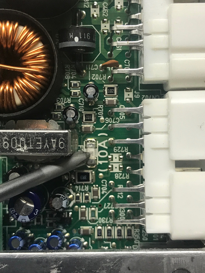

You were almost correct Trunk Monkey. I very slowly and methodically traced all of the wiring after lunch. I ultimately came to the conclusion that there was something wrong inside the amp. Everything was as it should be, except the always on power side.
Winner, winner, chicken dinner.
Look at what the tip of the screwdriver is pointed at. That is a 10A surface mount fuse. Less than 50 cents. Way cheaper than that in bulk. The amp came with a blown fuse. How did it get blown? My suspicion is that when they cut it out of the car, literally... they just whacked the wires off of the connectors, they cut the small (B) connector side first. and in the process of cutting the wires they got the hot and ground in one cut. The A connector always hot feeds the B side through the fuse.
To test my theory is just jumped across the fuse... :cautious:
:eek::eek::eek: NO NO NO NO NO... NOT NO BUT HELL NO... NEVER JUMP A FUSE... EVER

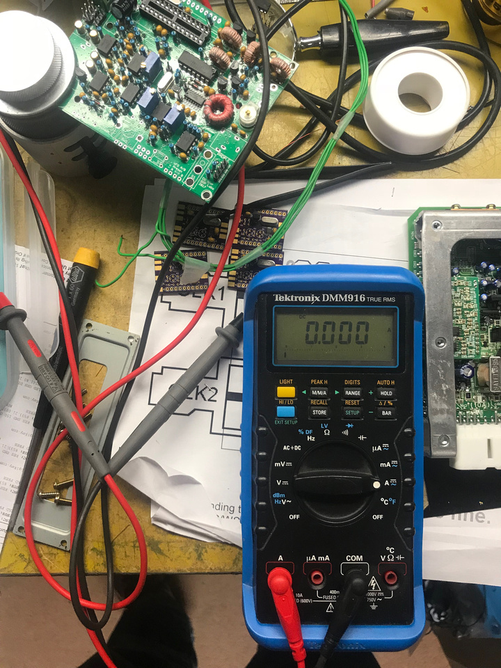

So how did I test it. I used my ohm meter first and there was no continuity. Then, to see if that's all that was keeping the radio from turning on, I put my meter in current mode (Amps not Milliamps), swapped the plus lead over to the Amp connector, put the + lead on the supply side of the fuse and the negative lead on the "downstream" or radio side of the fuse and bingo... all was well.
Meter setup looks like this (excuse the messy bench, things to do there). When it was inline with the blown fuse the meter read about 500mA (1/2 A) which is within reason:
So I can just solder a jumper wire in there and call it good :cautious: Uh... no... I have some fuses ordered.
