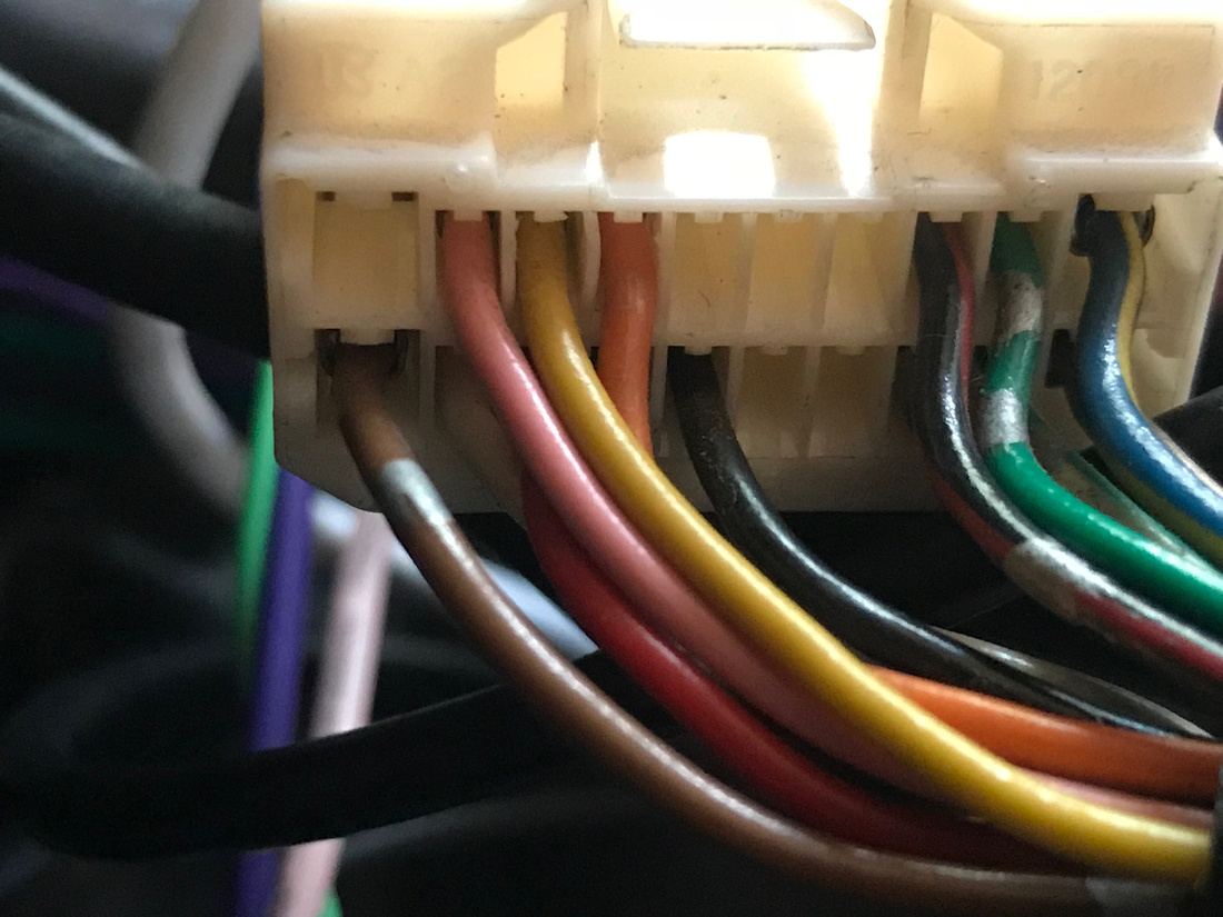

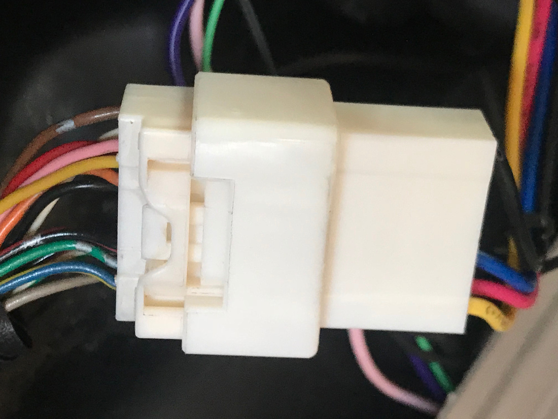

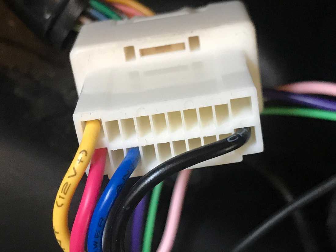

The following are of the Toyota and Crutchfield harness connectors
Factory on the left. Crutchfield on the right
Crutchfield connector rear
Factory Connector Obviously the wiring is reversed from what it looks like plugged in. The connectors aren't the problem. The problem is the lack of power on Blue/Yellow and Gray wire.
It's confusing if you name the connector numbers with respect to pin numbers. I would start with R1 radio plug and check power on pin #3 and 4, that's just how I would go about it. Don't know what add on harness your using, metra 71xx something?
I think it's a Metra harness. It's one that they charge for. I checked for voltage and it's not there. But the fuses are good, unless I'm missing a fuse location.
I assumed it was, I have the same one it looks like. I'm taking the acc and B+ only off that plug. Yours is a different year. But I didn't have a power problem. I can only suggest working from the vehicle side of the R1 plug backwards to the battery to see why there isn't power. The antenna relay unplugged and the amp S6&7 plugs don't make a difference as far as power goes.

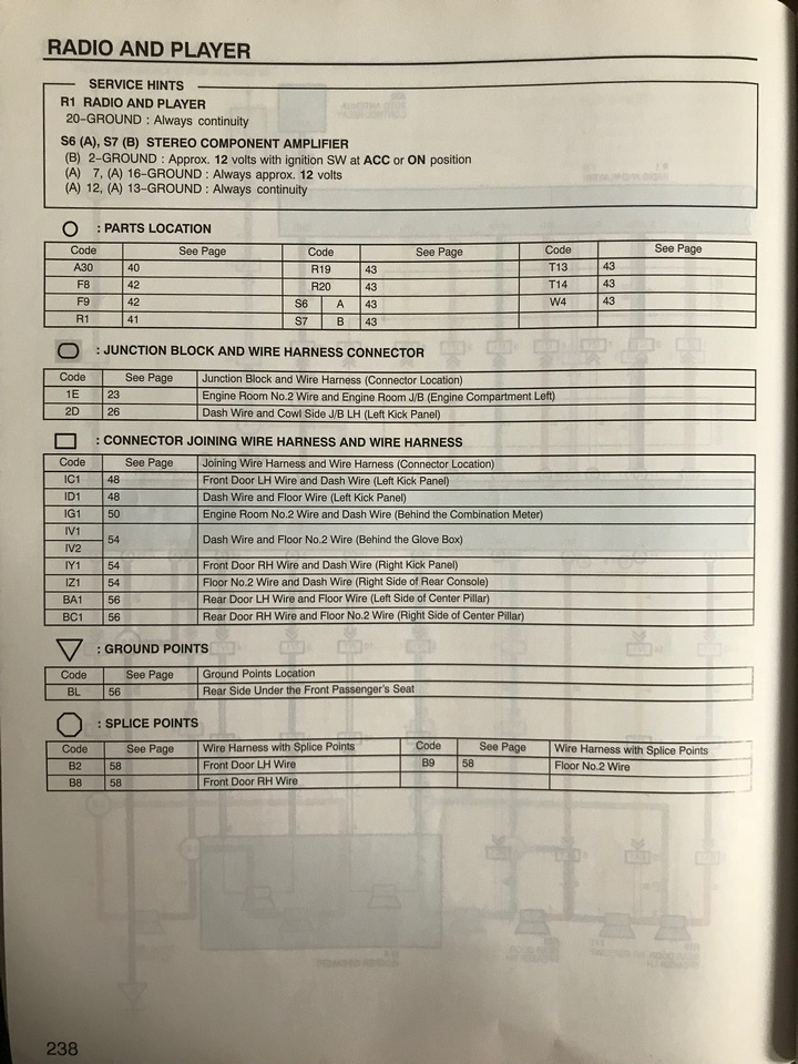

My year differs in the power config. I'd check pin 7 &16 on the S6A plug for bat+ power and the S7B pin 2 for ACC, which looks like you have. Is there no amp fuse? 30 amp? Was your radio working before you took the stock on out?

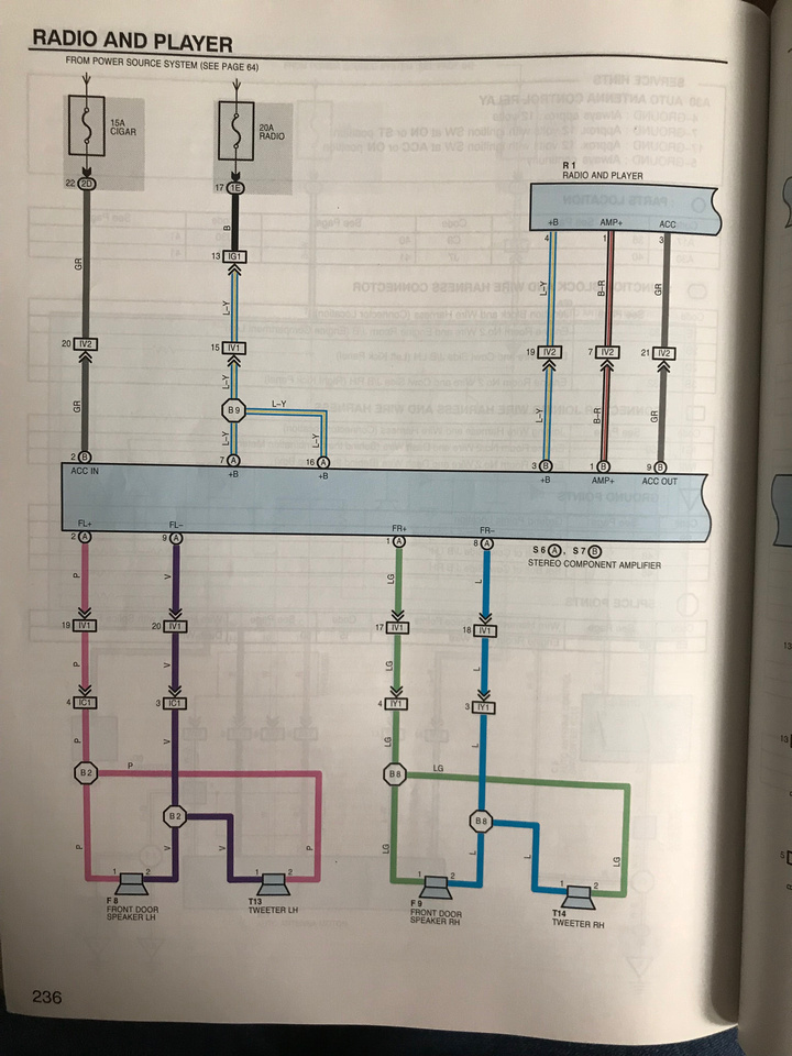

Looks like acc and b+ come from the amp on your year.
Toyota's wiring is so ghetto in this instance. Are you using the stock amp or or what? what year is your LC?

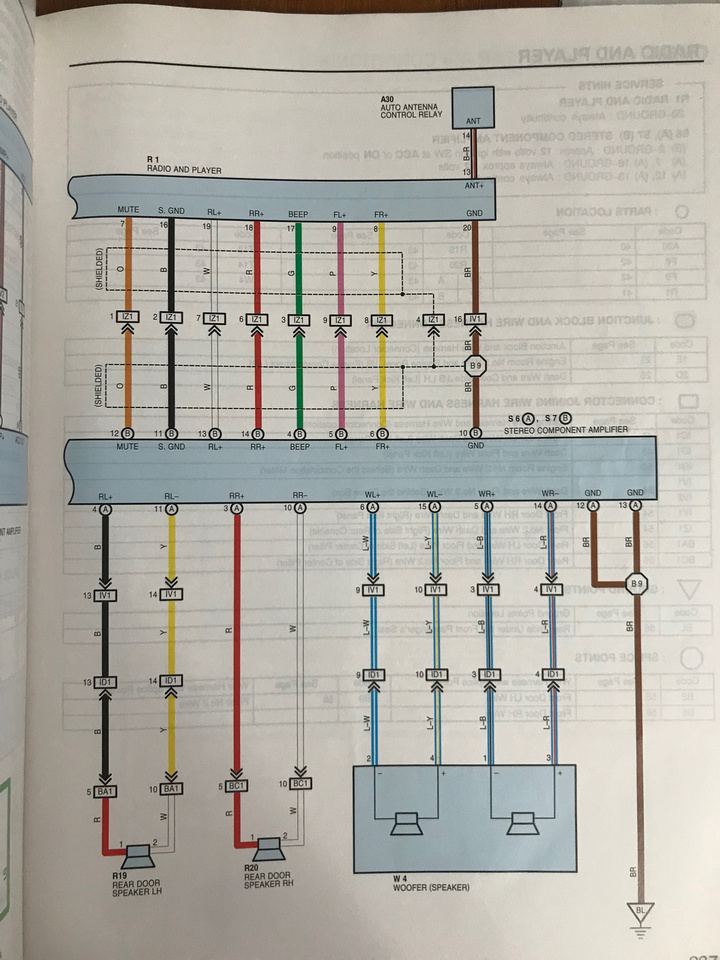

I'm not clearly following the problem, but suggest you look at the three wires coming from the amp in the first wiring page you posted. The amp sends power to the headunit. If you also put in an amp you will have to jump the amp's power back to the headunit or wire in an independent fashion.

I used the amp "bypass" harness. The amp supplies power to the head unit (stock and aftermarket in this case). The harness doesn't bypass the amp. It bypasses the amp output and lets the head unit send audio to the speakers. The amp on my LC does a lot of other things. Like power the power the radio, raise and lower the antenna... things that the harness doesn't do. So it's not an amp bypass harness. It's a mile long wad of wires that pisses me off right now...
I did an amp bypass and change out a few months back. You are saying there is no power at the connector in the dash? I would check under the seat and start with A16- A7 and B2 at the amp which show to be S6 and S7.

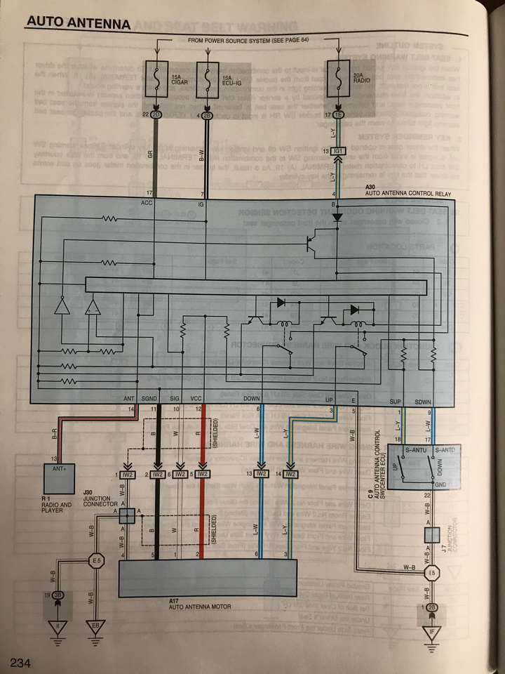

If I'm looking at the block diagram right the amp has something to do with powering the antenna up and down?

I completely removed my old factory amp and sold it on Ebay. I used the same Metra amp bypass. I am going through some old photos now to see what I can come up with. The only thing I remember was I had to ground the head or it wouldn't work. I am looking at your FSM. What year is your vehicle? Is the FSM for that year? It looks like what you are showing there will not work with the Metra Bypass. The amp has two harnesses. One is labeled A or S6 in the FSM the other is B or S7 in the FSM. IIRC the "A" harness is the speaker wires mostly but also feeds power. All of those wires on that Metra harness go from the stereo outputs to the harness which clips into the disconnected harness in the amp area that feeds the speakers. This will not work.
All of those wires on the harness in my hand go up to the head unit but only the speaker outputs. If that is the case this harness "A" can never provide the power on A16 and A7 because it is disconnected. So if you pulled your old amp you just have the "B" harness sitting there. Looking at your FSM that will never work. The amp provided a jumper between B2 and B9 for ACC power and A7 and A16 to B3. If you look at the FSM you will see that is where you get your power on the Blue/Yellow and the Gray wire. Pull the seat and grab the "A" plug that goes into the amp. This would have been the plug you attached to the new Metra harness. This is connector S6. The index in the back shows the terminals. Terminals 7 and 16 should both show 12VDC to ground. If you have power there check the "B" plug S7. Check terminal 2 for 12VDC to ground. If you have power at all 3 spots you are good. You will just have to jump some wires and add a ground because the head unit was ground through the amp via terminal B10.
The jumps look to be B2 to B9. Wire colors should match and A7-A16 to B3. Toyota likes a double power loop on these vehicles for some reason.

Sounds like a plan. And if you look on the schematic you would have unplugged harness "B" from the amp. That is the smaller harness and that would be your power from the cigar fuse and your ground.

Not that it matters at this point but it eventually will. What tells the antenna to go up and down? I see a Blue - Power Antenna wire in the Metra Harness but nothing about what it's supposed to connect to.
No amp = No antenna movement. I know that to be true
the ACC should be on plug B2. It comes from the Cigar which according to my FSM is switched with the key. 12V constant goes to small harness 12V switched goes to big harness.
