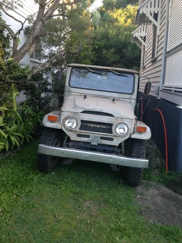

No more living vicariously, I got one!
This is making me nervous, I am starting to get that " go in search of the FJ45" feeling again.
Keep the information going.
Sweet!
My parts acquisition has begun!
I told myself to be patient and save money for the things that need to be done ( ie brakes, tyres, things to make it legal), and not necessarily the things that I want, or think I need.
But then this cropped up, and I think original is better than repro. The bonnet latches were cheap and in the next suburb.
Its not much, but you have to start somewhere.

I had the truck delivered to my house over the weekend and the fun began.
After a couple of hours of working on the street, I finally got the truck started and backed into my driveway. First thing to go was the aluminium bullbar and spotlight. The stock bar isn't perfect and the silver paint went on when it was a bit humid, but it wouldn't look right if it was perfect.

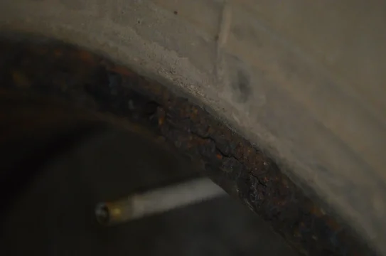

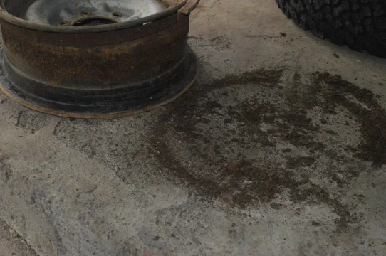

Pulled the spare tyre out from underneath and decided to pull it apart.
When that much rust falls out by itself, things aren't off to a good start. Most of that came off the rust band, so I guess it did its job.
And when there's chunks stuck to the tyre, you know the wheel isn't going to be in the best shape. The split bead reduces down to half its thickness near the edge ( the part that goes onto the tyre bead) and with out cleaning the rust flakes off I've already found a hole, so I think this one is toast.
