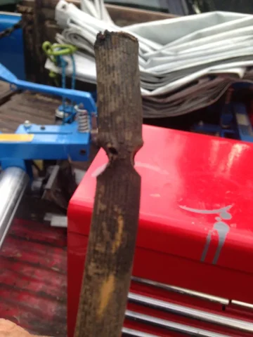

So I got everything back together and replaced the rubber hose from the chassis to the diff. I wasn't sure about replacing it, but glad I did, no idea how long the clamp had been on it?
The truck came with two hard lines that mount to the diff, one was obviously newer than the other so I put it on and we bled the brakes, only to find that the newer looking one had a block somewhere inside and fluid wasn't flowing from one side to the other. So on went the old one.
About this time my assistant pointed out the lack of cup holders.
Then we discovered we'd sucked air into the system and we had to start again, and we'd run out of fluid by effectively flushing out the system. What came out was fairly disgusting though so happy to have flushed it all.
So when we had more fluid we started again and had the system to what I thought was bled, only to find that the brakes need a couple of pumps to work, discovered as I moved it back to my front yard. I think I might need to go over it all again, and/or bleed the booster that's been fitted. Might have another look at the manual to make sure I'm following the correct procedure.

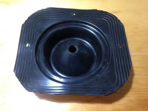

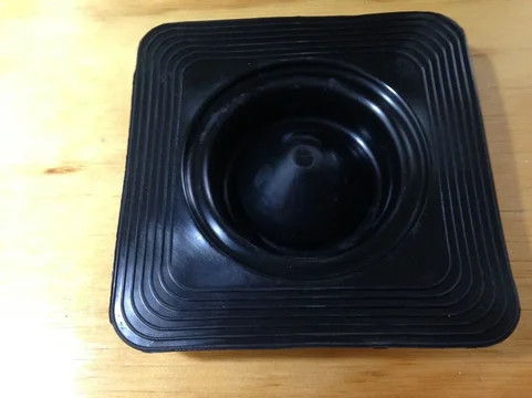

Take 1 plumbing pipe collar,
Trim it to the right shape add a couple of holes,

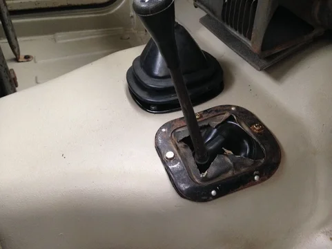

And we have a transfer case rubber boot.
Now I just need to replace the vinyl, but this at least should stop some of the heat and noise coming in. No idea how well it will cope with the heat, but for $10 and 15 minutes work, I'm happy for now.

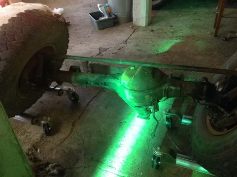

So after a 1000 Km road trip last weekend and seeing some of the appalling and unsafe driving people are capable of, I decided that I wasn't really comfortable with the idea of the drum brakes on a truck I want to go exploring in. So I picked up a disc brake front diff over the weekend from a BJ42, just missing the free wheeling hubs. Drove an hour from home with @84TROOPY 's trailer to pick it up. Big thanks Peter and I owe you some beer for not cleaning that spilt oil. I feel bad about that, sorry.
Need to start researching what I'm going to do, re: ratios, axle types, spline count, etc, as I'm a bit uncertain on what the best way forward is and when things changed in production. Either way, it will get stripped down, cleaned and a kit put through it.

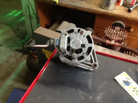

Also down the list is upgrading the alternator. The guy I got the diff from gave me an alternator from a Ford XF Falcon. Its a bosch unit that has an internal regulator and is rated at 80 amps. I think. I need to look into this further, but hopefully it will work out. He had it running on his truck and told me how to wire it up, but I wasn't paying close enough attention.

I've also made a start on stripping down the disc axle I have. Hard brake lines and calliper's all came off easily and will get rebuilt at some point. Just need to confirm diff ratios.
