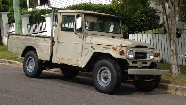

No more living vicariously, I got one!
great work. what paint did you use?
Thanks, I used tintable Raptor liner and got a pot of Dune Beige 416. I don't think the first coat I applied (with a roller) was quite right, might have too much hardener in it. The second coat I put on with a cheap body gun and I could never get it to flow as evenly as I wanted.
But, I've dropped spanners on it a few times and it seems to hold up ok. I'm happy with it, and if goes to cr@p sooner than expected, well, I've still got a couple of litres left I can re do it with and chalk the first time up as experience.

Took the opportunity/ made the excuse to move the truck so I could mow the lawn.
First time I've seen it from a distance/three quarter view with the new boots and bumper, and some of the green paint sanded off. I'm liking the way its coming together. Just need to get it to stop now.
