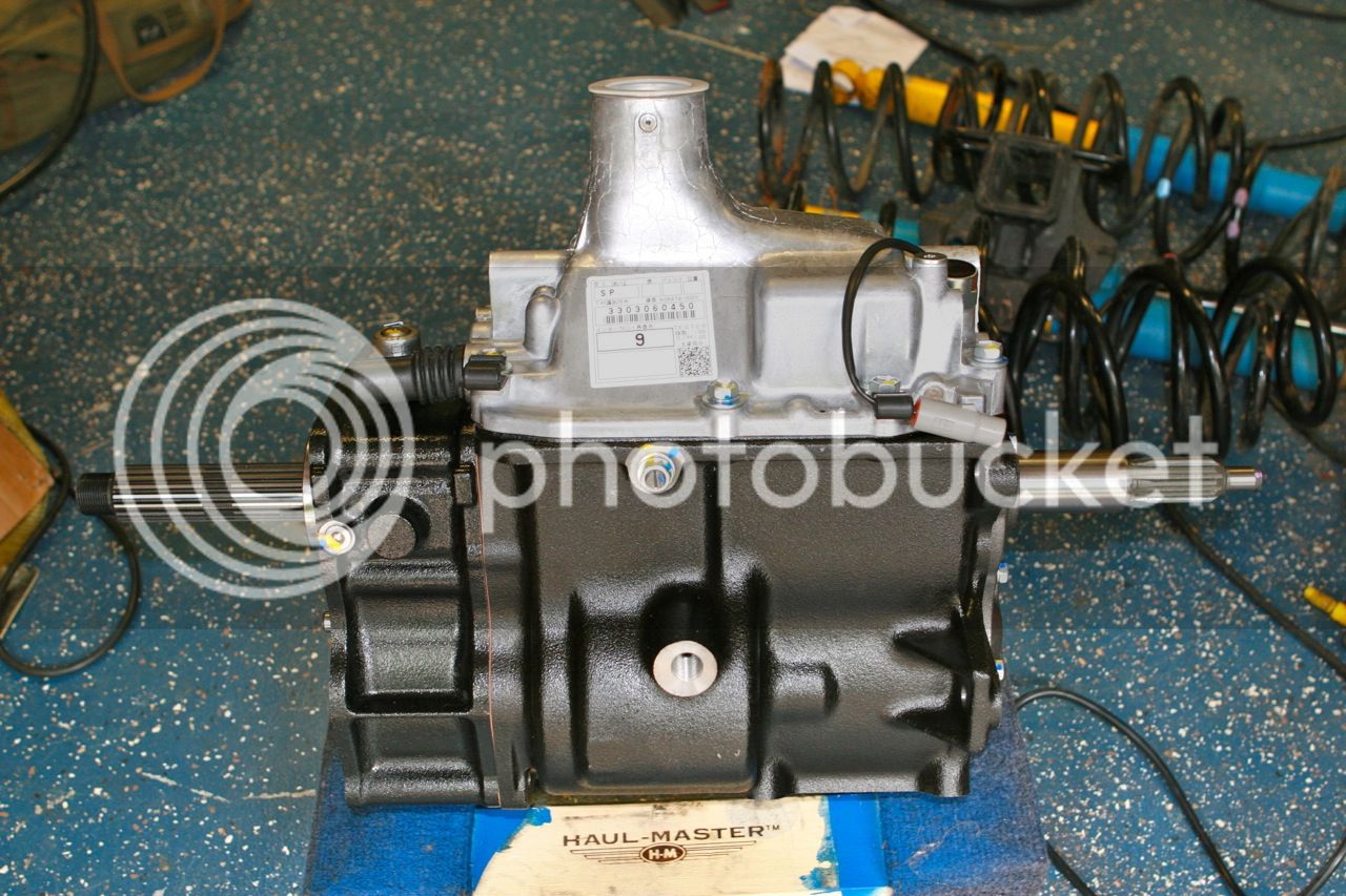

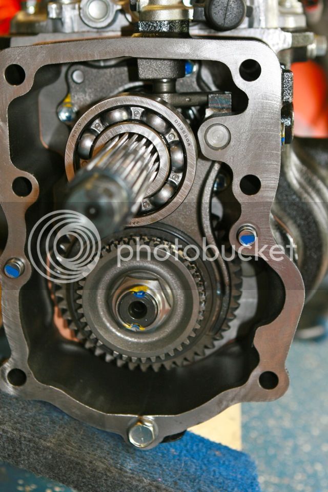

As has been noted, Toyota still makes NEW H55 transmissions for us. Sticker price is - $2715.53, with our club discount, below CDan's price, tax brings it right to his price, but, no shipping. Thank you Fred Anderson for supporting our club...
No shipping cost to me, clearly it was "aired" in by the RDU marking...

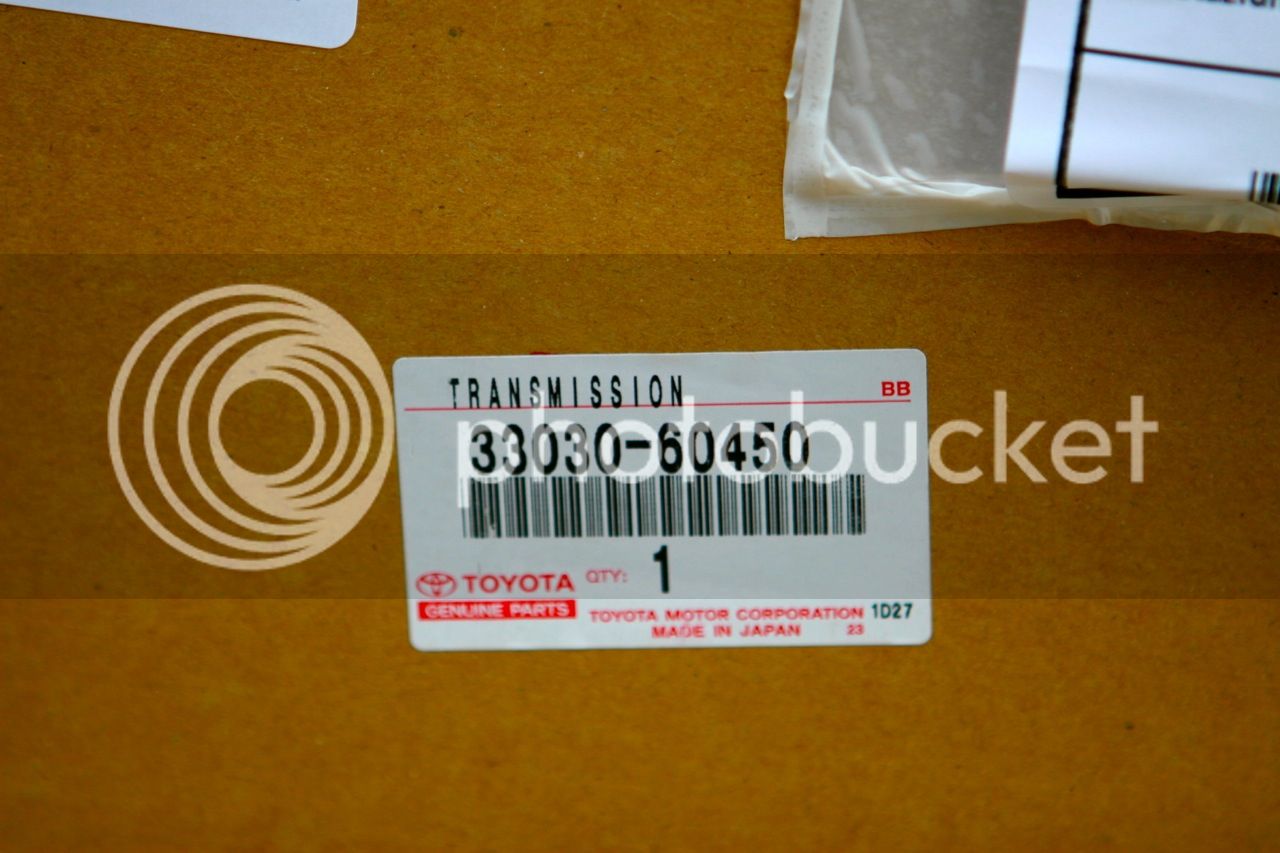

Just in case anyone needs the part number...

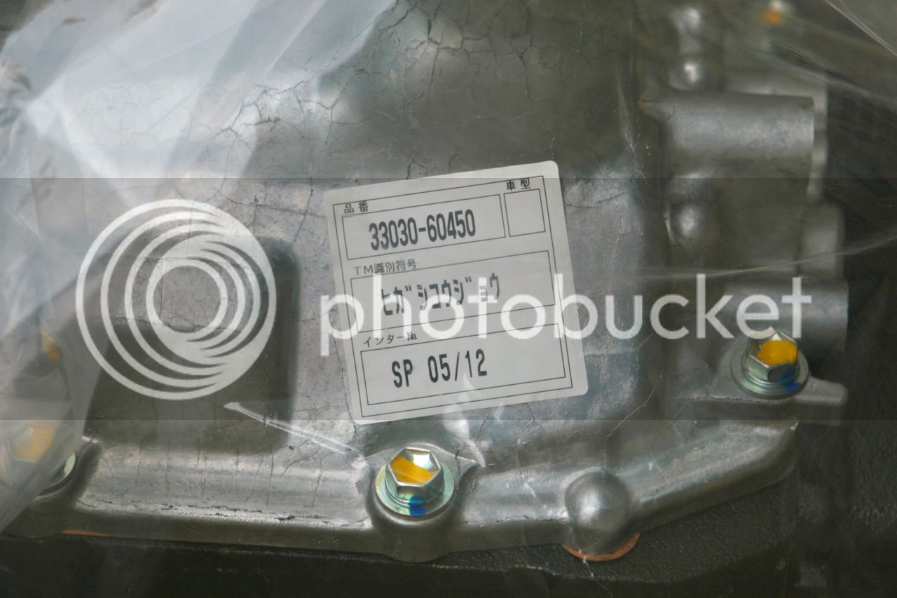

And, again, in Japanese also...

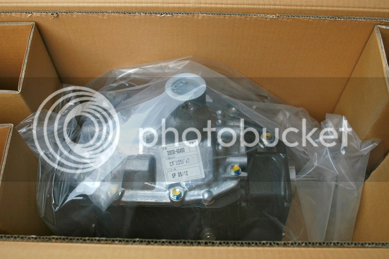

Not quite hermetically sealed, very well packaged in any event...

At least a re-gear, found having the Lefty in the FJC invaluable, gotta find a similar if not better option for the 45...
IMHO best option would be a crawl box you could have a low range well over 300 and anywhere in between with all the different gear combinations

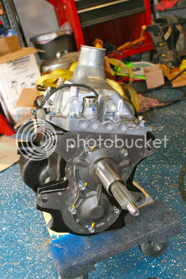

Jerry, that H55 is pure porn. I wish mine was that pretty, but at least it works.
To get a crawl box for that bad boy, you pretty much have one option, the Toybox. Marlin Crawler makes a Toybox for the H55 but you have to cut the output shaft to turn it into a spud for the Toybox input. Not a big deal if you're doing it on a 20 something old transmission like mine, but a very big deal for a brand new $2700 transmission. Look into the new 4:1 gears that AA just came out with for the Split case. That case will bolt right up to the H55 ( no mods ) and allow you to run the 4:1 gears.
Agreed, yet, not great options available without major changes...
Either way, very cool man, good work:cheers:
Agreed, yet, as said above, not much out there now.
I'm not happy with the gears in that you get either the crawl ratio OR retain 1:1 output in high. Doesn't make a bunch of sense to me to use the H55 then re-gear the t-case 10% underdrive. I'll have to use a gear calculator to see if the underdrive might not influence it as much as I'm imagining now. The goal is 35's with 4.88's in the 3rds.
Marlin's Toybox with stock gearing should be low enough and since I'm making a new tranny crossmember anyway, adding any length to the drivetrain won't influence that though I would have to get the driveshaft sized.
I'll be getting in touch with Marlin to see what the status is before I start scouring the market to find a used one...
