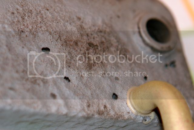

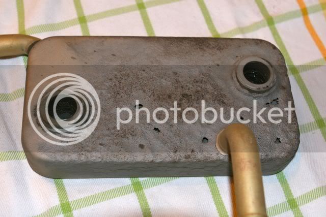

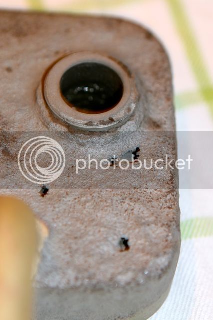

Finally got back to work on my project. Spent the day degreasing, sandblasting and powder coating parts. The "oil cooler" was particularly nasty and I found out why...
What do you think, need a new one? :rolleyes:
The question is...will this be the piece of unobtainium that will throw the project into a stall. I know I can get a NEW one from Fred Anderson but I don't want to pay that pretty penny for it.
Why is it that nobody rigs up an "real" oil cooler? This is no restoration, resto-mod at best. There has to be a relatively simple way to pipe in a decent oil cooler instead.
