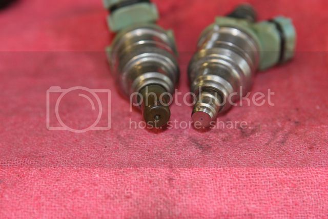

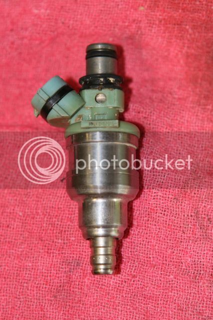

Getting down to the meat and potatoes of the build, fuel and air. I cleaned up the injectors today and glad I did. I found one of the caps is cracked and needs replacement for sure. I also noted that one injector is different from the others though having the same part number. Interesting...
most likely a change in the OEM design that got put in when a replacement was needed.

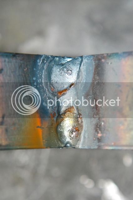

I ran a few beads across some scrap 1/4" steel and welded some misc scrap together but these are my first real attempts at welds. In the axle dolly, they use 1/8" x 1" flat stock bent into this Z and welded together as the axle stand. Here is the progression as I went along, being lazy, no prep work was done on the metal, it was welded as is from my local Ace Hardware...
1st...I forgot to allow the post-flow to stay on the weld. My habit with the MIG was to just move the nozzle away when done with the weld. It is clear with this weld I got the porosity at the end of the bead due to the lack of shield gas...
2nd...same thing, not as bad because I remembered, after I initially forgot, going back with the shield gas as it cooled...
3rd...getting it figured out. The metal isn't clean and it shows in the end of the bead. But, nice and flat, a little wobbly but getting better for sure.
Sure like using the TIG, I can see the puddle so much better as well as the arc. Its a nice, straight arc, I can see where it gets the puddle started and work it along the joint, very cool. Also, no sparks/little molten metal balls flying everywhere. Much slower than I'm used to with the MIG and the settings I use, allowing much more precision.
