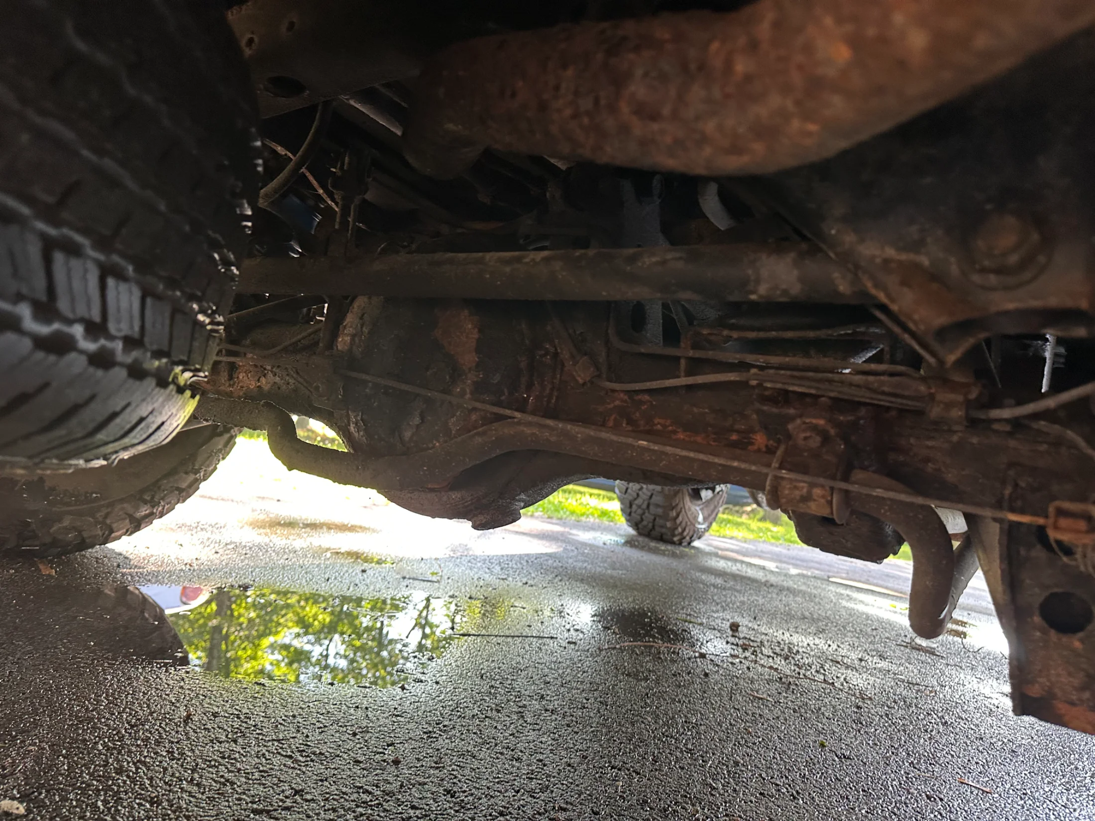

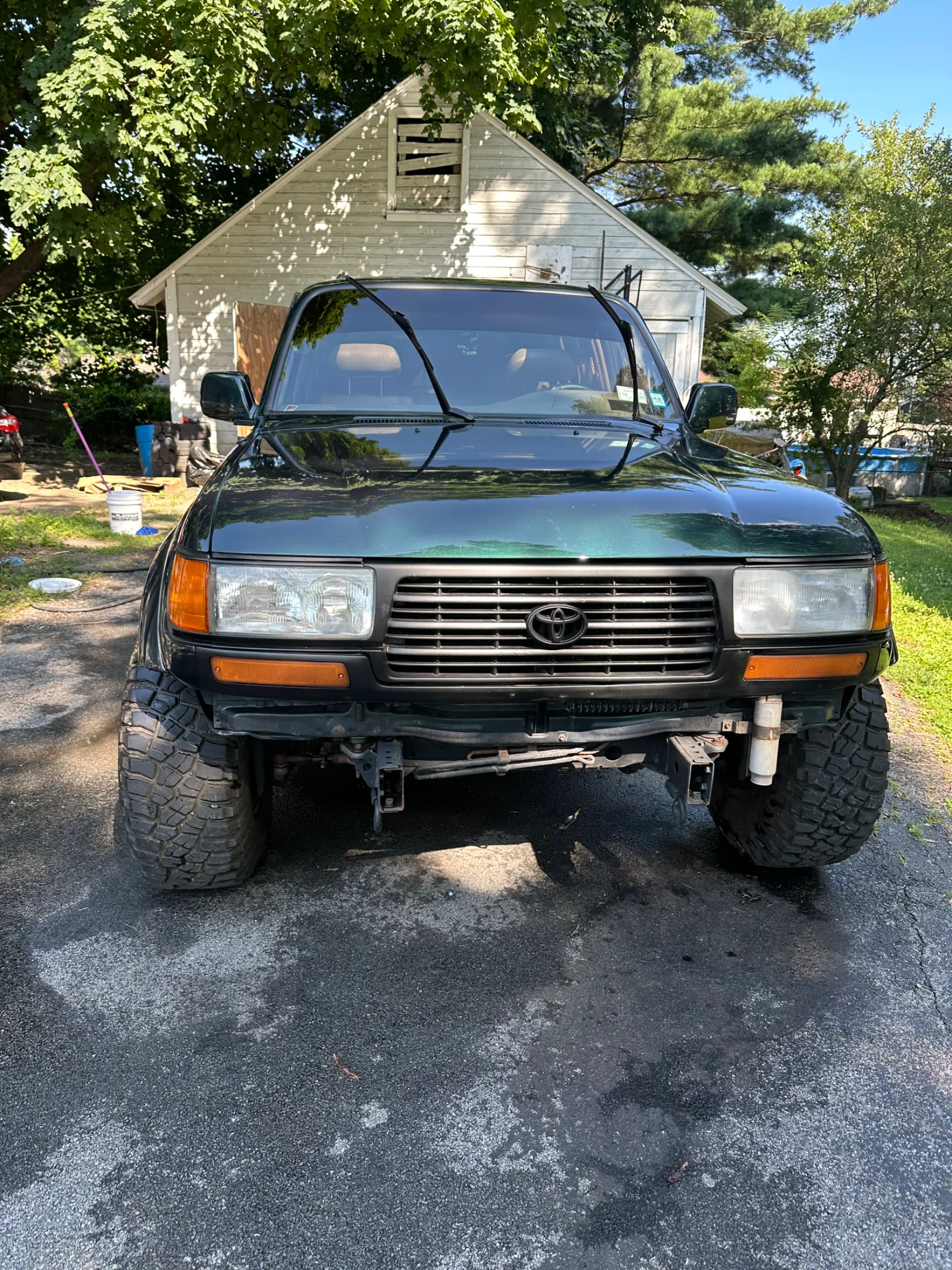

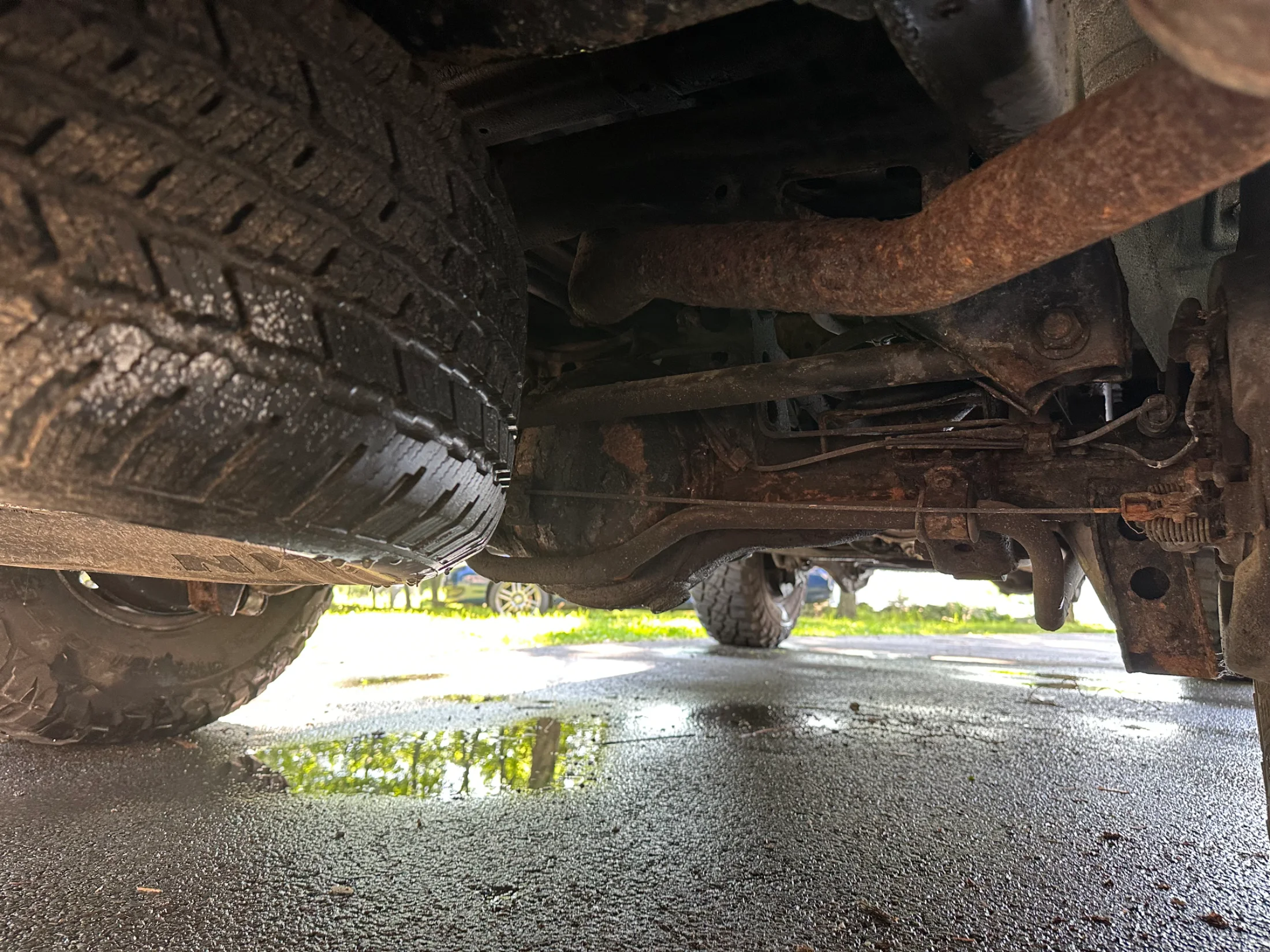

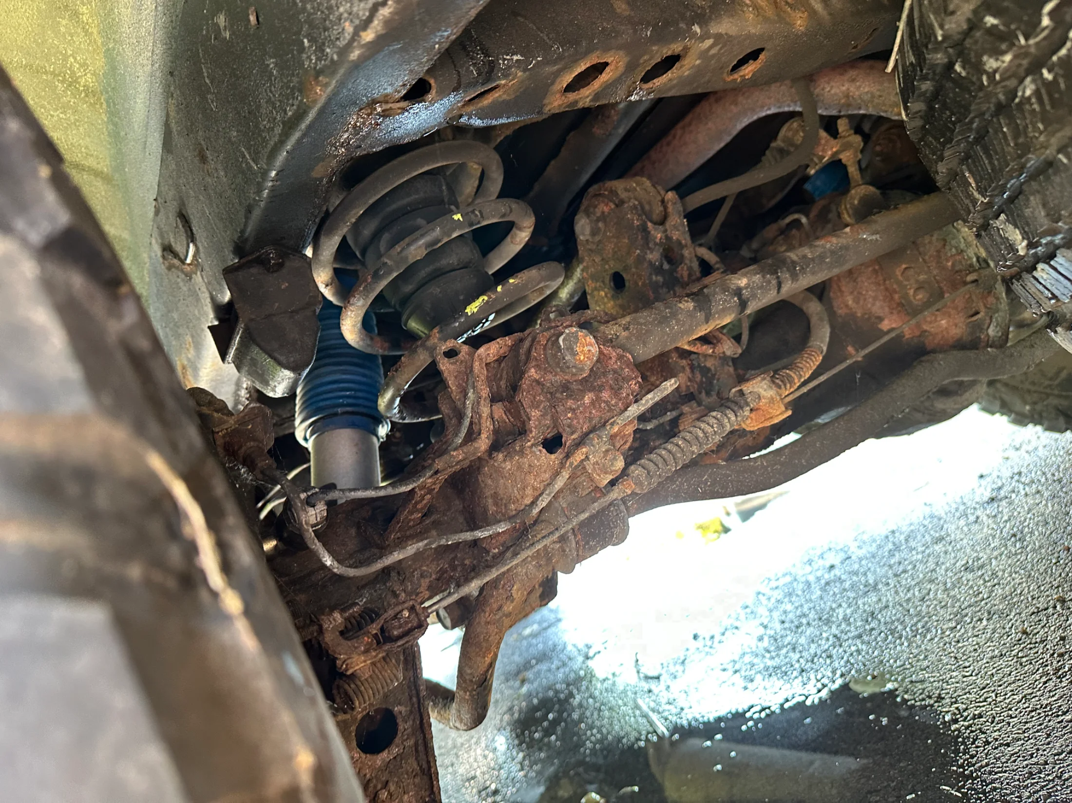

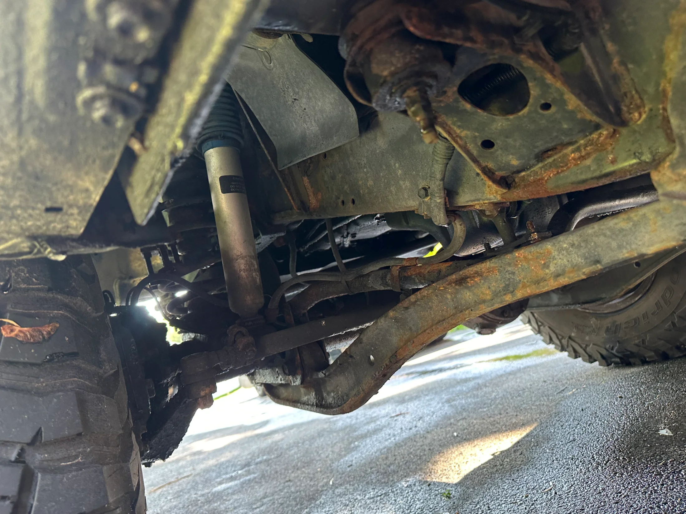

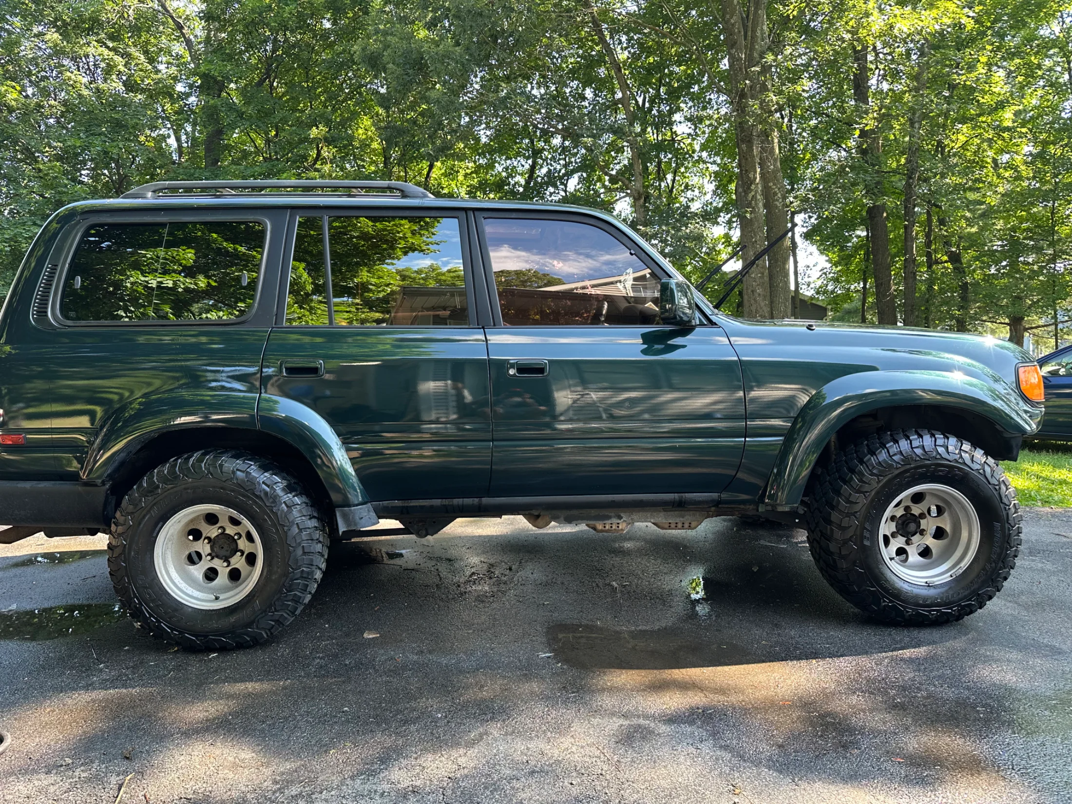

Initial photos

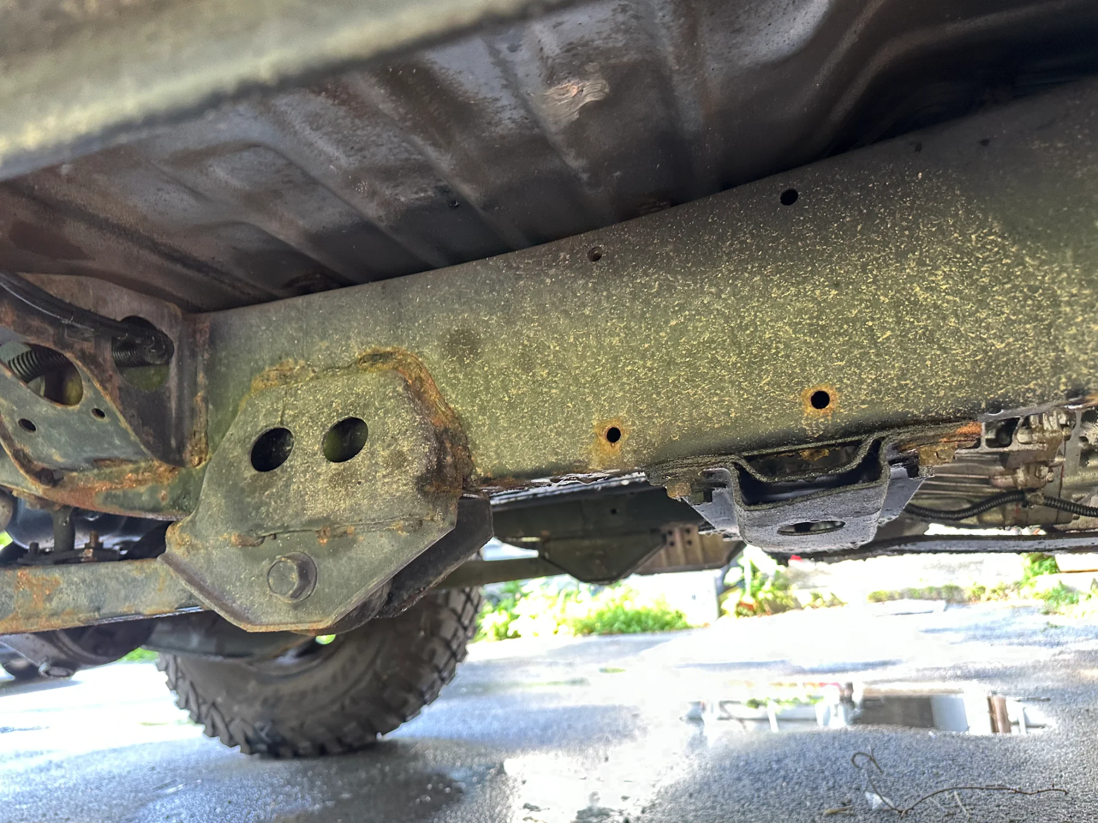

The passenger side rocker panel will need replacement - the previous owner did a coverup job that couldn’t been an issue if I didn’t inspect it properly. That helped with the final price agreed. Interior is ok but will need a full carpet removal and shampoo - they smoked in it… all the expected leaks are present - distributor cap, valve cover, transmission seal, birf. All in due time tho.
Most of the rear end will need replacement - suspension components along with their mounting point. Rust removal, hard brake line replacement, all rubber bushings, panhard, uppers and lowers, shocks, springs, diff surface rust, drain plug, sway bar end links etc.

Wheels and tires came with the rig - kinda bummed he didn’t have the stock wheels which I like. It’s been a couple days and I’ve been busy with work, but I’ve already begun ordering OE hoses
