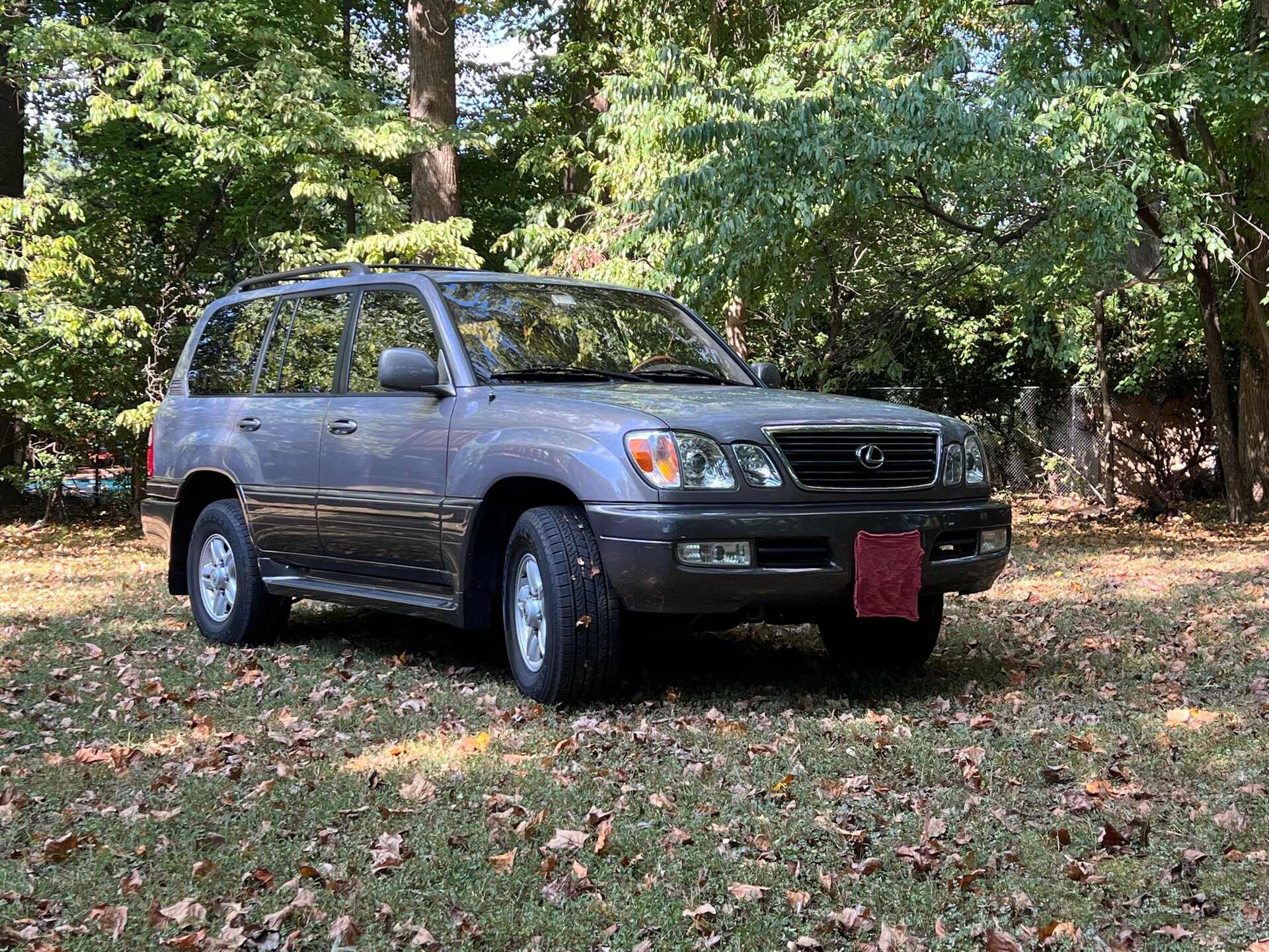

I'm new to this forum, but my parents have owned this 2000 LX470 since new. It currently sits at 206k on the odometer.
It's definitely seen better days, and 11-16 MPG around the DC suburbs gets expensive on premium fuel. As it sits, it is completely stock. If we decide to go the route of fixing it up, I already know this forum will be priceless. Thanks!

Welcome! Cool color

A very cool color. Rarely see that color out west - they are all green, white, or black.

Re: Color
Thank you! Smoky Topaz Mica seems to have been a 98-00 only color, and only on the LX. I think the color looks nice on the LX and that the color and trim combo has aged well. Unfortunately, the clear coat is starting to go, which seems to be more likely on this color alone. But it does look very nice in the sun, especially up close.
