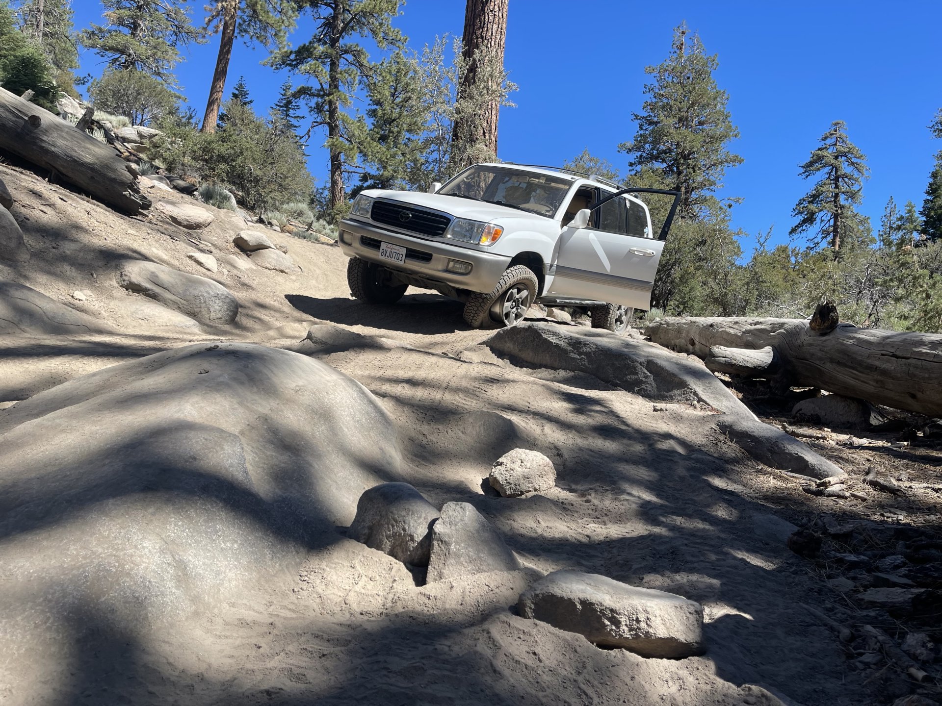

I had this happen yesterday morning up in the mountains on a trail that was new to me and I was not prepared for it. I didn’t have a jack that was workable and I didn’t have a breaker bar to loosen the lugs that my mechanic overtightened last week.
Luckily a couple of locals came out and with an off road floor Jack, a can of starter fluid, and a lighter, re-seated the tire for me.
Is this a common experience for anyone here? I was running the tires at 20 lbs, which I thought would make this less likely than running them at 15. Are bead locks a real solution or more of a nuisance?

Thanks for the tools list and suggestions. We had the four way lug tool and a screw jack (which was not working in this instance), the air compressor and most everything else. I need to add the breaker bar, the ratchet strap (great idea), a better jack, and valve tool. So basically I had the basic tools, just not all functional in this situation (breaker bar or cheater pipe was a key missing element).
You are right about the tires 285/75 16’s on stock wheels. I was wanting to avoid rubbing and do like narrower tires for the occasional snow travel. I guess this is part of the price for that decision.

I find it interesting that you lost a bead at 20psi with a 285/75r16 on stock wheels. That's not a skinny tires by any means and that's not super low pressure, IMO. I know pictures can be deceiving, but the trail doesn't look particularly rough either. I guess that's one you just have to chalk up to crap happens and be more prepared next time.
