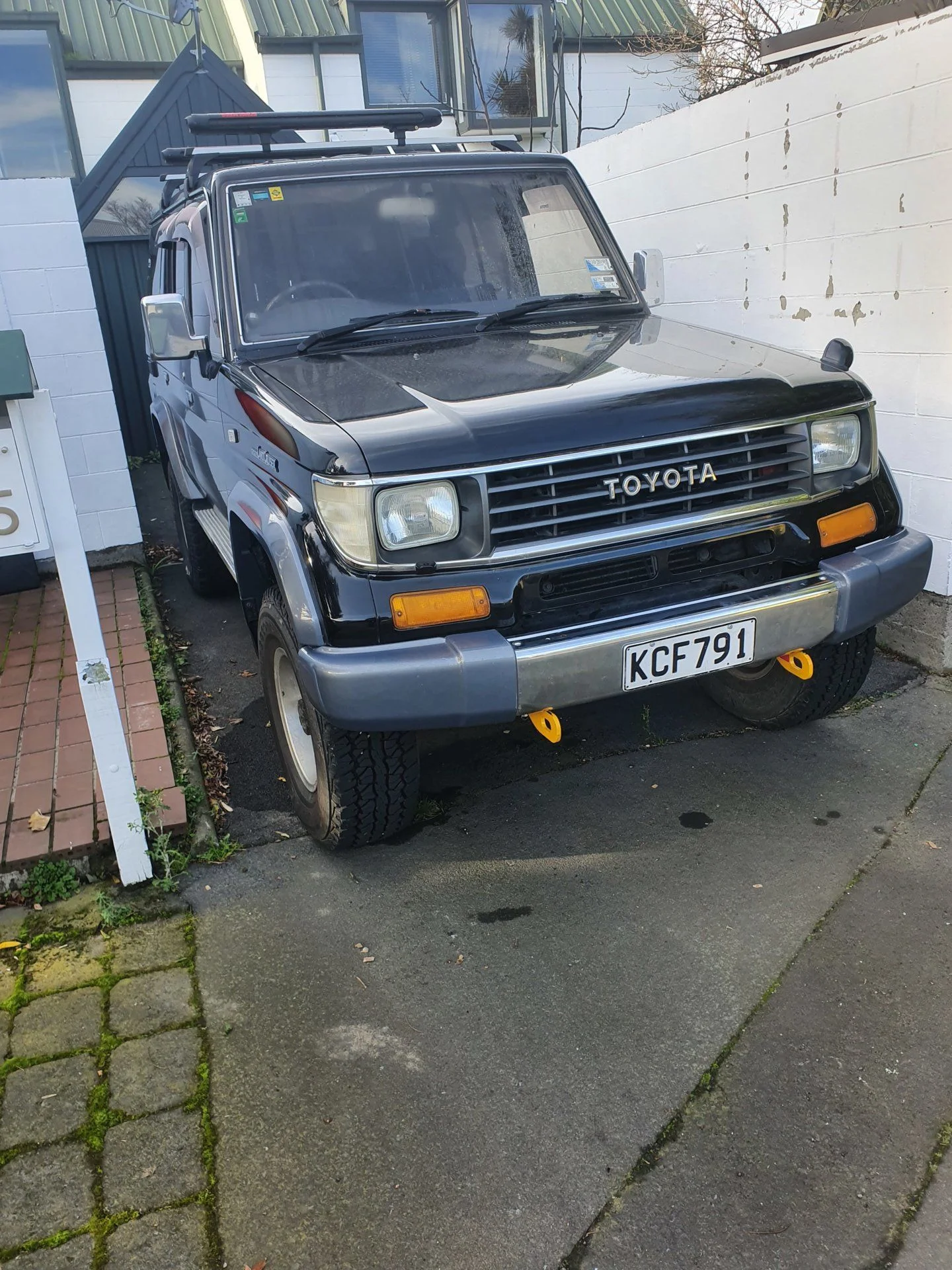

Hi folks, does anyone know of a brand that produce a KZJ78 snorkel?
Seems to be only one supplier in NZ - Hawkers - and I don't like how high it sits on the body panel.
Cheers in advance folks. Here's my rig as thanks.
2021128
Ask ARB. If they dont have it listed they can often match it up with a snorkel from another make model. They just need one with the same windscreen angle. Other wise try ebay, their were a heap of snorkels for these from a Malaysian supplier at $99AUD
There could be some good reasons its sits like it should. It doesnt look like it would fit between the top of the fender and the crease in the panel
