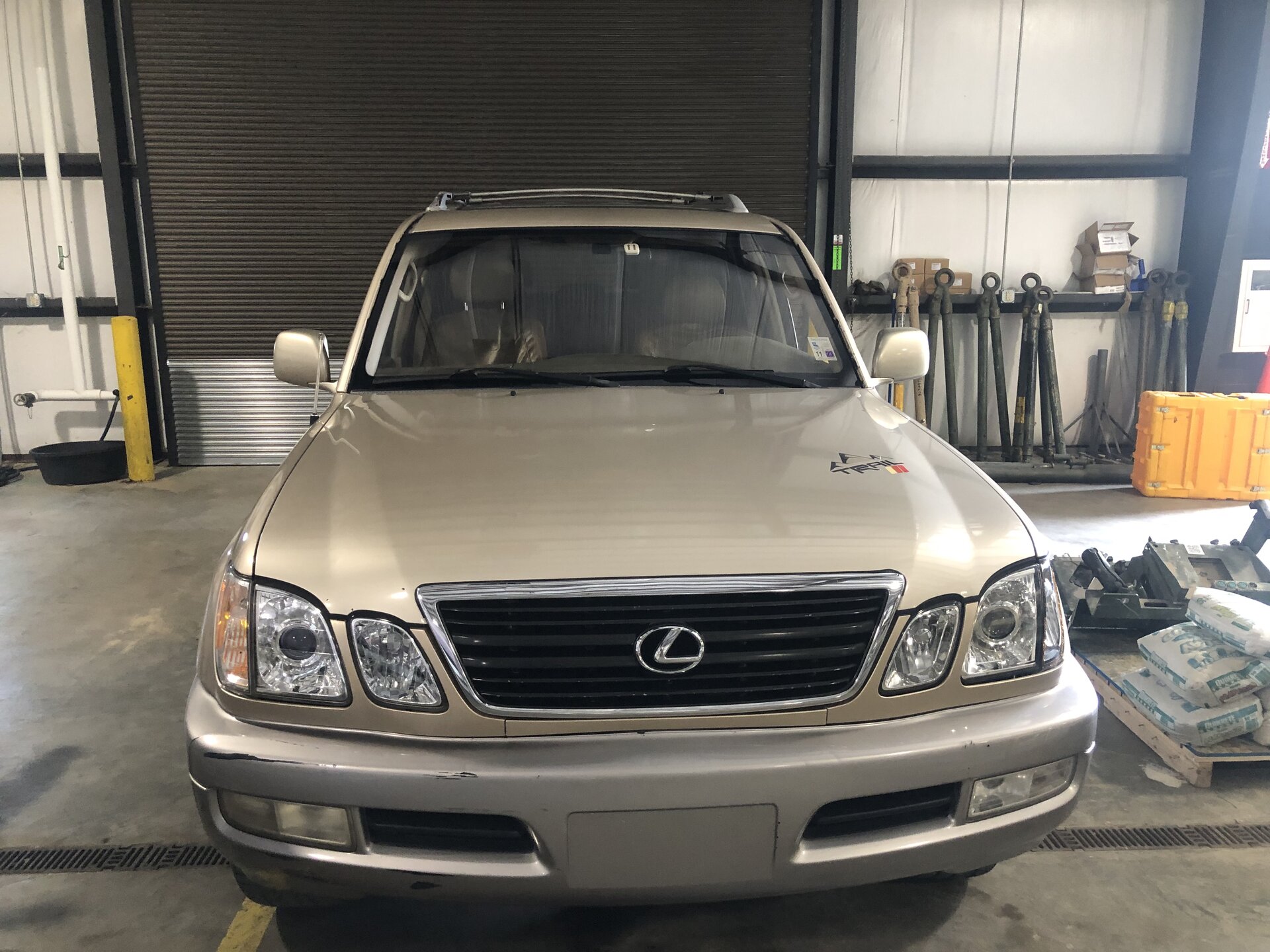

So, already an 80-series owner, but ended up picking up a LX470. Just starting a thread to document progress and ask some questions..
Here’s some picks when I brought her home.

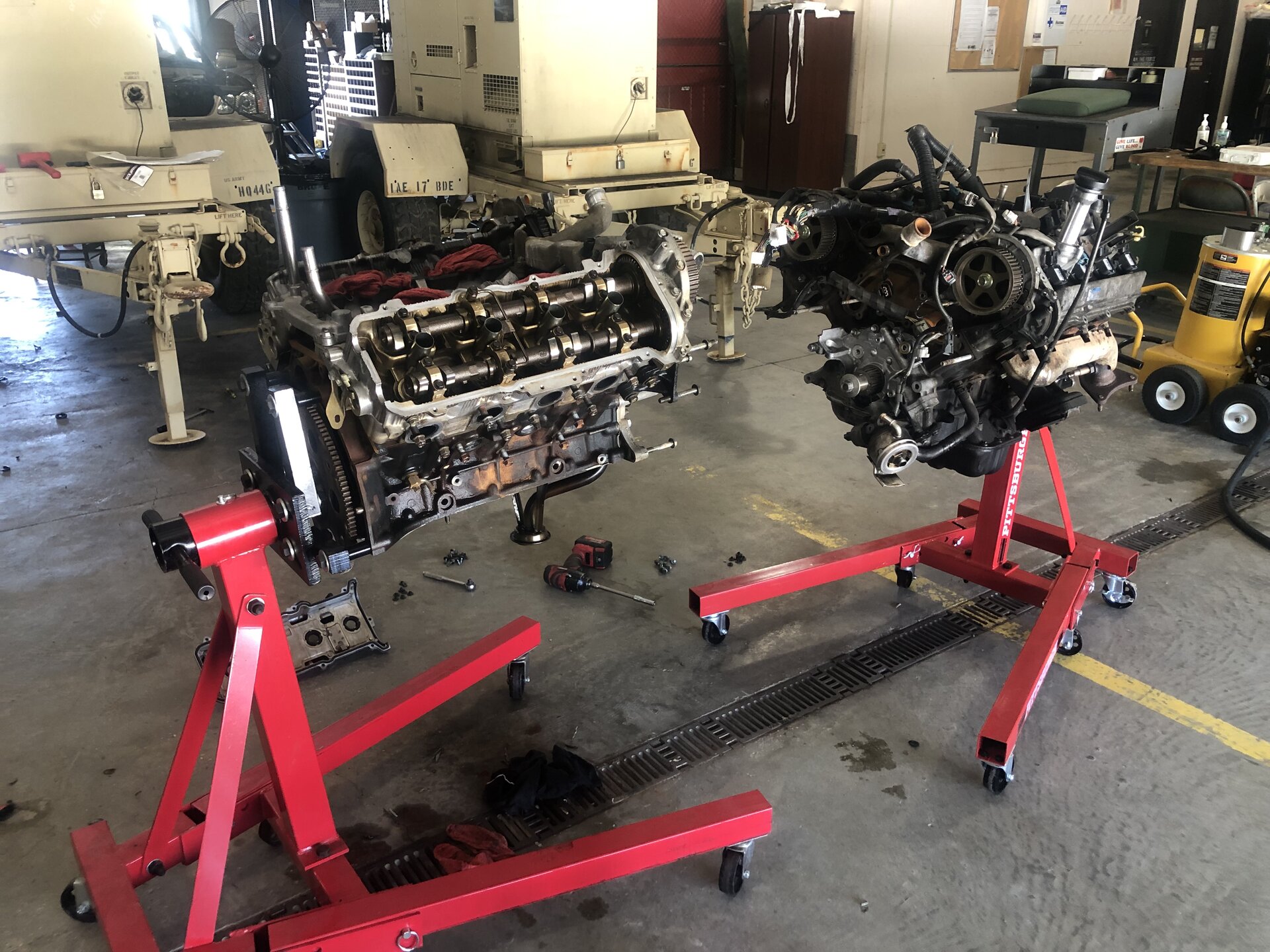

Timing belt water pump..and engine :(

Ouch, that's a tough one for sure. Hopefully the price was right, engine considered.
How many miles on the original/new engine?
If you are on Facebook I recommend you consider joining the FB Group "UZJ100". Great source of tech info.
Good luck with the new rig!
Picked it up for a decent price. Would have offered less if head gasket issue was known. Original engine had 228,xxx and the engine out of the Tundra had about 170,xxx. All things considered, still around 7k in.
Congratulations and what a way to start a project. Please consider servicing your Rear Main Seal “while in there”.
Thank you. Unfortunately I did not do the rear main. Hope it’s not something I’ll regret..she did get a new oil pump, starter, plugs, coils and the power steering lines to the reservoir. I’m just happy it doesn’t leak and I didn’t have any leftover bolts.

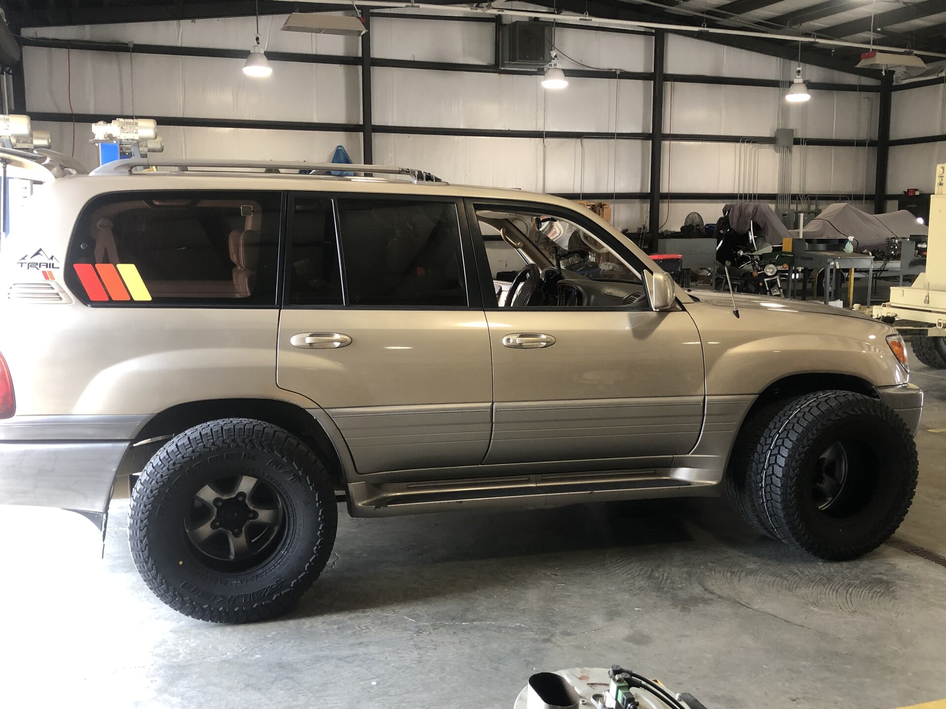

Well, Tires happened sooner then planned. This morning actually and in the parking lot of the local YMCA. I’m sure they loved having my vehicle there on Jack stands. I’m loving the way it fills out the wheel wells. Wife says I need to paint the rims black… It’s time for her to get her hands dirty.
