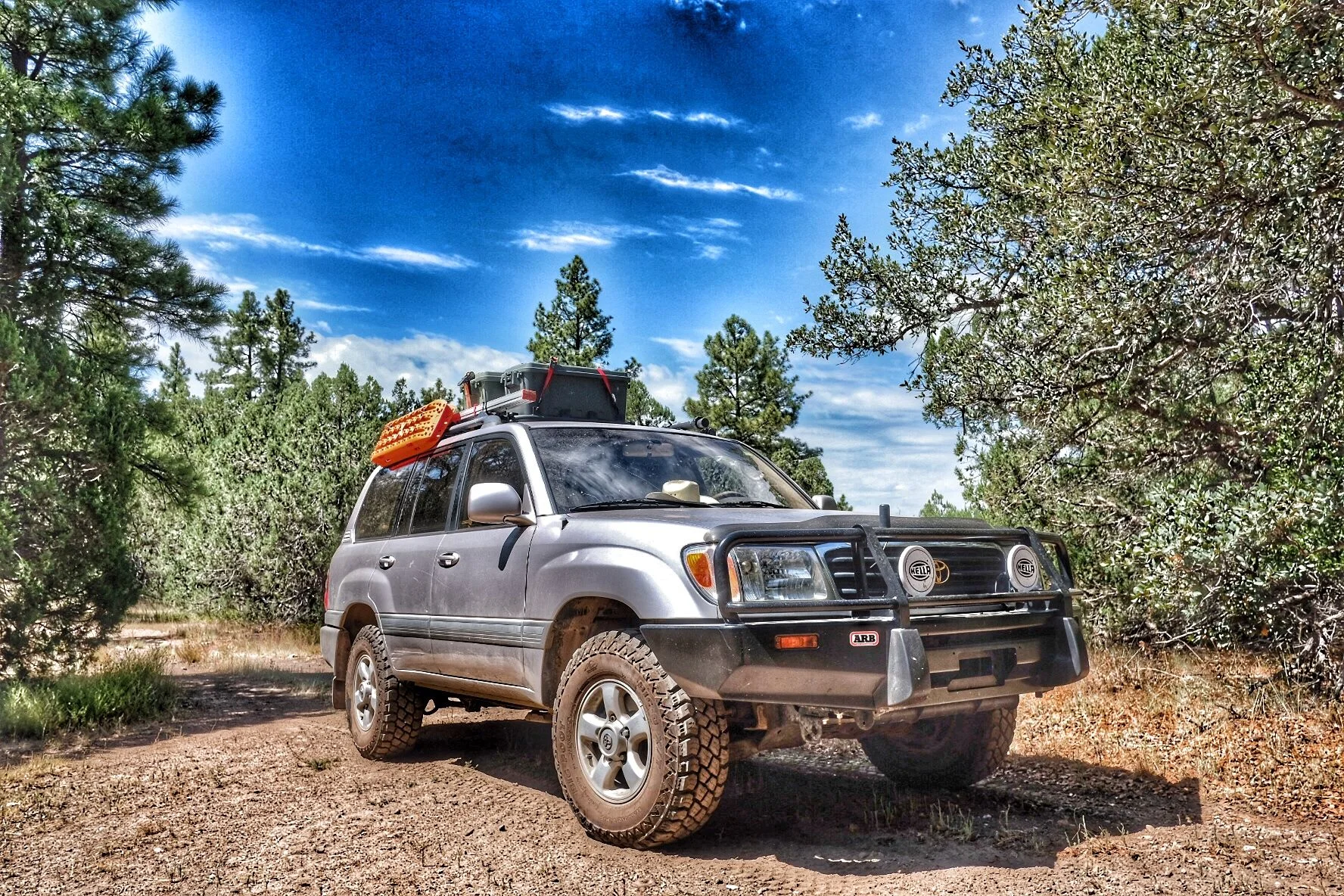

Hey everyone. I am looking to upgrade the suspension on my 2000 LandCruiser. It’s stock right now, with 300,000 miles (I’ve only changed out the rear shocks once, and the front shocks are original OEM - so I’ve gotten my money’s worth.)
It’s my daily driver, but I hit the trail twice per month. No rock crawling, but some 4WD trails.
I have an ARB bull bar on the front and no aftermarket rear bumper.
I’m leaning toward OME - torsion bars, medium load springs and shocks for the rear and the stiffer (60001) shocks up front because of the bull bar.
Anybody have any other suggestions or words of caution???

Thanks for the advice. Went with a pkg from Cruiser Outfitters. OME torsion & rear coils, plus new OEM shocks all around. Pretty decent deal - and it’s tough to find the OME stuff in stock right now. Can’t wait to install...
