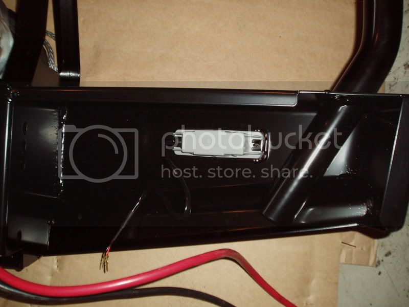

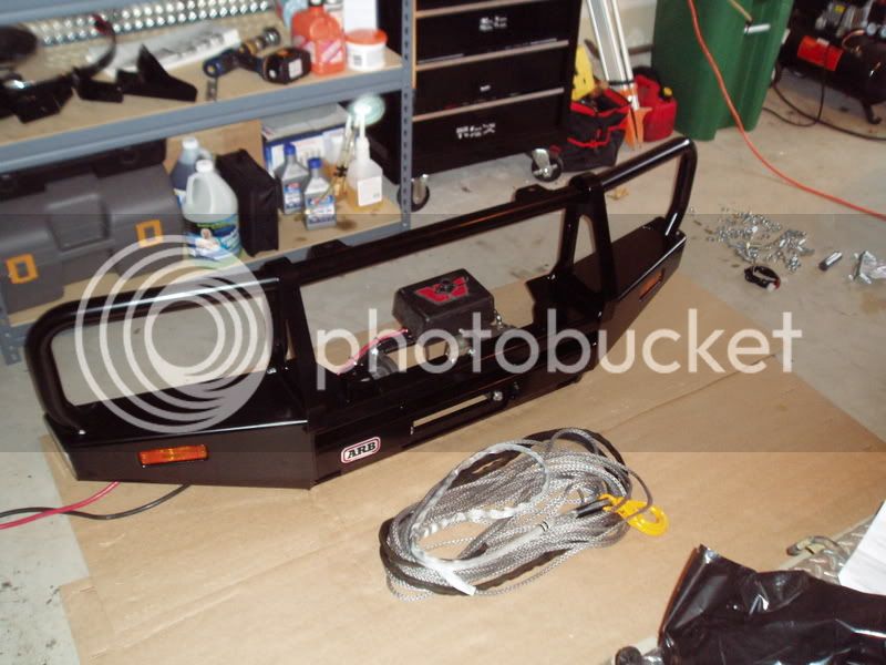

Just realized a few things today upon getting mine in the mail...
1. The box is HUGE, and WAY over packaged. I'm not going to complain about that though. It only filled less than half of the box. I've now got a mini dumpster in the front driveway until garbage day.

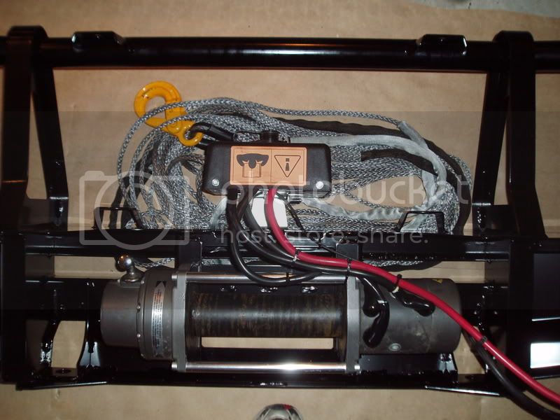

2. The d-ring points are well reinforced. Much better than what I was expecting.
3. The winch is "clocked", and the base is mounted forward.
4. There is an overwhelming sense of quality construction with this bumper...even Mrs Dirty commented on the quality.
5. The BIG bummer for me is that I cannot run an aluminum hawse fairlead with this bumper. Gotta run a simple roller fairlead. (EDIT: You can run a regular aluminum fairlead, but you will need different bottom hex bolts to get them to thread. You can also get a special "offset" alu fairlead as discussed in the recent winch to fairlead angle thread - this is the path I will take with this).
6. Another bummer is that you cannot run PIAA "light locks" in the light tabs.
Some additional pic's:
