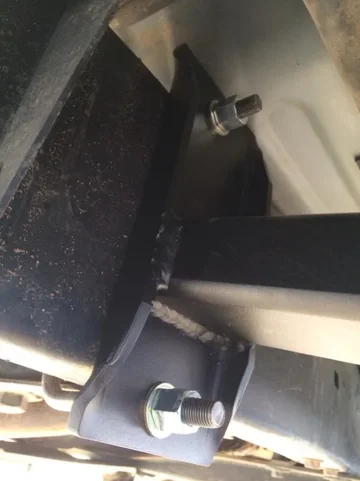

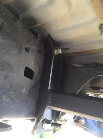

I installed my outpost off-road sliders today, but the tops of the mounting brackets are touching the body. I prefer not to lower them otherwise you'll see a very noticeable gap between the pinch weld and the slider.
But I'm guessing I will have to, because it will likely rub like this?
Any other ideas?
Front mount:
Middle mount:
Mine are touching the body at the top also. You can use a cut off disc to remove some material. I plan on just lowering mine. The vibration and clunking I get is driving me nuts.
I'd be nervous taking too much off the top of the mounting brackets. Not a lot of material up there.
I'll probably just move them down for now. At some point I might get industrious and cut the front two mounts and just weld to the frame.
Everything always move difficult than it seems!
They should sit as low as possible on the frame. Hang them. Tighten. Drive around for a week. Re tighten. If you install them at the top of the range they will chatter against the body.
I don't want them to hang down low. I'd like them to be up nice and tight! :) In lowest position there is a large gap that doesn't look good.

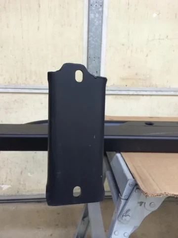

I notched the mounting bracket. If this doesn't work I'll cut the tops off and weld to the frame.
Fwiw it is the front two mounts that hit the body. The rear has 3/8" clearance or more. image-182471090.webp
You can want that, but its not how they're designed to work. Welding to the frame would be a solution. IMO you've already removed too much material. That flange is there for a reason. I doubt it will fail, but if that's the front leg it will take a lot of force on its own if it takes a hit.

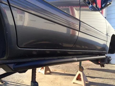

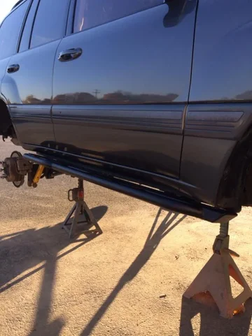

I have MT, not OPOR, but they look great IMO. Gap below rocker is a non issue and the MT sliders come straight out.
Also keep in mind that the body will flex quite a bit around the frame and the sliders will also flex up under load so you'll want to have at least 1/2" - 1" clearance from your rocker to your slider.
If I were you I'd run it for a while as suggested and if it really bothers you start playing around more. Get it up on three wheels too to see where the body ends up.
Oregon, do you have a closeup view of your sliders and what the gap looks like? I'd be curious to see...when I initially put these on I had them tightened loosely hanging down at the bottom and the gap was really large.
The brackets are 1/4" thick steel. I took very little off right above the mounting hole, so I think I will be OK.
I can't imagine 1/4-3/8" of clearance isn't enough to keep them from touching under normal driving circumstances. If they touch the body under extreme flex, I'm not too worried about that, it shouldn't do any damage. Please correct me if I'm wrong.
With the bumper I allow a finger width for flex and it hasn't been any problem on the front. The rear bumper has touched the body but hasn't caused a dent.
If you click on BTBT in my sig and scroll down to post 23 you can see the gap. I'll see if I can get a better pic tonight.
