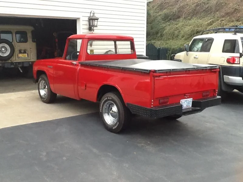

Just added this one:
So the hunt for parts is on! It shares some parts with the 45LVs . . . .:D

She might be purdy on the outside, but I have my work cut out underneath. First task will be to remove 45 years of oily crud from underneath, then move on to replacing oil pan and valve cover gaskets. Remarkably, the little 1.9 L 4 cylinder engine is still strong no smoke. Gotta bunch of little stuff to do:
1. Get wipers working;
2. Make sure the brakes really, really work;
3. Rhinoline the bed (this is going to be a working truck);
4. Find original wheels (or FJ 40 wheels);
5. Tighten up a bunch of fittings on the engine (read here very loose fit on air cleaner to carb);
6. Replace a bunch of plastic lens;
7. Wire brush/sand/ blast frame and apply POR;
8. Get the Temperature gauge working.
While there is no parts source for these trucks (other than junk yards), a lot of the non-engine parts are the same as the 45LVs from the same time period. I have ordered a bunch of engine gaskets from Rockautoparts for a Corolla from the same era as they share the same engine.

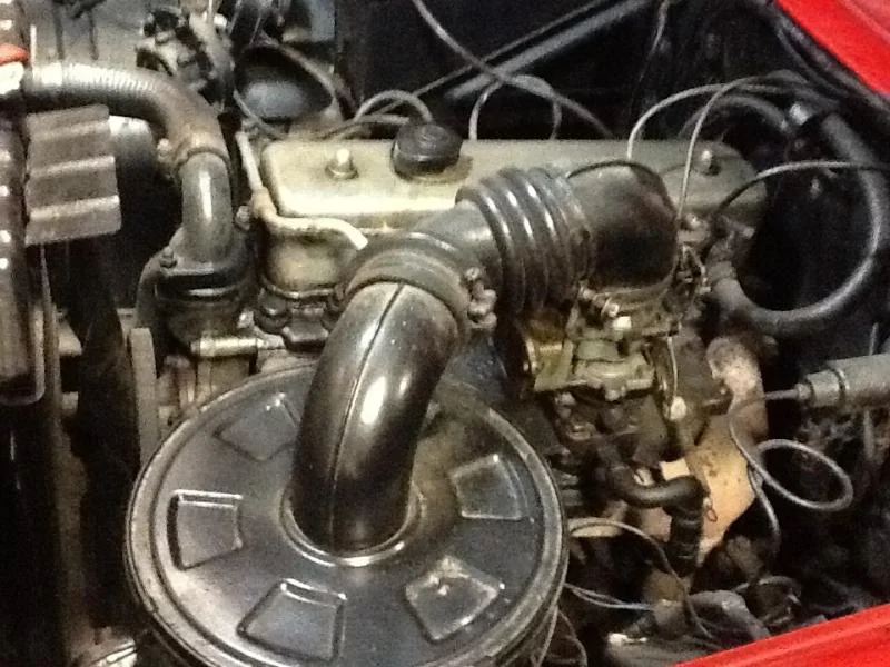

Spent all weekend removing rust from underneath and crud from the engine compartment. Found a good parts source in Long Beach, California (Cabe Toyota). Using a sandblaster on the underside of a truck is a bear!!! Thinking about calling the mobile soda blaster, might be worth the $300-$400 - - been picking sand out of my ears for days!
The 1.9L 4 engine is an amazing little workhourse. 45 years old and still sputtering along, no cloud of smoke!

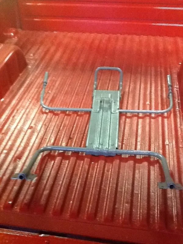

The spare on the Stout is mounted underneath the bed. Pretty modern for 1967. After blasting it down to shiny metal, I painted it land cruiser grey. This will be a recurring theme.

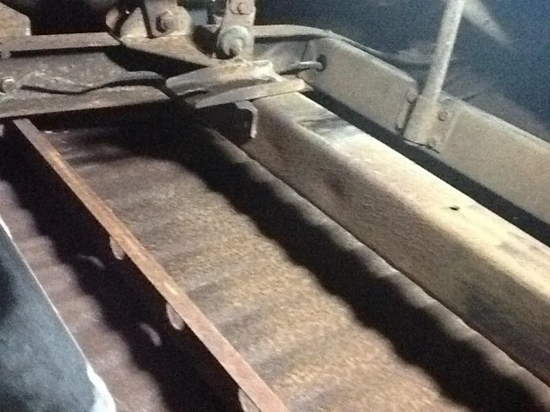

The bed is in good shape, but I don't understand why the PO didn't blast and paint the underside. I plan on taking the bed off like jp did, flip it over, and blast away. Lots of surface rust and scaling...just in time to save it.
