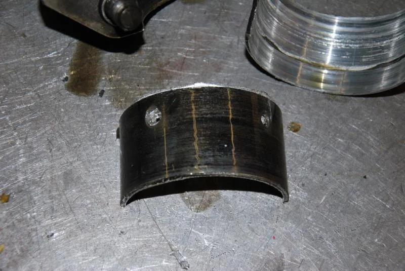

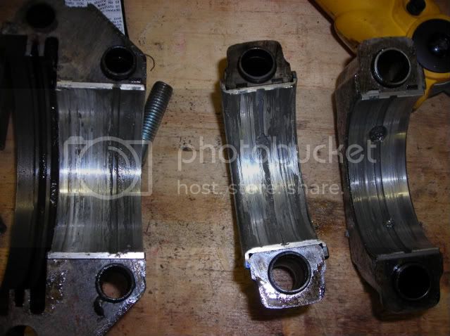

Well it's nice to know i'm not the only one up this early thinking about this stuff. I fell asleep last night at 9 after a full day of building retaining walls and raking loam preparing for finally planting grass at my house. But I woke up at 3 thinking about this and couldn't get back to sleep. At about 4AM after reading Poser's post I went down to the garage and pulled the pan. You really are the man on this stuff. #1 main bearing is fine, and the rest are smoked. I only pulled 2 rod caps and they both looked fine, i'll pull the rest later just to double check. #2 and #3 journals on the crank look like they are OK. #4 is a little sketchy, but maybe some emory cloth will clean it up well enough. So this is what I found.
The bearings having 2 sides makes sense, but in the photos you can see that the # 4 bearing shell from the bottom has no holes in it. Also I recall that the #2 and #3 bearings were identical top/bottom in my ITM set. That still remains to be seen. So is there perhaps more to it? Also isn't it possible to install bearings without pulling the motor? I was thinking maybe if I loosened the 4 bolts holding the tranny on and jacked up the rear of the transfercase a little I could slip the uppers out.

Later this morning a friend of mine who has built far more engines than I have crawled underneath to take a look and we agreed the crank has to come out. He's got a lathe so we may try to just polish it first and see how that goes before I spend even more money having it ground again. And all the bearings were in fact installed correctly. We took out the #2 and #4 uppers and they were in there correctly. We didn't bother with #1 because the bottom half was perfect and #3 is the thrust bearing and it wouldn't come out easily. So he thinks that the machine shop never cleaned out the oil passages in the block or the crank. I'll talk to the machinist tomorrow, but I did assemble it after all so I'm probably screwed. He told me when I picked everything up to wash out the bores and clean the block a little because it had been sitting a few days. I assumed he had cleaned out all the passages. So now I need another whole gasket set, probably will need the crank reground again, new main bearings at least, and maybe a new cam and cam bearings if I understand the illustrations regarding the oiling system. I did landscaping all weekend and i'm beat. But i'll probably get the motor out next weekend, and start tearing it down AGAIN. But to be honest I'm pretty broke from this rebuild and i'm going to need a riding mower soon. So unless the machinist takes some responsibility for this I won't have any more money to put into it for a while. Even before all this happened I had already spent twice what I was expecting to build this motor with everything that came up. The only thing that went as expected was the cam and lifters, which may now be junk.
Q:He told me when I picked everything up to wash out the bores and clean the block a little because it had been sitting a few days
this is S.O.P. when i got my crank back from the machine shop i ran compressed air thru all passages.
when i did this i found what looked like a bullet in one of the cranks passages.
go figure :frown:
