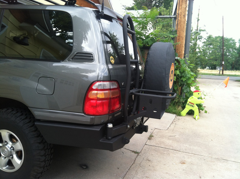

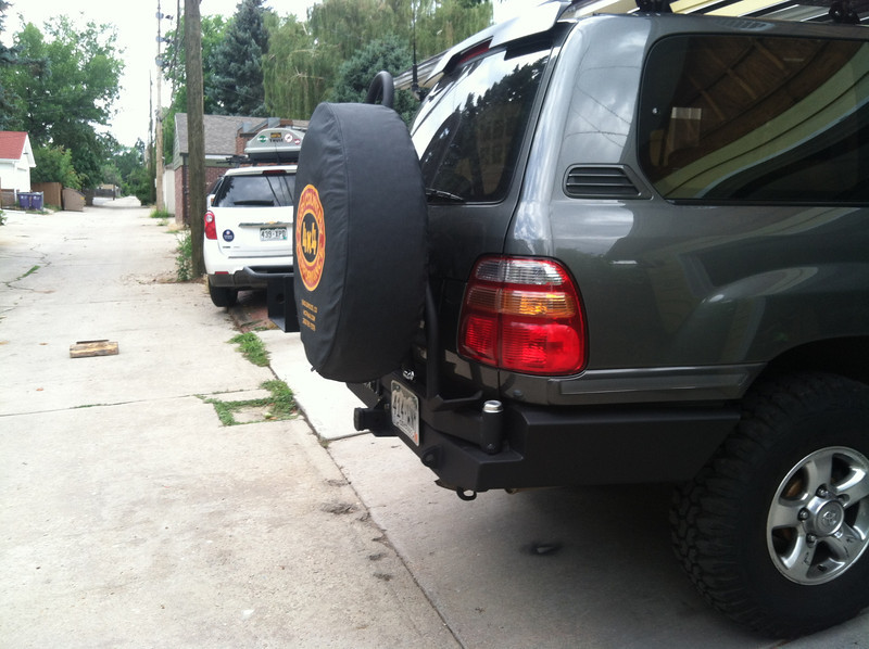

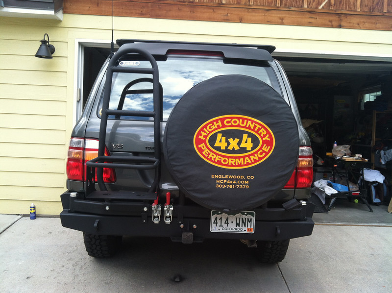

Finally found time this weekend to also install my new BIOR rear bumper.
I went with Bump it Off-Road (BIOR) and really like the quality and price of this bumper. I was able to get all the bells and whistles..

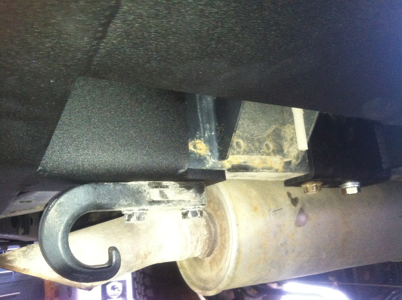

With the built in trailer receiver, I had to cut a space in the cross member for the receiver. Pretty easy, never have used a cutter wheel before.
Also I re-installed the hook, to help protect my tail pipe. Might go to Midas and have them bend the tail pipe up just a touch.
Sweet! Like the little basket at (for fuel cans?) the bottom of the steps. Thats a nice platform to step on/off when going up/down the ladder too.

Yep the basket is for two fuel cans. Also yes has the eye lets for the chains.

It looks like the design is very similar to Slee. At first blush it seems like Christo may use a more robust hinge pin design, but it's hard to tell from the pics. Is there a mechanism to lock the swing arms open somehow? Is the trailer receiver tow-rated and, if so, what's the rating?

The swing outs have struts, so they swing on their own and stay open. I think they are 200 pound rated. You gotta hold on to the spare tire when you open it or you could knock somebody over. Bringing it back is butter.
I am not sure on the receiver rating but the same bolt holes to the frame, with 2 additional are used. So I am guessing it has an equivalent or higher rating to what comes with the truck.

Guarantee it's not tow rated, to expensive and too much liability for the manufacturer. I'm sure it will hold up just fine.

Also the hitch, as well as most offroad bumper hitches, is not rated. Only ones i can think of are the ARB and Kaymar. Having a hitch design rated is very expensive and out of the budget for most shops.

Could i ask a favor? Do you mind getting a shot of the under side of the bumper near the hitch? And possibly one facing towards the rear crossmember, like from the axles point of view. I will be welding in some plates to enclose the part of the rear crossmember that is cut out and maybe weld in a brace on the backside of the crossmember as well.
I don't know how this would be possible as the bottom of the BIOR hitch is at the very bottom of that cut crossmember. I'd like to see what you do cuz i wouldn't mind making mine a little more reinforced.
