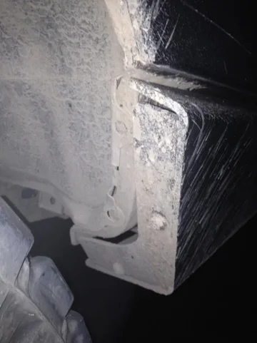

Bumper looks great !! Mine works very well towing and doing its job banging into tree stumps. My only wish is that the wing ends are capped. I am having a local guy fab some tabbed bolt in inserts to keep crap from getting up in the bumper.

You know... I used to not like the opening at the wing ends, but every time i'm out wheeling, i somehow seem to get a lot of mud in that area and when i go home to clean, i'm always glad that it's open. I will probably fab something somewhat flexible to put in that area though.
Mike can make them with end caps, I have them. They screw out so you can get in to tighten the other stuff of needed. I don't find it too hard to clean.
Do you have a picture of this?

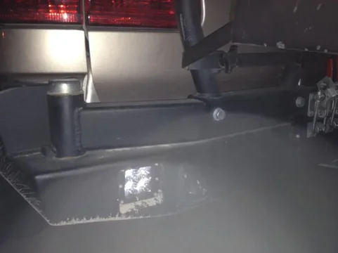

Not a very good photo, and the bumper is dirty, but it looks better in real life. I took this at night from my campsite, I'm in Ouray at the moment, or I would take better photos for you.
He also added Rigid LEDs for mine
