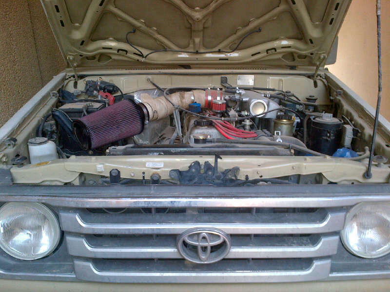

Hi there, I have a new cylinder head project. It is gonna be performance cams from CamTech and GTR valve springs and 3mm bigger intake and exhaust valves from Ferrea. Also, a Haltech Platinum Sprint 500 and a 3.5 inch throttle body.
The car already has these things: custom long tube headers and air filter intake. Boarding and polishing for the cylinder head and the intake manifold also 1mm over shaved the cylinder head. Centerforce clutch and over shaved 1mm to the flywheel, electric fan. this is day #1 some pics

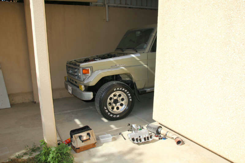

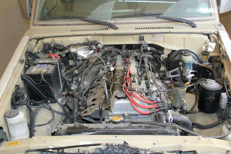

day#2
uninstalling the head it self was easy and fun, but the things around the head were difficult such as all the wiring and the intake manifold, header, etc. they pest me off Lol. here is some pics about what I have done.
ready to be taken to the machine shop
