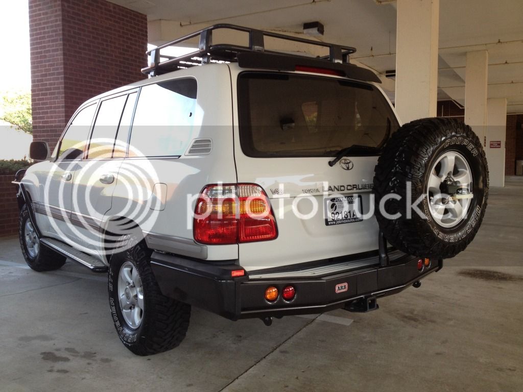

Here is a pic of my '98 white LC with right side carrier, not sure if it helps.
You will be pleased with the bumpers, I love my front and rear, they have saved me plenty of times.

I am trying to decide between no swings and single driver side swing. That pic helps, do you have any from the side showing rear tire and bumper?
The ones on the ARB side are poor, I think they should have pictures showing the different options.
