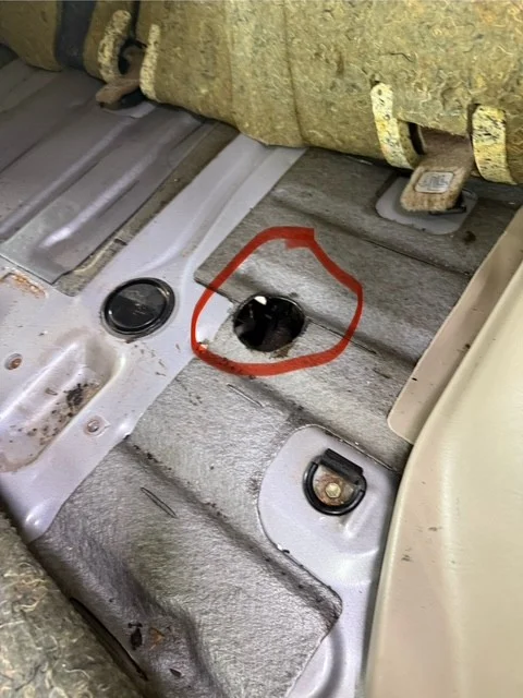

I just did mine 2001 (134,000) all around, together with sway bar links, control arm bushes, etc. The rear shocks were OEM from 24 years ago and completely rusted. Hard to get a wrench on up there and get any grunt on it. So, I used a 2 1/2" hole saw. Bought rubber plugs from Amazon to fill the holes. Worked just fine.
good idea. mine were hell to get broken loose. was rough to get that top bolt off with a ratcheting wrench.
