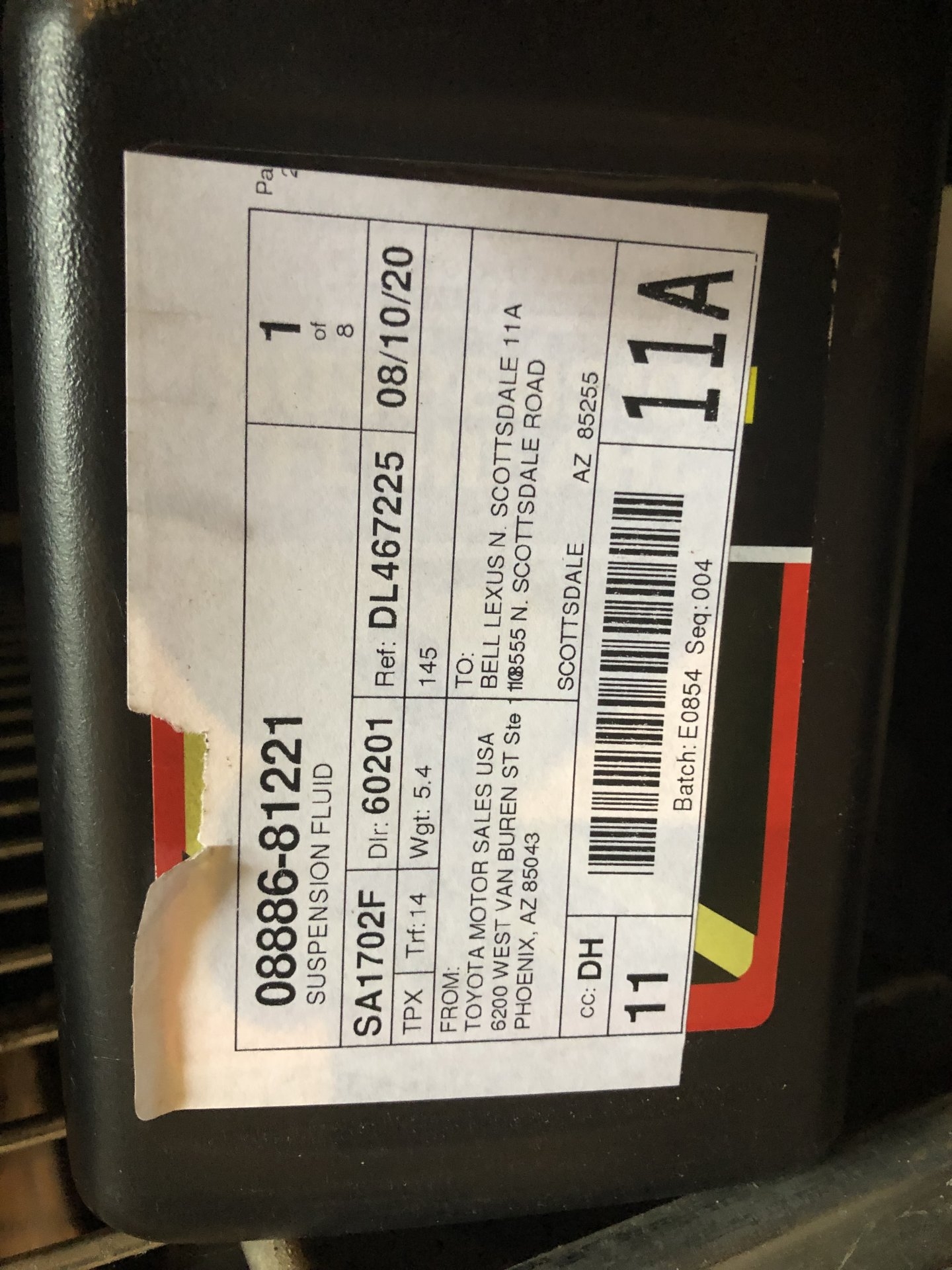

I posted this in another thread, but it would be interesting to see if Toyota dealerships have stopped selling their fluid as well. I think that would shed some light on whether there is actually something wrong with the fluid. If there is, historically speaking, what will the recourse be for people who ha e already purchased the fluid? Especially if you DIY’d some job that needed the tainted fluid to be added.
I replaced fluid last year.No issues.
I replaced my fluid a few months ago and then I replaced it again recently. No problems so far and everything works as it should.
So oddly enough, I actually gave the service advisor the part number for the Toyota fluid, as he was new and didn't seem to be an AHC expert unfortunately. The service director seemed to have all of the knowledge in the AHC realm and showed that the part number for Toyota was part of the no-go fluid.
So the New York batch is good.
Looks like the New York batch is good:cheers:

08886-81221 is now showing available on all the lexus dealerships and toyota dealership online.
The first time I did mine (a few months ago) I bought it from my local lexus dealership. This last time, I bought it from McGeorge toyota.
The service director is going to call me once they have a solution from Lexus of North America.
@CHAOTIC Any chance you heard back from the service director about a new part number? Trying to save myself from making a bunch of calls to figure out if I can use the fluid sitting on my shelf or not.
I had a small surgery and haven't had a chance to check back in. My plan was to wait until my 100K mile oil change service and just take it in at the end of August and see what they say. Depending on what part of the country you live in, it may have never been an issue for you. This may have only been a southeastern thing from the regional guy that froze it all. May not even have been fluid related, and more so an issue with a few techs who destroyed the AHC systems in the south and the regional Lexus service director just panicked.
Hope you're on the mend! I'm also in the southeast so trying to figure out if this is an actual issue or not.
Checked with a local dealer in NH and no current recall found in their system on 08886-81221. Planning to do this AHC fluid change soon and hoping my stock is good to use. Will report back if any issues encountered.
