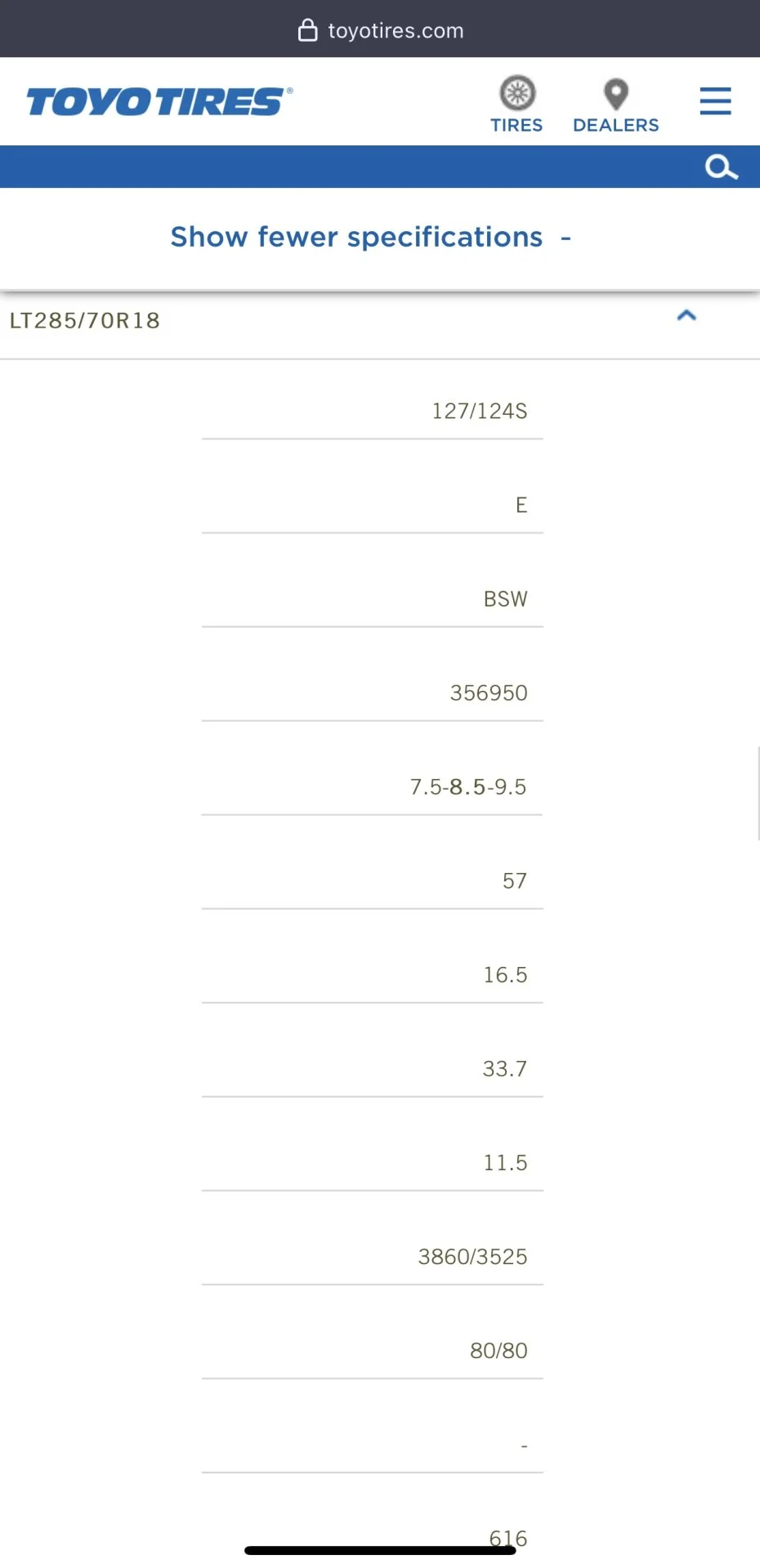

So I’m seeing this tire, LT 285/70R18 Toyo A/T3, listed on Toyo’s site but I’m not seeing any info on it anywhere. Is this tire being discontinued or is it new? I really want to go to 295/70R18’s but I’m a little concerned about them fitting. I was looking for a less aggressive 285/70R18 than what is available and came across this A/T3.

I just called Discount and they can get them. They show the tire as a new size for Toyo. Not necessarily talking you or myself out of 295’s but keep in mind the more width increases hydroplaning and lessor driving dynamics. They do look good though

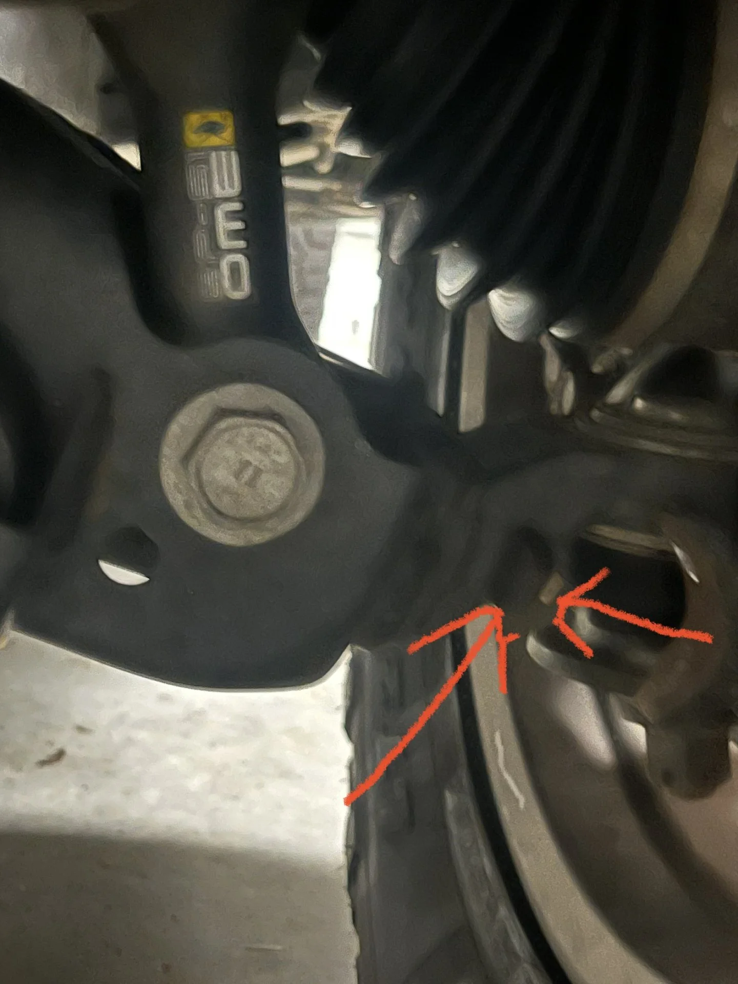

You can run defenders in that size, just need to have 1.25” spacers and 3/16-1/4” nut welded to the lower driver side A-arm where the steering stop touches
Sorry for dumb question, but is that to limit overall sweep of steering manually so they don't rub?
Correct. It’s simply to prevent your larger tire from rubbing or pushing against the drivers side KDSS bar when making a full wheel turn to the right. Simply put, if you need to make a hard right turn or similar to a tight u-turn for example, it will just have a little less turn radius. I’m going to grab some JB-weld epoxy and try this with a 1/4” nut and see how it effects my daily driving before I consider installing 295’s
