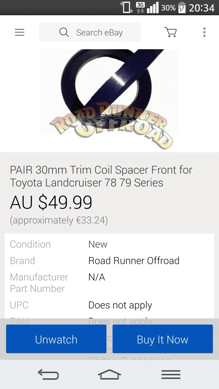

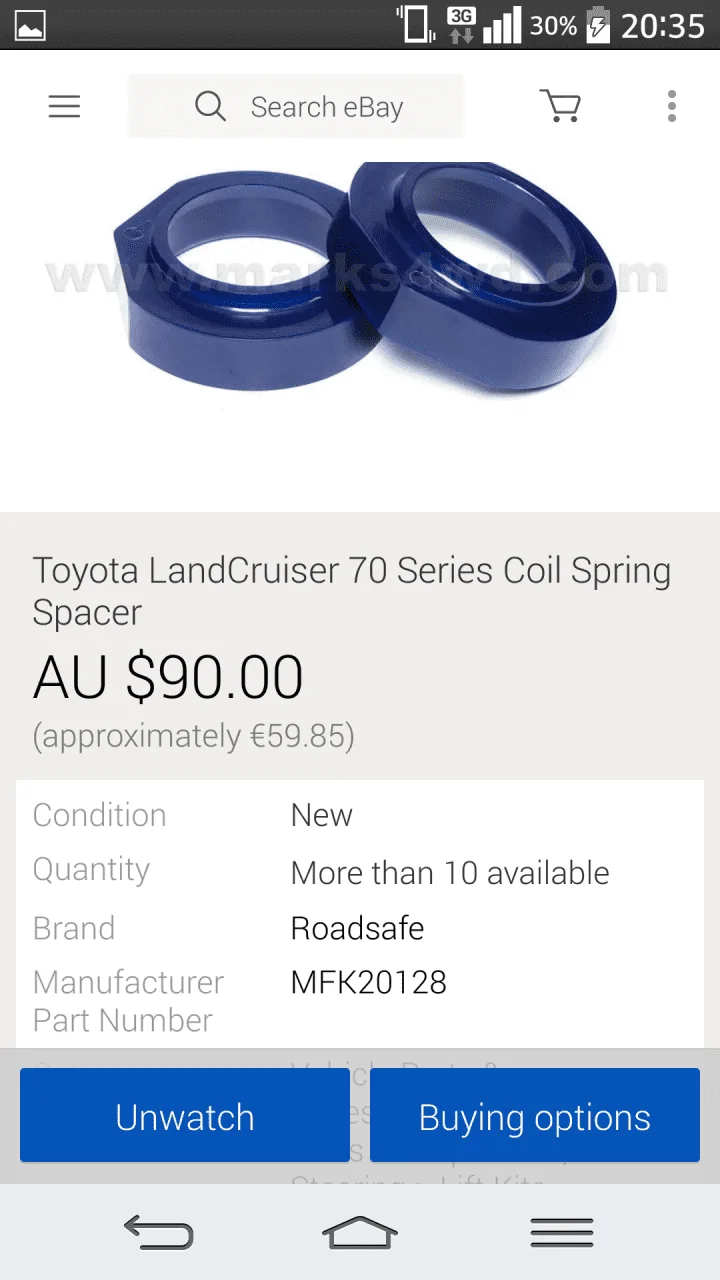

Will any of these fit? They say 78 model but they don't specify if it's for the heavy duty.. If I buy two pairs will they fit ok on all four corners?

These are the spacers I bought for the front: 2 Front Coil Spring 30mm Spacer Landcruiser 78 79 Series HZJ78 HZJ79 FZJ78 FZJ79
But even with the mediums you said is still too stiff, and I don't even have any accessories! I will get the nitrocharger sports, I was just wondering if I can install spacers on all four coils... If not I'll just put them on fronts and get the medium springs for the rears. Thanks for all the help!
