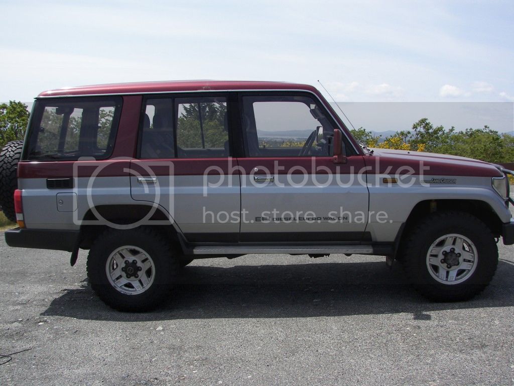

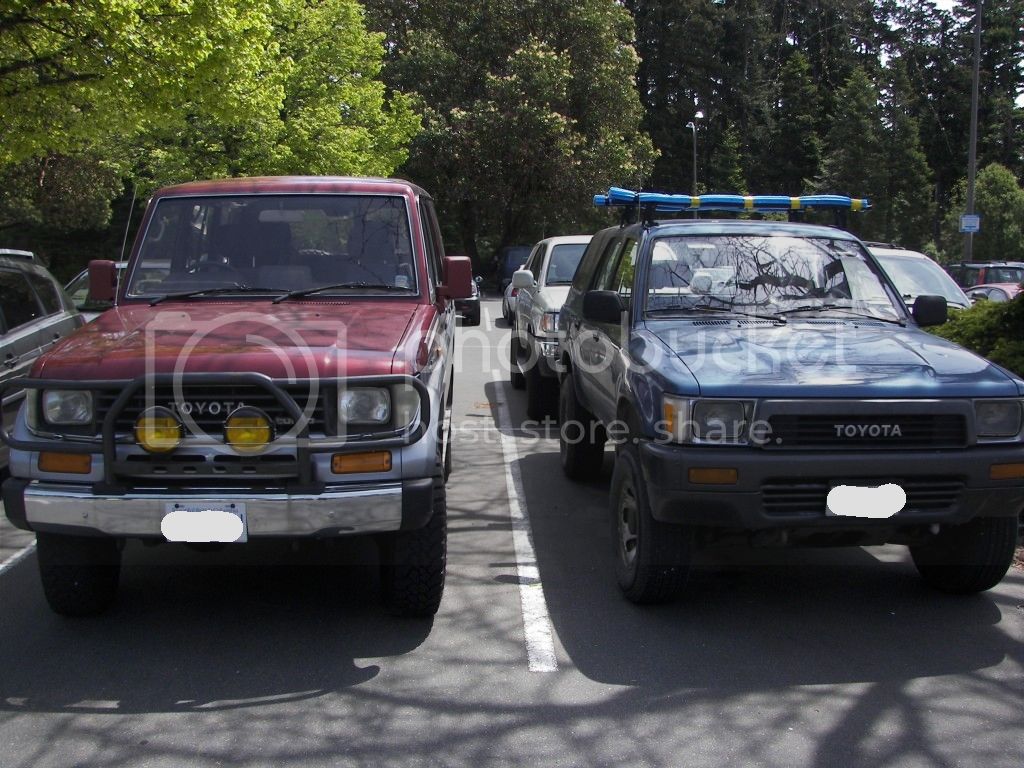

Well guys, here are a few pics of the truck with 235/85R16 tires and the OME medium lift:
Passenger Side:
Driver Side:
Next to a 4Runner:

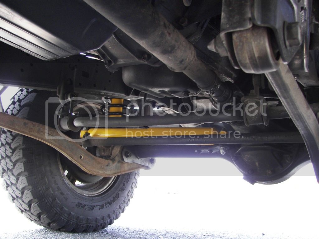

Steering Stabilizer:

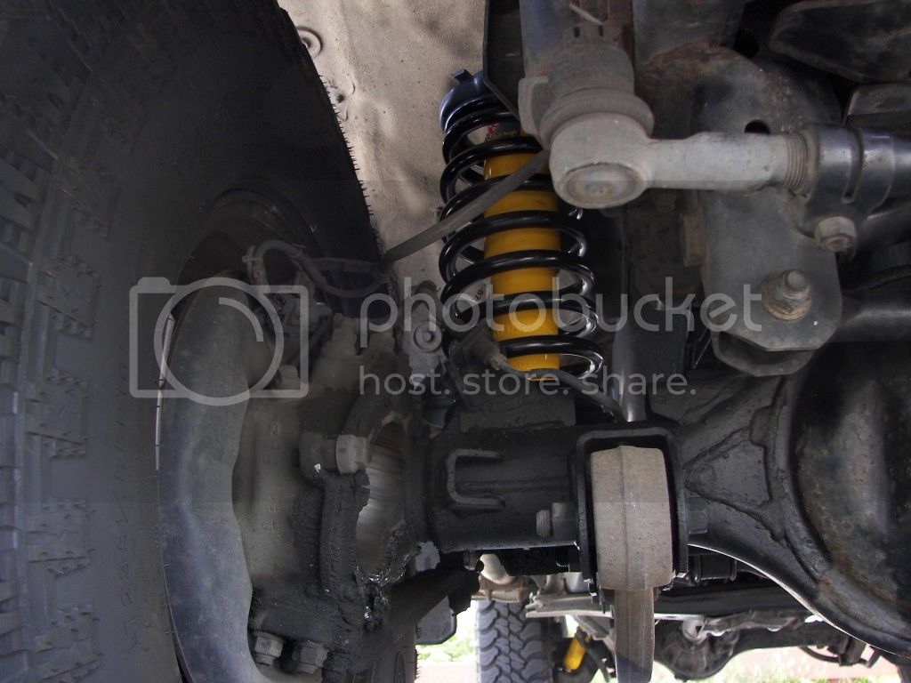

Back Suspension:
Front Suspension:
