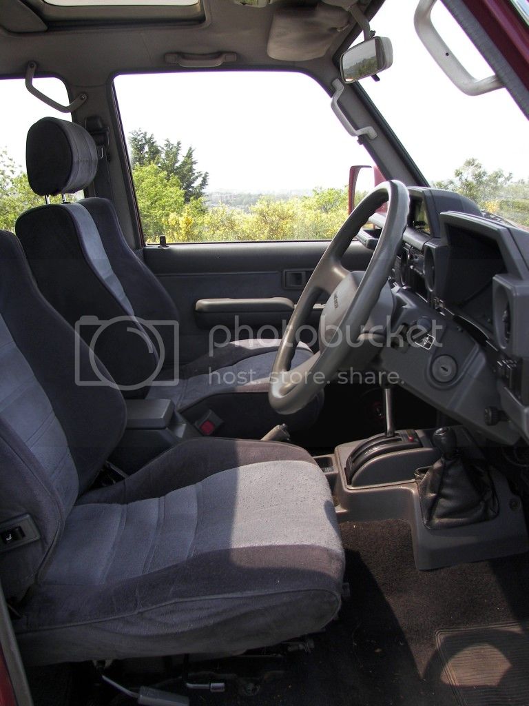

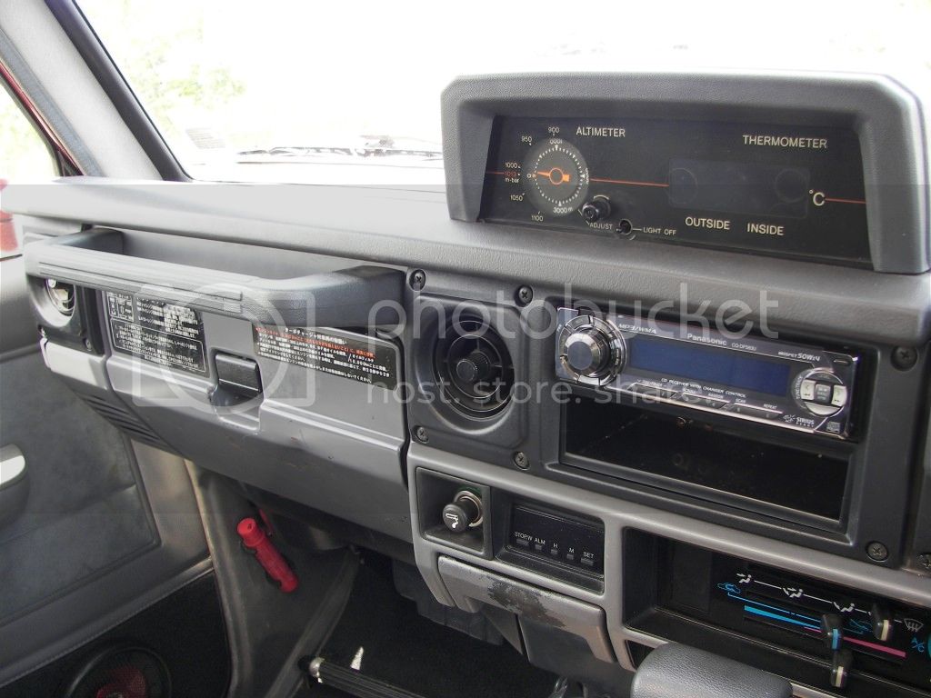

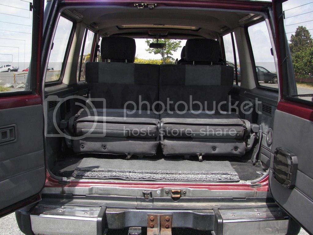

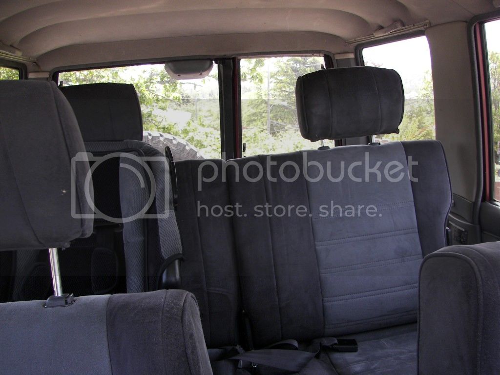

Surely a modern camera can take interior photos?:)
Subtle, haha! :) The interior in mine is nothing to write home about. The previous owners were very hard on it. However, it turned out that a local outfit (Rocky Mountain Imports) was parting out an LJ78. I was able to get a number of parts from them to fix up the broken/missing interior bits in mine. I'm still waiting on the factory front mats and a couple other minor things from them.

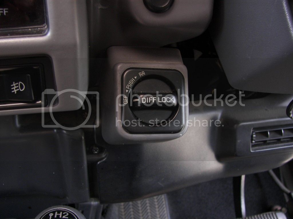

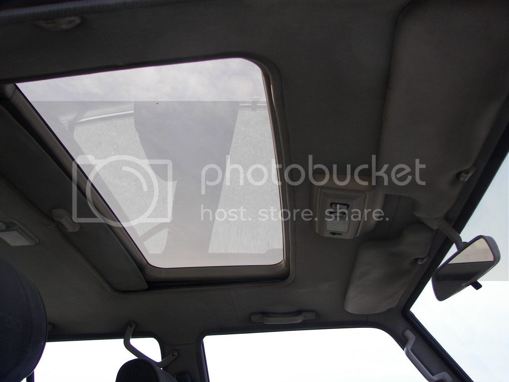

You must have the "deluxe" model. :) My LJ78 did not have diff. lock or the sun roof. I see you still have your factory flare in case you have to fight off a bear.

It's the EX5 model which I believe is the loaded version. Seems to have about everything except for a factory winch and the fender flares.
The diff lock was a must for me. I think I probably would have passed on the truck other wise. I will be using this truck in the back country, and it will be seeing some very rough terrain. As time and funds allow, it will be receiving other equipment such as a winch and custom bumpers, etc.

I believe the factory diff lock was an optional extra, just like the winch.
Interior looks to be in top condition.

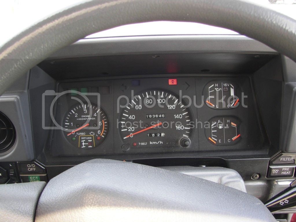

Rear diff is a result for a Japanese market 78, it was an optional extra and not a hugely popular one as there are very limited 'off-road' opportunities over there. I note you think it has 'lost' some mileage - if so its not likely to have been in Japan, they have the most stringent mileage checks I've ever come across.

I guess I got lucky with the rear diff lock option. For some reason I thought it was more common on the LJ78.
Interesting that you say they don't swap gauge clusters or roll the mileage back in Japan. I was under the impression from reading that I'd done that it was not that uncommon. Well, you've instilled some faith in me that maybe my truck does only have ~165,000kms or so. Maybe it just had a lot of hours put on it in Japan, but not many kms.
