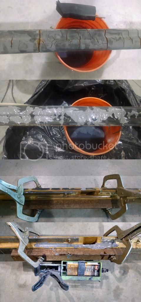

Repair tactics as requested, first picture shows my two piece dash that was almost a three piece dash anyway I set out to just glue it back together as I already have a plastic dash cap, if you look close at the side part you can see the ¼” rod I used to stiffen up the repair. Second picture shows that I decided to fill the cracks while I was gluing the major sections, I sanded everything with an orbital and 50 grit prior to gluing. Third and fourth picture shows another repair on the back side, the dash has some steel inserts that I ground a ¼” slot into then set a bar in place to join the two halves.
I used some SEM 39387 self-leveling seam sealer that I had left over from my rain gutter that seems to be very sticky and stay flexible, I was able to sand it smooth and think I’m going to try to spray some of the Noxyde coating on to see what happens and if it looks good I’ll toss the plastic cap in the trash. If not I’ll just cover it up.
This was more of an experiment using stuff I had laying around and not one minute of research was spent so I have no idea if any of it will work but it looks good so far and I’ll post a picture when it’s done.
Looking good J Mack!
That self-leveling sealant looks like a great option since it is sandable. I considered metal splints in the backside of my dash, but decided the glass would be enough.
