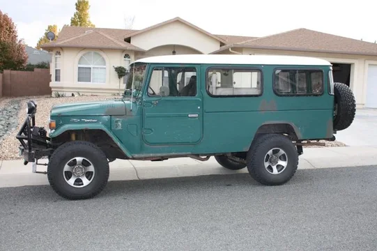

Since I am stuck around the house I decided to attack the Troopie and put some shackles on it and remove 4 leafs from each side in the rear. Rides like a haywagon with that 9 leaf pack 3 of which are 1/2 inch overloads. It came out even and lifted about 2 inchs. I used 4 degree shims in the front and it seems to be doing all right.

Okay everything not perfect. I have a vibration in the rear between 90-100Km. I figure maybe need to shim rear pinion to since I changed the angle some. All opinions welcome. I don't want to tear it apart again until I am fairly sure what the prob is.
Thanks for your time.
My first test is to grease the u-joints. If the noise is less or gone the problem is found, if it makes no difference, it is likely something else.
Driveline yoke, u-joints all new?
Not new, but in fine shape and greased. It just started after the the suspension mod. I wouldn't think a drive shaft that long would be so sensitive to a slight variation. The diff. is turned up slightly and other than that I don't know what would be different. The vibration is pretty bad, but you would know it was there until 90Km and then it feels like a shiatsu chair.
I'd get under there and horse up and down on the rear shaft just to totally eliminate any question there. Changing the angle on the diff may find a sloppy spot in the slip yoke that may not have exhisted at the old angle. (Double check that it is not bottomed out as well).:meh:
If not, it wouldn't hurt to give Mark a call.
Western Differential
Howdy! You may need to add a 2 or 3 degree shim to the rear also. Ideally, you want the pinion shaft to be parallel with the transfer case output shaft, plus or minus a degree or two. John
