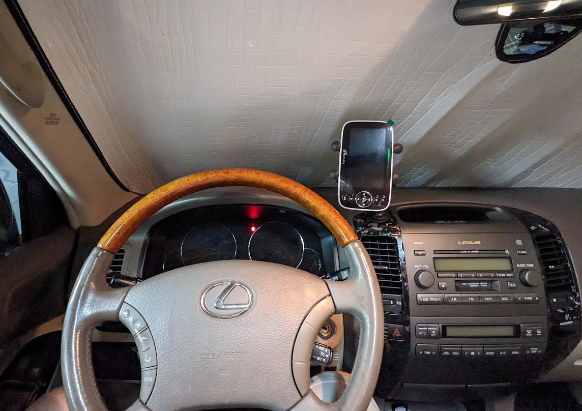

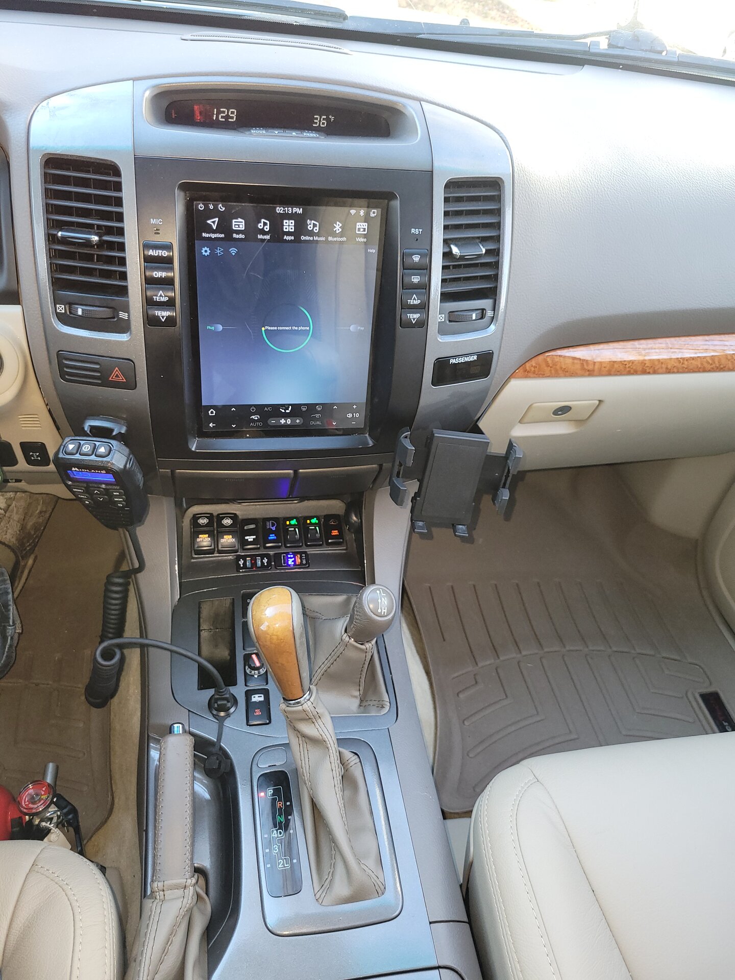

Wow. This is really solid and looks amazing, also really cool mods you have on the auxiliary buttons. Are those Blue Dog (Wonder if he is on this website, I was looking at those prints recently)? I'd love a run down of what each of those is up to.
My issue on Phoenix is if I convert any physical buttons to virtual, I feel like it needs to be bulletproof like work perfectly to not feel like I'm at risk of losing some really nice comforts lol (I live in AZ, I have everything from 120 degree heat to feet worth of snow up north).
Also side note I'd be curious what that phone mount is (almost looks mounted into glove box?)
This is how I decided to do my phone mount (more pics and amazon links in my post here, more pics a few posts further down in my thread):
It gets crazy hot and cold here too and my Phoenix works just fine :). Fired right up at -3F this past weekend and has gotten hot as well. In a perfect world the non-nav conversion and a generic Android head unit that retains the stock A/C controls is the best way to go. I probably would have actually done that if my GX did not have the PX6 in it when I bought it. Unfortunately, the PX6 is really the only plug-and-play option for the nav-equipped GXs that I'm aware of, since the HVAC and infotainment are integrated. Lots of folks have done the non-nav conversion though.
The prints are Blue Dog. They did not come out perfect and there was a fair amount of fitting to get everything right - but more on me with trying to fit too many buttons in a small space and adding other items like the center-located GMRS external speaker (which vastly complicated things :). If i had to do it again I'd just get the Blue Dog transfer case switch surround with a Switch Pro mount to run accessories, which would have been a lot easier.
The phone holder is a Panavise - their website is pretty old so I called them to order. They are great and I've had them on other vehicles too. You need both the vehicle-specific bracket an the generic AMPS mount for the phone.
