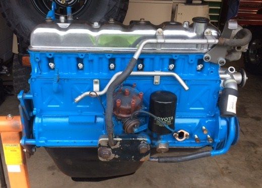

Got some more work done. Bolted on the oil pan using an OEM (the best) gasket, also bolted on the manifolds again using a Toyota gasket. Got their polished valve cover on the engine, too. Hoping tomorrow to get the engine off the stand and then replace the rear main (another OEM part) and pilot bearing, then I can bolt on the bellhousing (already pained), flywheel and clutch assembly. At that point the engine will be ready for installation. I'm gonna wait till Jim and Zach can get here to help with the install- always better to have another set of hands and eyes for shoehorning a 2F into a truck with the transmission still sitting under the truck.
I also have to remove the stock distributor they want the pointless distributor and wires from the old engine. it worked great so i'm fine with that.
