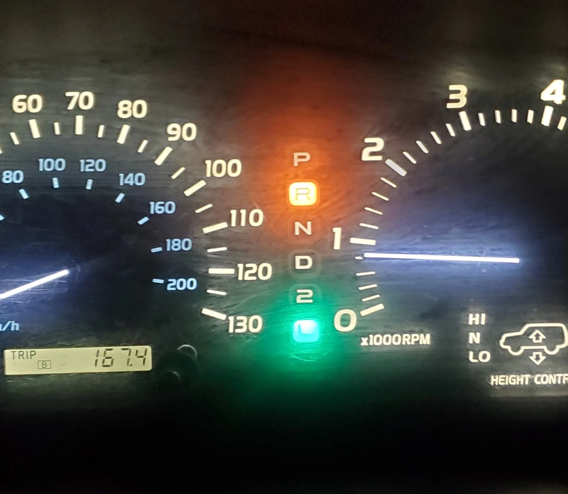

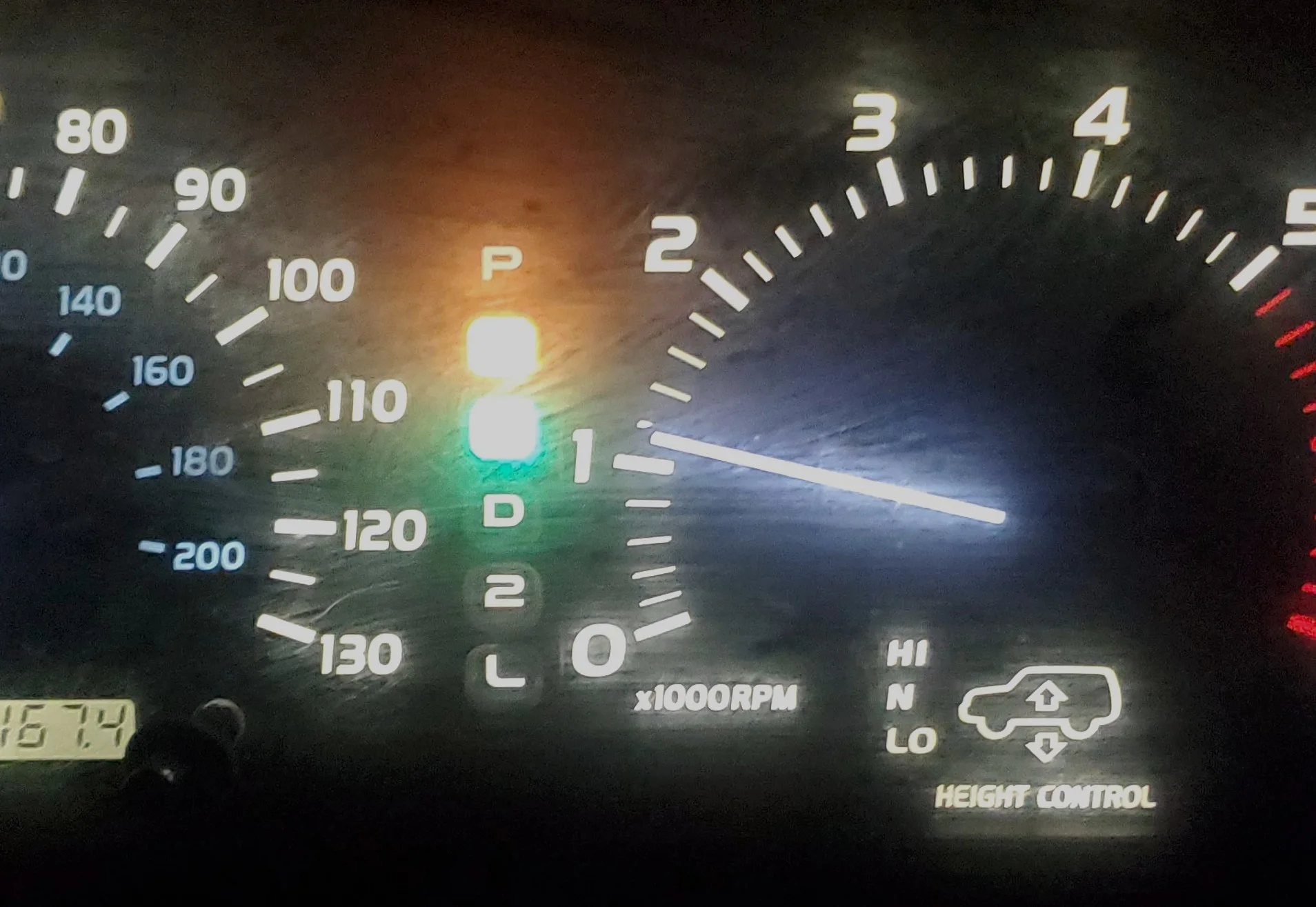

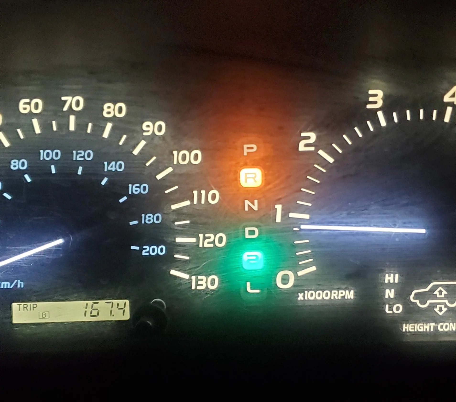

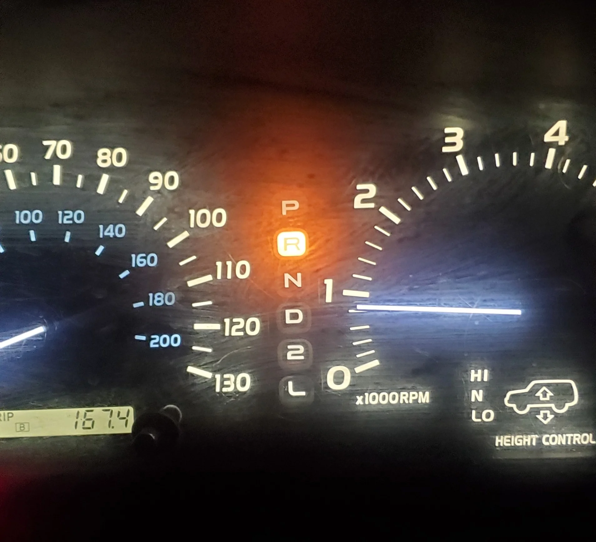

Yesterday, as I pulled up to the house, I noticed my Reverse light came on while I was still in Drive. Checked it a couple of times and it went out. Hmmm.
This morning, it happened again, but didn't go out.
Time to start testing.
In Neutral:
In 2nd:
In L:
It moved the directions I expected it move, meaning there's a switch issue. It was still dark outside, so I headed off to the office.
Every time I press the brake pedal, guess what lights up?
Yep, the Reverse light (of course my D is out)
So, now I get to start chasing gremlins.
I'm guessing it's in the transmission safety switch?
Any thoughts?

What year and which transmission?
Rainy season where you are? If so, then water intrusion will cause all gremlins to reproduce.. (Or was it eating after midnight?)
My gremlins are full blown this season.
Pinched/broken wiring at rear lower tailgate hinge? I got lucky and mine just cleanly broke, but there is certainly potential in this area for bridging and/or grounding.
Not really the "wet" season, but it's certainly the HUMID season.
I wondered about the tailgate and will check it out this weekend.
