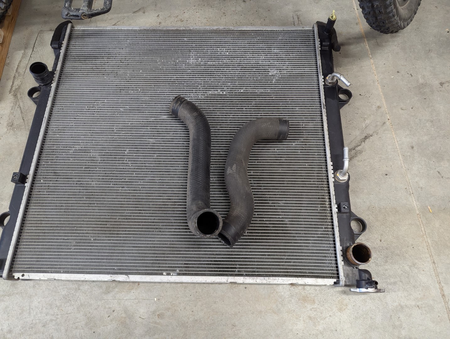

Just finished a radiator swap. Original OEM lasted 13 years and 250k miles and still hadn't failed.
Ordered OEM 16400-38290 and both hoses 16571-38101 and 16572-38151. Total was $300 from Bell Lexus during one of their sales (they're great)!
The new radiator also says Toyota Japan on it. I read Denso moved production to Taiwan so they either installed the foam in Japan or it is still made there. the fin structure is slightly different.
Took about 4 hours to replace. Bit of work taking out the fan, shroud, grille, and the wings to access the bolts. I really wish they bolted it in from the back side to nuts on the core support. And the lower clamp, wow that was some work. Wish I had cable operated clamp pliers.
One clue there may be a problem was the upper tension clamp being replaced with a worm clamp.
Turns out the upper fitting near the cap was very brittle and discolored. Glad I replaced it! Other than that corner it looked great, no leaks or sign of damage.
I pressure washed the AC condenser while I was in there. Highly recommended, there was so much dirt, hair, feathers, bugs, in both the condenser and radiator and between them. Surely has to be reducing the cooling performance!
