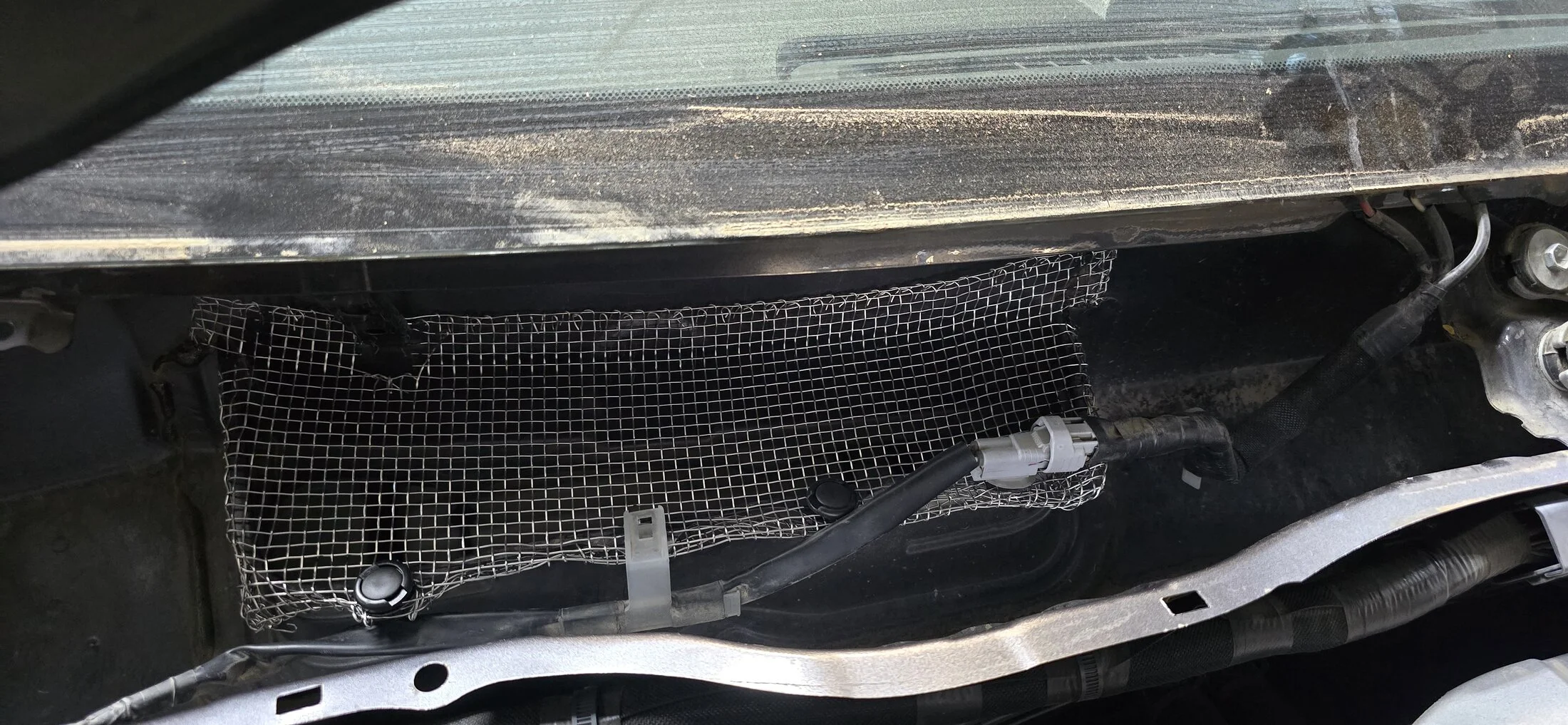

Probably 2 hours for the cabin air intake and 1 for the engine air intake. Took some time making templates for both. I’d say a double banana job just because of the cowl removal.
Just had my first go at this after 7 years of ownership. Got in truck for first time in 2 weeks after camping trip and wife about died as there was a dead baby mouse wedged in the passenger door jamb. Nest discovered in cabin air filter. Truck stinks to bloody hell. Currently exploding an auto odor eliminating fogger in truck. Headed out in the morning for a quick weekend trip no time to make the inlet screen yet.

You probably already got this worked out, but it’s pretty easy. Pull the windshield wiper arms, then if you have them the two plastic trim pieces along the fenders, by sliding them towards the front. They are held on by 3 clips each (this is on a LX, not 100% sure LCs have them.). This uncovers 2 Phillips head center pop clips (one on each side). Remove those and disconnect the washer fluid line on drivers side. Then the whole thing slides off the windshield towards the front. It can take a pretty good tug. Getting it back on is the part where you want to be mindful of breaking clips. Also make sure you get a good seal on the passenger side on reinstall. Easy to create a water ingress point into the hvac inlet assuming the Cowl cover design hasnt been improved from older models.

Just got around to getting this done today. Thanks for the tips on cowl removal. Hopefully i got it back on good enough. I doused it pretty good with the garden hose to ops check it after and didn't see any water inside anywhere so I called it good enough.
The only thing I would do differently (other than do the mod before the first dead mouse appearance...) is pay more attention when amazon ordering the hardware cloth. I got woven instead of welded hardware cloth and it made cutting and shaping it much more of a PITA.
