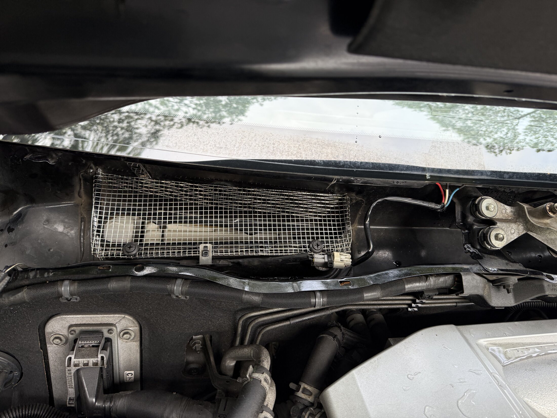

I just switched out my cabin air filter after neglecting it for 30k miles, and found the exact same scene.
Is there any way this isn't a nest? I'm in Phoenix and have never had mice or rat issues. Thought maybe I'd had the filter installed upside down and this was some weird byproduct of that.
I just took off the windshield cowling to look from above… nothing. I’ll probably zip tie some hardware cloth above it just to be safe.
Thanks to all who posted, finally got fed up with the nest every year…made one for the air intake as well!
Couple more shots…
Had to do the same for the GFs Honda CRV last week
It's pretty darned annoying that manufacturers haven't realized this is a problem, and done something similar at the factory.
My mistake was assuming that the mouse had left the vehicle when I installed the screen. Turns out I also made it impossible for him to leave. Fresh turds on the dash the next morning. Had to set traps inside to get rid of it.
Looks good, I like that screen material too. Where did you source that from?
Link to what I bought
1/4" hardware cloth
