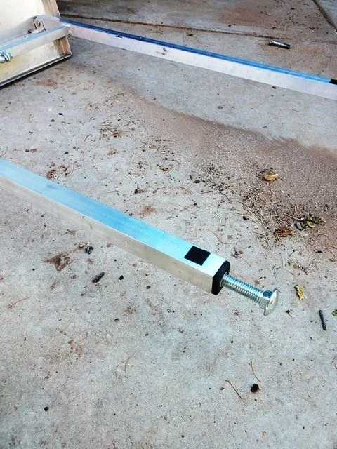

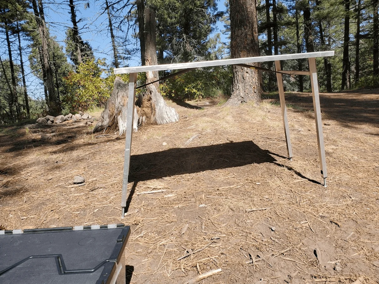

I made this table that has long bolts for making it level on uneven terrain. I'm looking for something different for quicker leveling and was wondering if I can slide in another sq tubing inside the current 1x1 sq tubing. Then I can use use a rivnut and a bolt for tightening the inner sq tube to the outer sq tube much faster than tightening/loosening a long arese bolt! I'm open to any other elegant way to do this as long as it fits inside a 1x1 sq tubing.

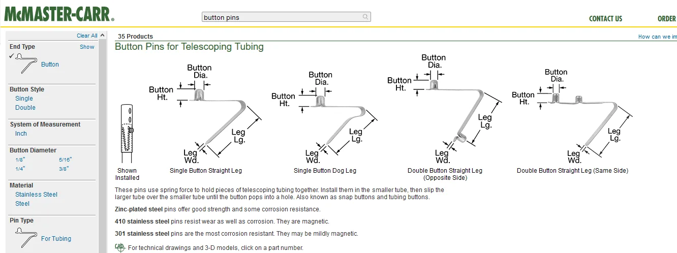

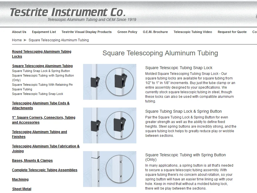

here is potentially another option, depending how thick your tubing is:
