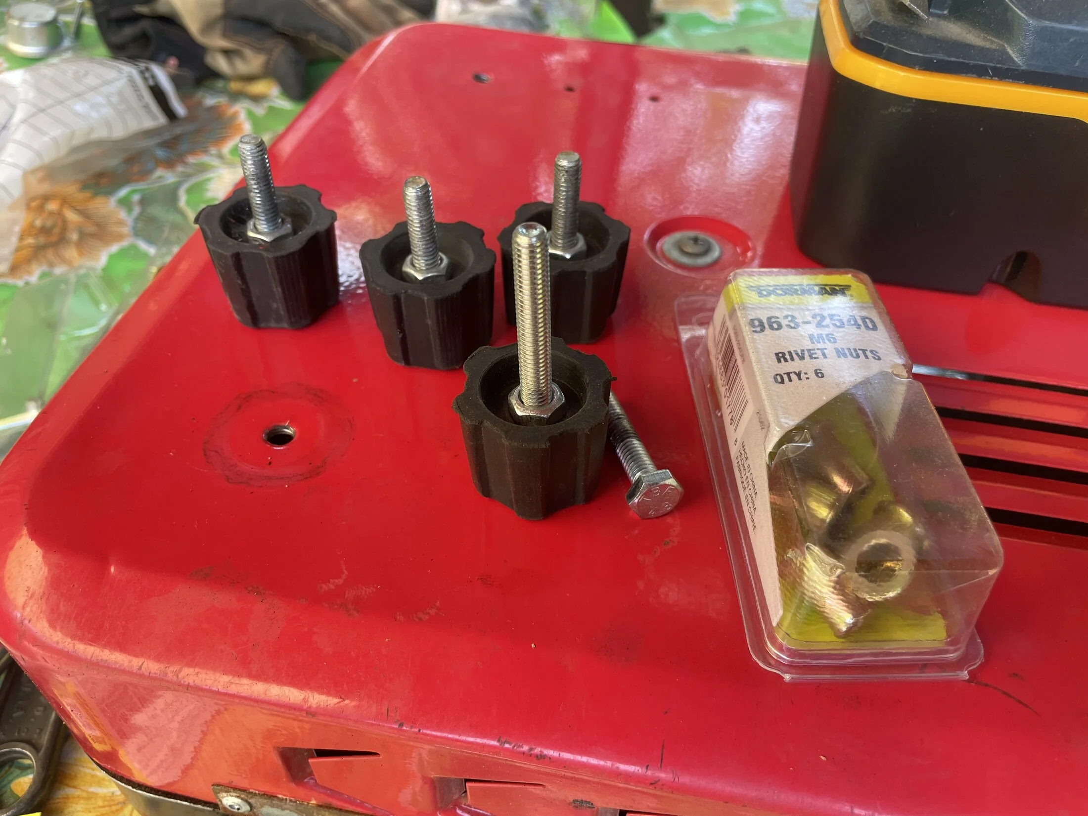

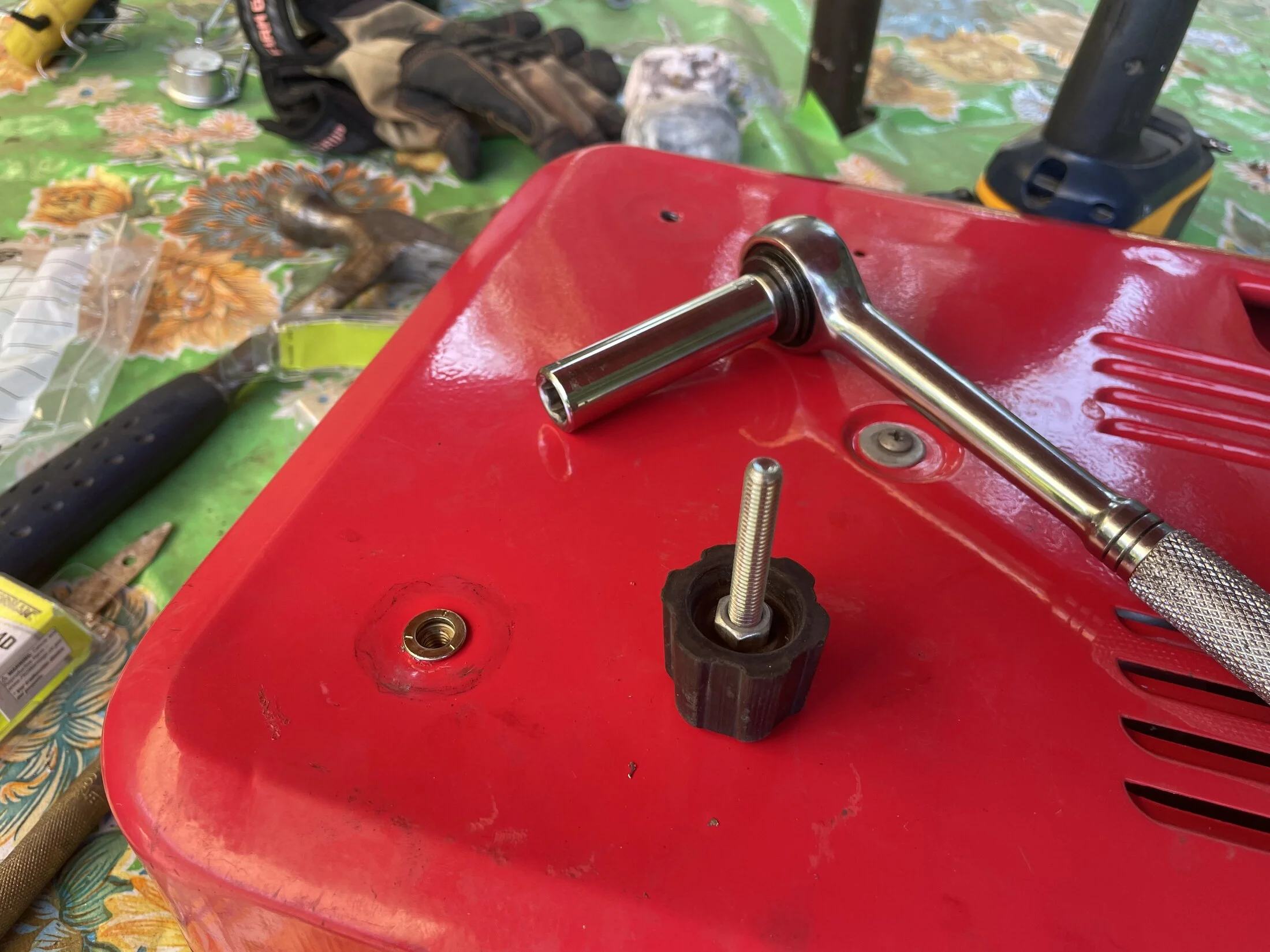

I love this stove. Blast furnace heat, nice low heat control…
But the stupid stamped steel threaded little feet levelers on the base of the thing SUCK. They strip out really easily. I’ve always had handy rocks or sticks around, but…
I have the Everest model and I love it with some tweaks of course!
